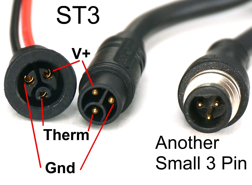

I cannot believe i cannot buy or properly fabricate a charger for my Aventon Aventure ebike- It has been sitting for over a month now and I've ordered over $200 worth of various connectors (closest being the $100 charger with the "ST3") connector from Grin, it did not work at all. I will pay top dollar but Aventon offers NO HELP AT ALL! If anyone out there has ANY suggestions for me - I would be soo grateful!

You can use this $13 ST3 to XLR adapter from Grin:
Either cut the ST3 connector off and solder to your charger cable or use an XLR connector on your charger cable and use the adapter as is.
I have that exact adapter you reference from Grin. I thought it would fit the Aventure battery socket, but it didn't. I could cut off the plug from the Aventure charger, cut off the Grin XLR ST3 plug, and then solder the Aventure plug to the XLR connector if I knew exactly which pins were positive, negative and sensing. I have this question posted elsewhere in response to someone who said they did this but didn't indicate the pin configuration (Charging Connector for Aventure?). Does anyone know what the configuration is?

The reason it's so crazy - is that Aventon went with such a nightmare proprietary connector on there number 1 selling ebike and have 8 other models that all have barrel connectors???? Grin is selling ST3 connectors (That look like the aventon aventure but are NOT) I LOVE Justin and the whole crew bat grin -but they need to get a stock of the right plugs and sell the shite out of them! I've bought 3 different variables from them and they are totally different - Like I said in the title - "its madness" Aventon is like self sabotaging themselves soooo bad - the worst business ethic ever! I
it does not work
it does not work
Thanks for digging into this, Daveo111. I don't blame you for dumping Aventon. Dealing with them has always been frustrating, infuriating. Shortly after buying the Aventure in May of 2021, I contacted them by phone (when you could still do this) and asked if I could have a failed charger for the Aventure so I could use the connector. They flatly refused. The Aventure is now a dead end bike in my view. Aventon has no chargers, batteries, or brake pads for the Aventure and we are held hostage by them because they didn't plan ahead and because they use a proprietary connector. Customers are at their mercy and they don't care.
Regarding your plan to 'cannabalize' the bike and install a barrel connector, does this mean you are planning to install a different socket on the battery that will accept the barrel type? I considered using a socket and ST3 from Grin but don't have experience doing such. If you do change the battery socket and connector, please contact me via email on this site or post how this was done. I would love to do the same if it works without the sensing terminal missing from the barrel connector.

No - at least for me , the grin ST3 did not work - the plugs were completly different (look similar) but I bought three sets of male and female and not one was right - there is an evils repair shop I’m going to try in San Jose ca - he is going to attempt to instal a new socket and connector - but I’m waiting on the Avento Key now - that is also six months out!

Why don't u just replace the ebike charging cable connector and install WHAT u need for ur charger !
u could prob. fit an XLR 3 pin and then just connect it to the battery.
Because Christmas only knows what the battery management board inside the pack is expecting for the data protocol on the sense wire. Setting ground or hot doesn't seem to be an override, and it doesn't seem compatible with other 3 wire chargers.
I've connected my oscilloscope and what I'm seeing is gibberish. Half tempted to add a secondary connector with a known BMS in parallel. Though since the batteries AND chargers are potted (boo, hiss) Good luck with that too.
