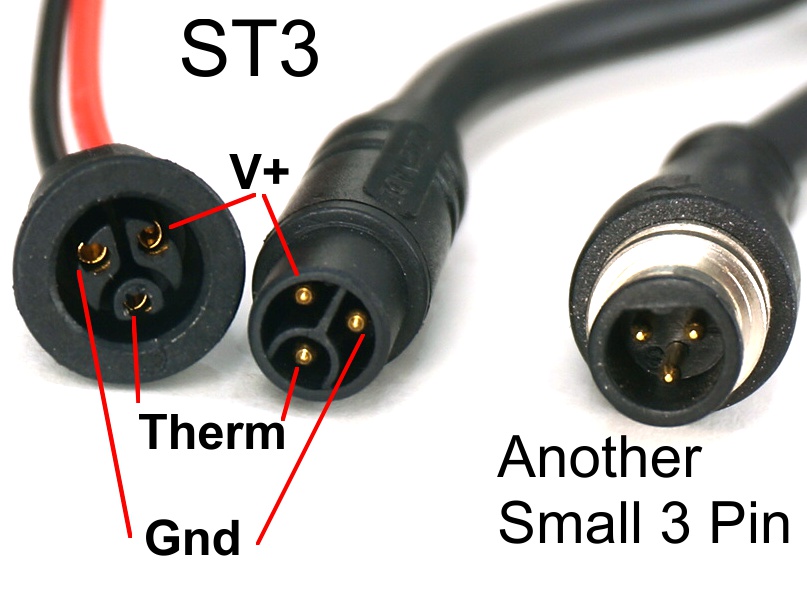

I have good luck searching by image trying to find new to me connectors. Grin shows “another 3 pin”. It sounds like it came from a former supplier. It doesn’t seem correct either. I’ve also spent time on the large electrinics suppliers pages and found oddballs there. An exhausting project but I just don buy they had a custom connector made . Perhaps obscure but not custom.

So Aventon has the Aventure charger in stock? Their parts page shows the Aventure charger is available, but the picture shows a charger with a barrel connector that I believe is for the Level. I sent an email 2-3 weeks ago asking for clarification before ordering but they haven't replied. I too have searched for the unusual connector but have not found that exact one. Yes, perhaps the connector isn't custom but obscure it seems to be!

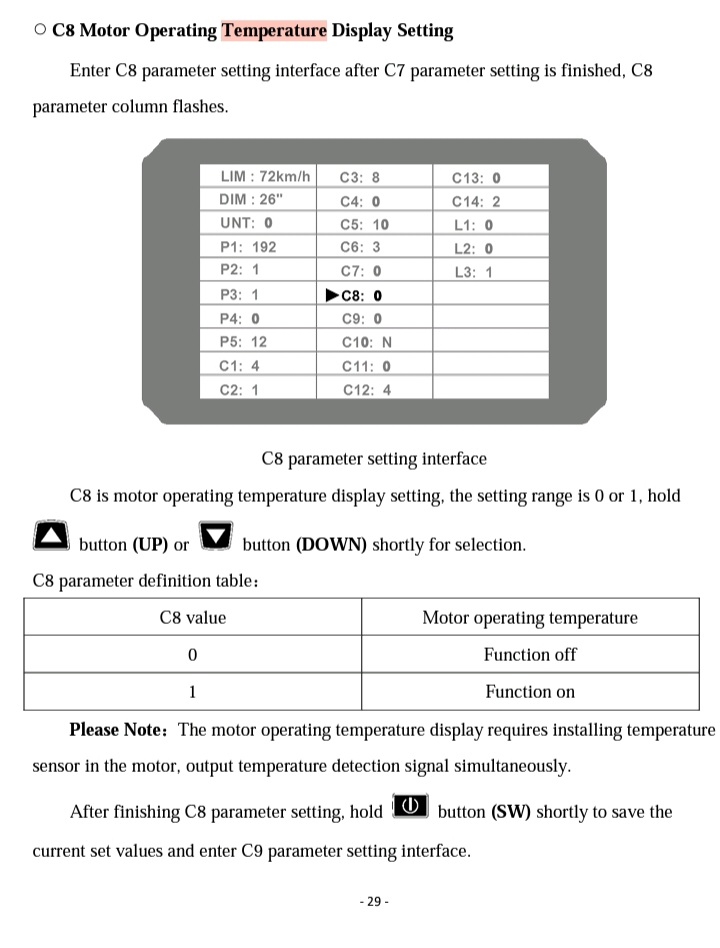

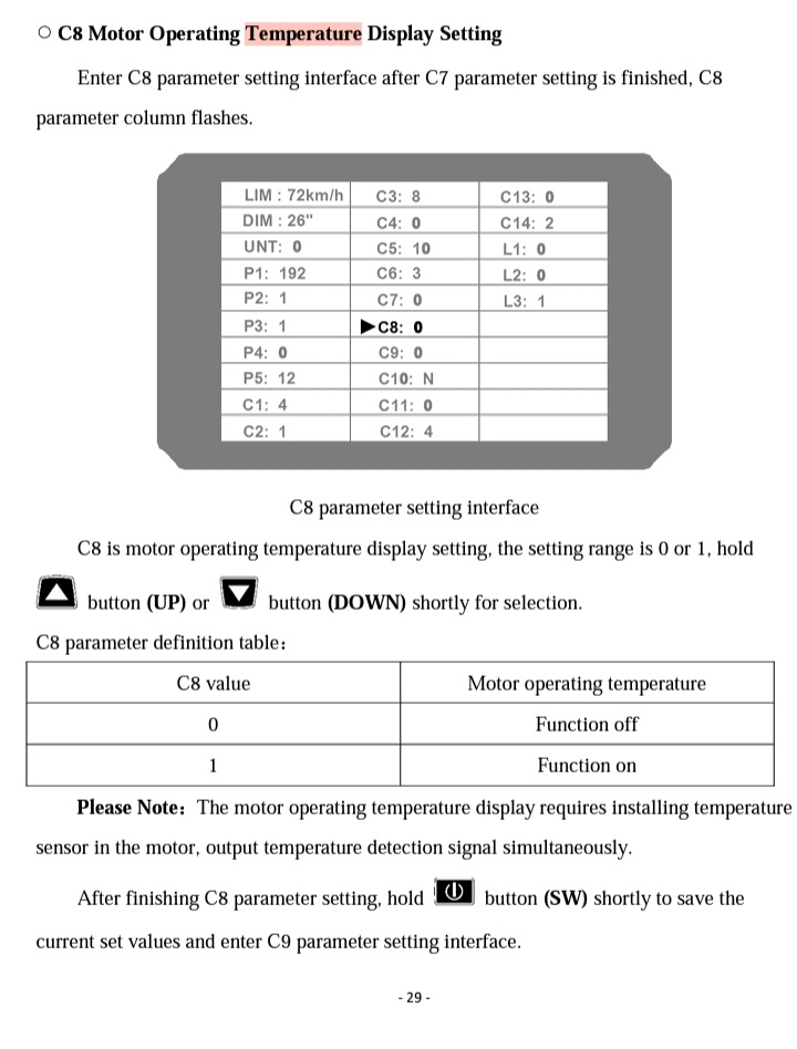

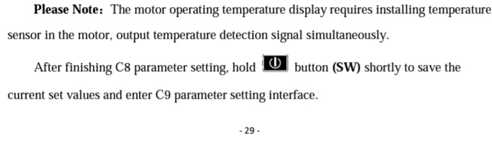

The only thing I can think of that might be #10 would be an internal temp - and you can survive just fine without that. The KT controller has no use for it.
Actually the KT controller/display will show motor temperature if your motor has a temperature sensor.
It shows the environment temperature otherwise.
Been down this road, you'll have to trust me. The display is able to display a temp, but that doesn't mean there is any support for it to get a signal anywhere else in the system. From the wiring coming from the motor, to the circuits in the controller, there is NO motor temp support. But don't take my word for it, I'd love to be proven wrong....
Been down this road, you'll have to trust me. The display is able to display a temp, but that doesn't mean there is any support for it to get a signal anywhere else in the system. From the wiring coming from the motor, to the circuits in the controller, there is NO motor temp support. But don't take my word for it, I'd love to be proven wrong....go for it!
No, I don't want to install a temperature sensor and a 10 pin motor controller cable.

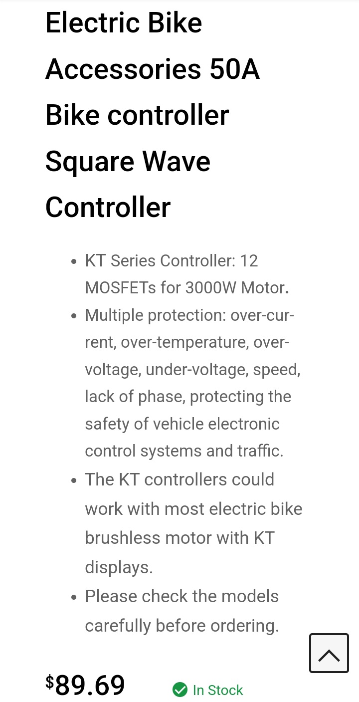

And as you say I may need to find a kt controller that supports the function, to get the info from the motor to the display.
Perhaps the KT 35 amp controller has the support?

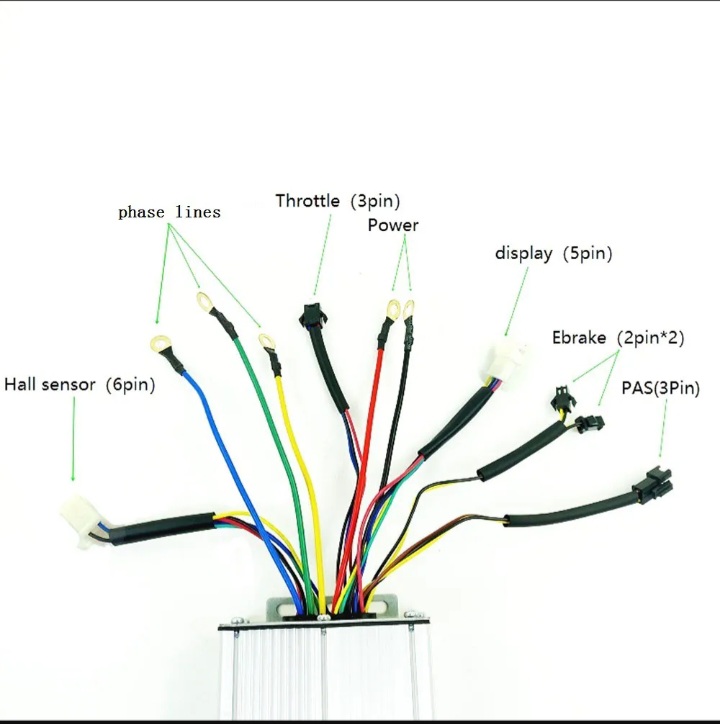

Last time -
3 hall sensors
Positive
Negative
SPEED SENSOR
Last time -
3 hall sensors
Positive
Negative
SPEED SENSOR
OK,..
I guess the over temperature protection is for the controller itself and not the motor?
But why would the display, that can only talk to a KT controller, have the functionality to read motor temperature if no KT controller supports a motor temperature sensor?
I can't speak to KT directly but MANY of the APT-made Bafang displays have features in the on-screen menu that aren't actually available. I wouldn't be surprised if KT also has different firmware versions using the same display. Why APT and others do that is beyond my pay grade. ;) If the motor doesn't have a sensor there's no need for an active firmware version reading motor temp. LOTS of motors have no temp monitoring.

Not a good option. In series doubles the voltage. In parallel is fraught with issues. See the thread here on EBR discussing Meanwell power supplies as chargers. If @Stick369 is correct you just need to find the Higo connector he posted.
If anyone is still looking. The connector on the battery is HiGo. https://www.higoconnector.com/products/z311ag-p-00-fj-1000/tv99K#title If you can find the right charger, you should be able to splice on the connector and poof Bobs your uncle.
I’m interested in running down this charger connector. Would someone please post a confirmation picture?
Here's a link to the Higo Z311A product description webpage with specs. It may be of help:
I can't find anyone in the US who sells them though. Contacting Higo directly or A&C Solutions in Belgium is a possibility but it would most certainly involve a quantity purchase.
Yup, tried that years ago for some adapters to use the Grin programming cable with Higo. A fellow in DE was selling Higo adapters and connectors but $20 part and $20 shipping…
