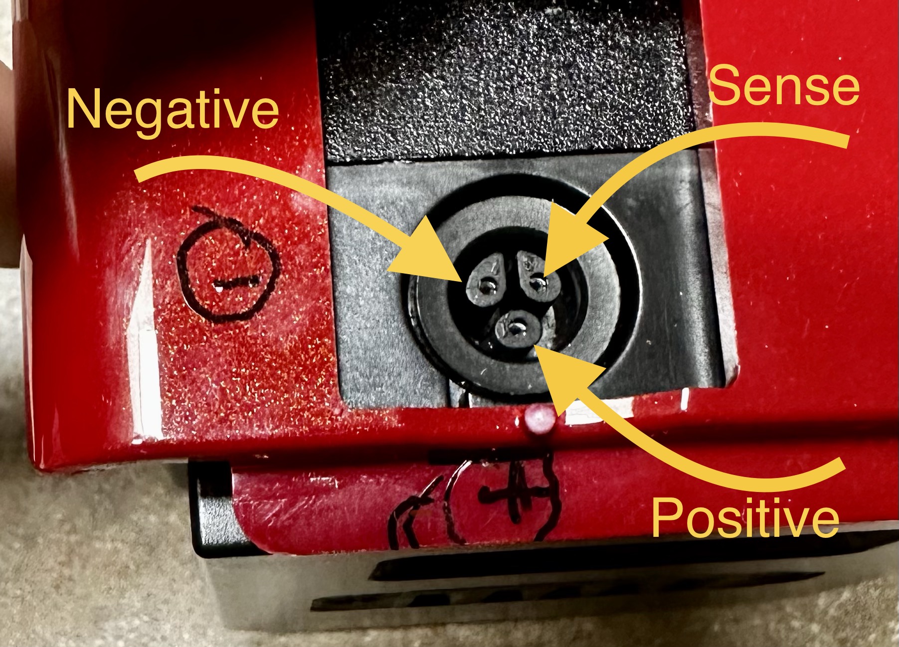

This is the pin-out for the Aventon Aventure battery charging port. The sense wire measured 2.44v; not sure how it is used.

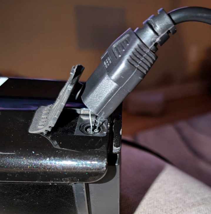

However, connecting the Grin Satiator charger to the positive and negative then holding the Satiator’s button to Force charging works perfectly fine. For testing I used alligator jumper wires to paper clips that were inserted into the charging port terminals and it charged perfectly. In the future I will probable chop off the connector from the Aventon charger and terminate it with male and female automotive weatherproof quick connectors so I can plug it into either the Satiator or Aventon charger.

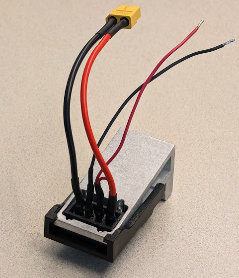

all u need is a short piece like 8-20cm of the. CABLE THAT GOES TO THE Battery ; After that is obtained from the bad charger , the rest is easy.. source a proper cable with whatever end con. you want and connect the other part of it to the short cable(+|+, -/-). They have no smart bms this cheap ebikes , all u need are the -/+ wires.

I have a Level v1 and Aventure v1. I live in WI and ride all year. Some salt water got into my Level from going through winter road water, and the contacts corroded in the frame, like it would for any “fake” sealed enclosure. The resistance caused the terminals to heat and melt. The issue is all over the internet, and not uncommon. I could not find the end cap for the battery anywhere, not on Aliexpress, not anywhere. (I do lots of hobby electrical). I contacted them, they would sell me a battery and “new” pins for $400, a steal. It’s a $4 connector. Forget that, I popped the top off and made everything XT60 and waterproofed it. I can’t take the battery out, but there was nothing wrong but their shotty engineering (have a story about the frame charger).

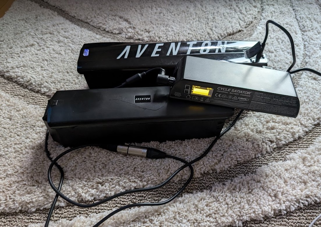

Attached photos are a Satiator, from a REAL company people should support, Grin, charging a stupid Aventure battery with an unnecessary connector. An unsafe one at that. This connector cost them more for fake proprietary, than many safer connectors out there, like an GX16. It’s stupid, careless, and serves no purpose other than to rip off the customer. The first photo is me testing the pinout with the Satiator, a computer power cord (I'm in IT and have 1ks of them), and two paper clips. It charge fine.

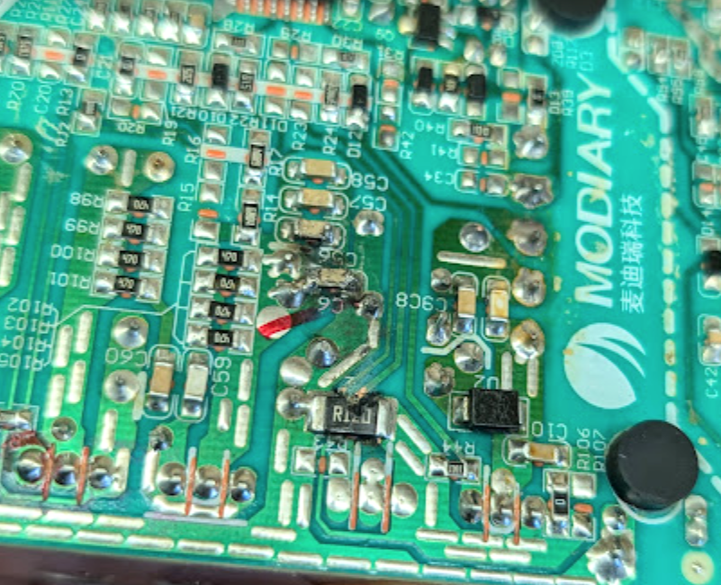

This is a great forum, it’s helped me out a lot with my bike. My Aventure power supply fried, which led me to this post. I popped the charger open and was hoping I could replace the obviously fried resistor, but after I replaced it, it was more than that so I didn’t dig much more. I’m not giving Aventon any more of my money, which is why I bought the Satiator. I snipped the end off of the original PSU and made a cable with it using an XLR end that fits the Satiator. The Satiator is expensive, but worth the price for me since I have multiple batteries for bikes and other things.
Inside of the fried Aventure PSU
