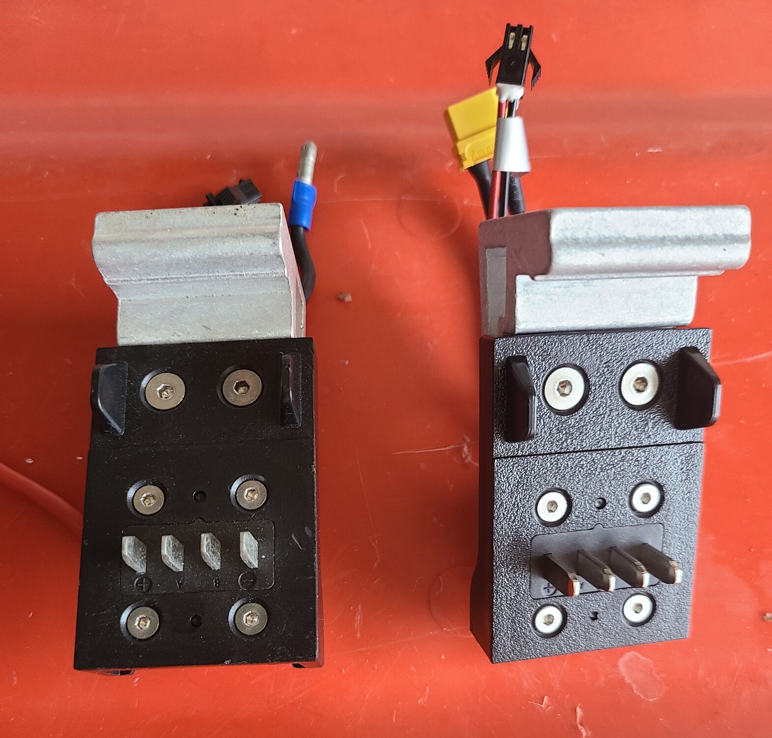

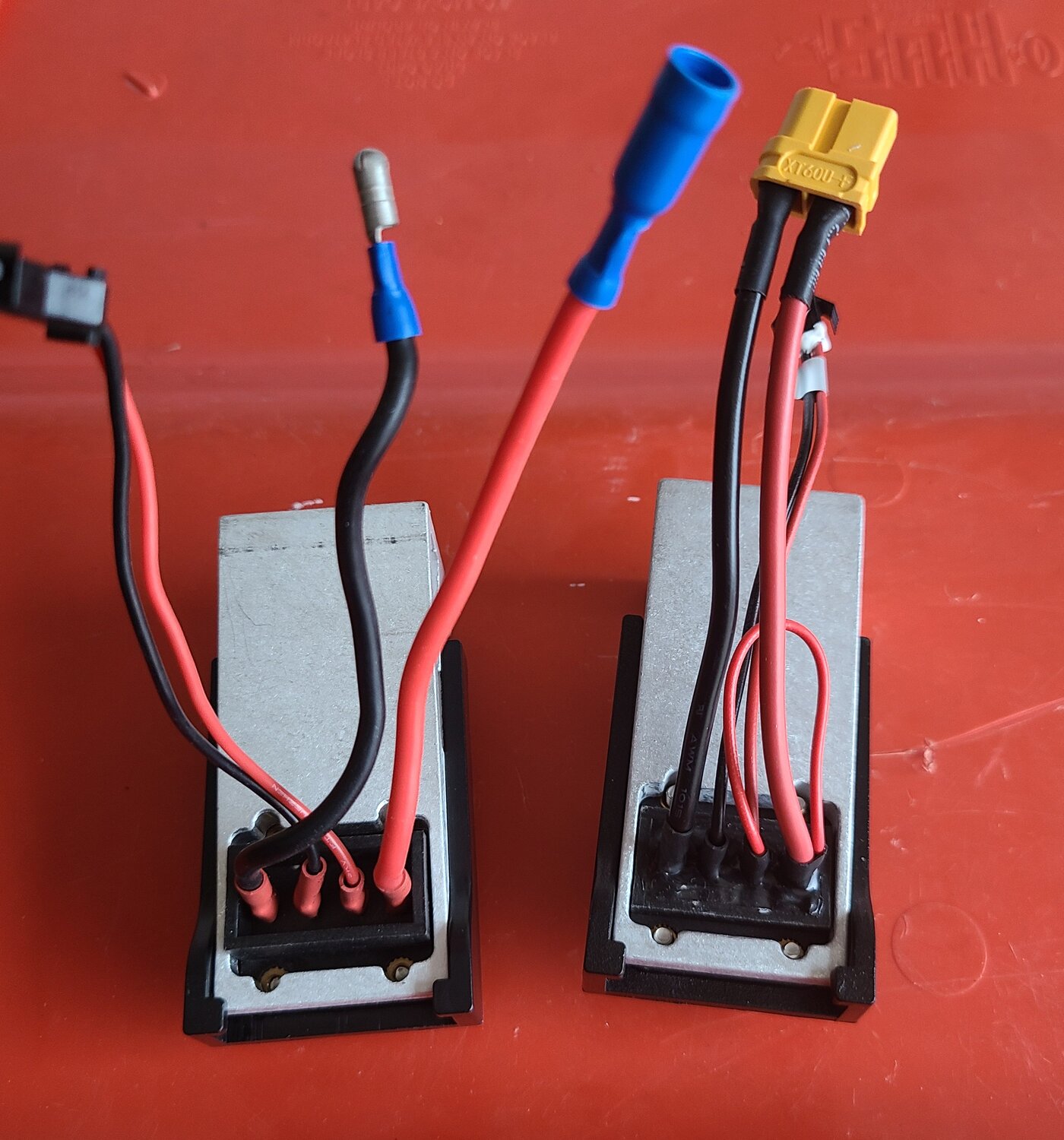

The battery is identical to the V1 with some different decals. I really cant see any differences. Last season I did try my grandsons V2 battery in my bike and it wouldn't turn on. The terminal is only different in that the 2 red wires have a jumper between them and there is a combo connecter instead or the separate wire for the heavier pos and neg. Its very well sealed against water. I have attached picts of both. The new terminal block is on the right. You will have to cut off the combo connector and crimp on bullet connectors on the terminal wires. Its easy.

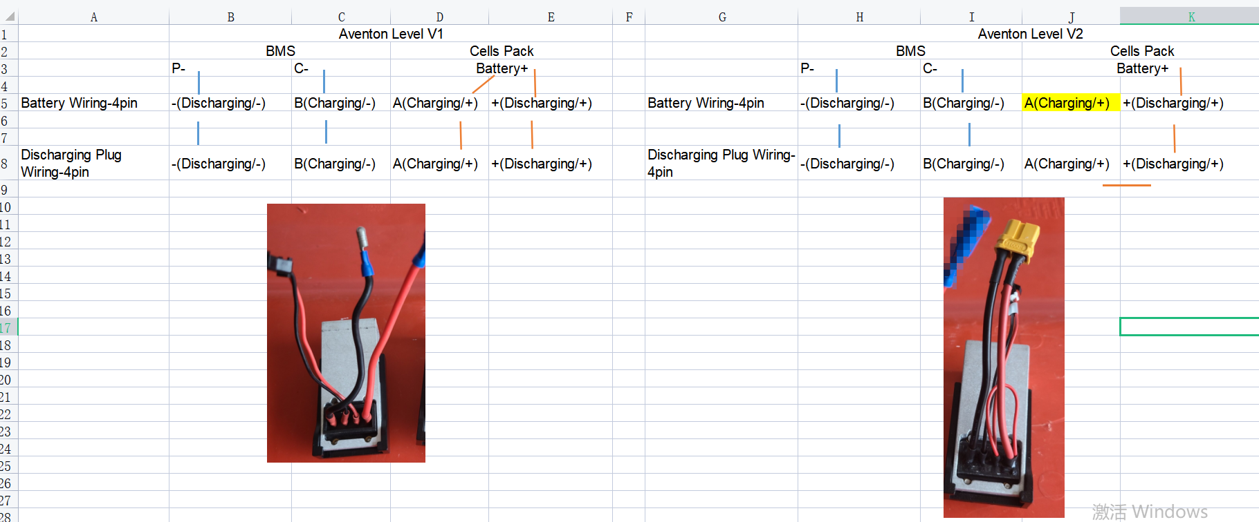

Thanks for sharing, according to the terminal difference, we guess that the A-pin (Charging/+) on V2 battery is not wired inside of battery, so the A-pin (Charging/+) on plug needs to borrow power from the thick red wire (Discharging/+). Usually Charging/+ & Discharging/+ wire come out from same place, the positive of cells pack.
But I have a doubt, even under this situation, the V2 battery discharging shall work to power on the V1 bike, only the frame charging port doesn't work.
Also do you test V1 battery on V2 bike?
For the SYR battery with 4pin, we usually wire like the way of Level V1, A+/B- used for charging via the frame charging port.

Thanks, I think the V1 battery will work on V2 bike, both charging and discharging work, but the V2 battery will only cause the V1 bike charging void (via frame port). Looking forward to hearing your testing results.

However, I did put my old V1 battery into my Level with the new terminal for the V2 battery and it works fine, powers up, charges from the port on the frame. Nothing is different. Now I have a spare for really long ride, it just doesnt have range more than 20 miles nor does it have the oomph it used to have. But it's fine for short rides and great for a spare to keep my new battery going longer.
This is correct as we are discussing. Now we wait for the testing V2 battery on V1 bike.
The V1 and V2 discharging plug are actually functioning same in wiring. The only difference is battery inner wiring of the 4pin port.
