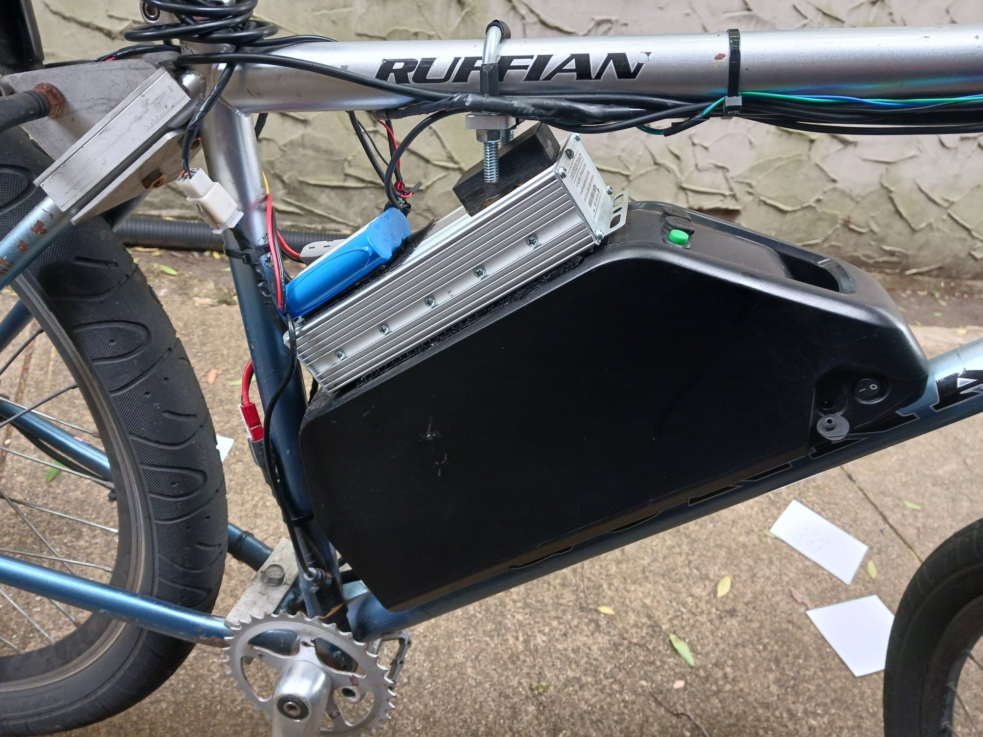

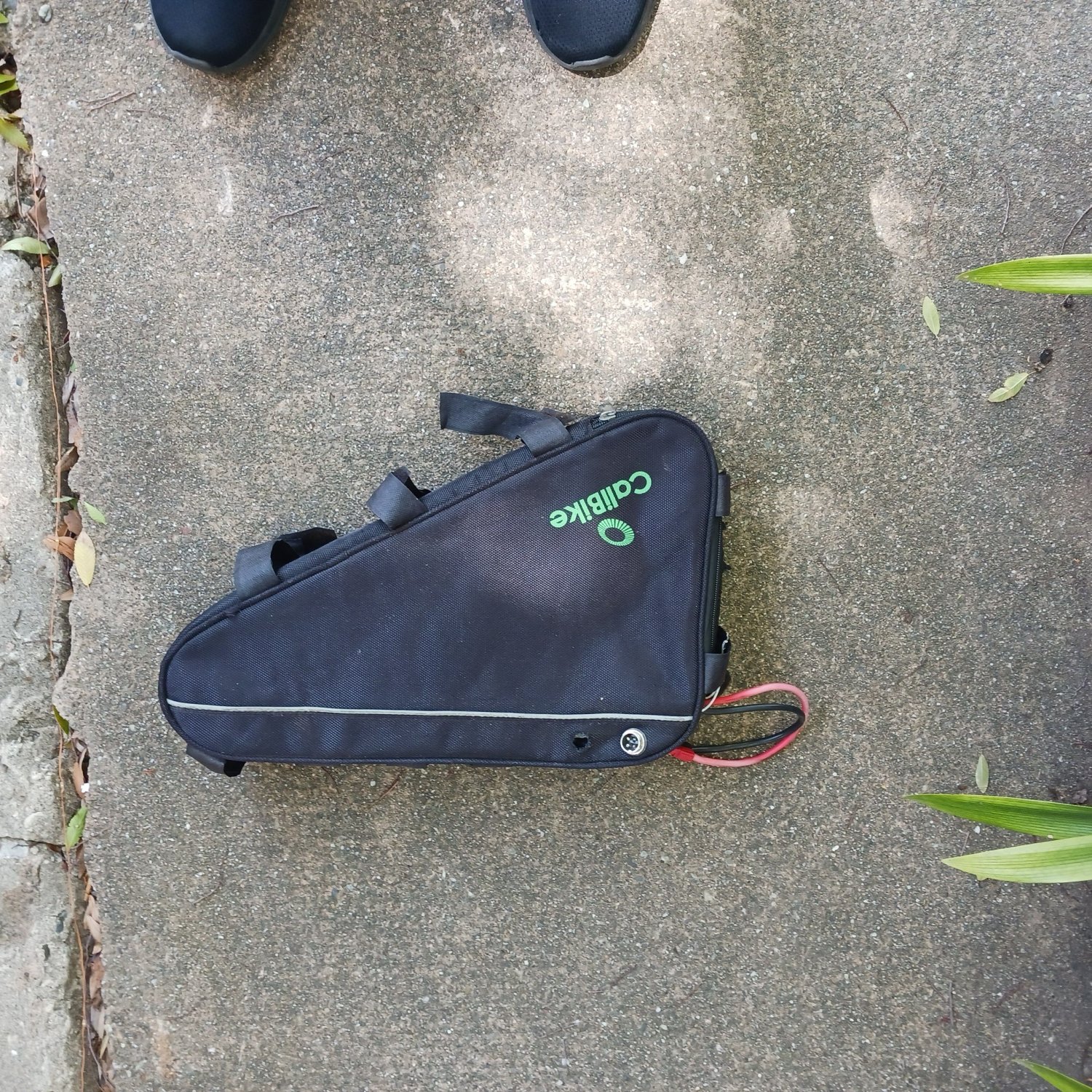

One of the reasons that I wanted to join the forum is to get some advice about batteries in general ,and my 48 volt battery in particular . It is a 48 volt battery from Calibike . It is a large and heavy unit , 14 lbs. I cannot remember other specifics about it , and they have discontinued making them . I assume he was making them , but they could have been supplied to him. It is triangular in shape and is held in place with Velcro straps . I have had it for a bit over 3 years , maybe more . My memory is not what it used to be . And I do not keep records . I used it most every day , so I have been guessing that it has had somewhere around 900 or more charging cycles . I believe I have gotten my monies worth . It would seem to do fine fresh from charging , but began to leave me stranded on the return portions of my trips , which were between 20 and 30 miles . It would just go dead . Take it home , charge it up , seemed to take a charge , but then leave me stranded again. I do not have the knowledge or instrumentation to diagnose the problem . And I am under the impression that it can be dangerous to open up lithium batteries . I assumed that I had worn it out . It could be repairable , just don't know . I recently charged it over night and it it took a charge of 45 volts . It has been sitting idle for over a year . I replaced it with a 52 volt unit from Calibike . It is smaller and lighter , but seems to be at least comparable to the earlier battery . More professional packaging , built in mounting on the water bottle mount on most bike frames . It does not seem to have the capacity of the earlier battery . It certainly has fewer cells . What is correct terminology for a batteries capacity ? Is it measured in volts , watts , amperage ? The most notable deficiency is going up a grade .On level ground it is barely noticeable when a battery is half discharged . But on a grade it become very obvious . The hills near my house can start from about 30% slope to around a 45% near the top . A gradual but profound increase. Towards the end of a trip it will barely make to the top . I know that gravity explains the phenomena , but what is is happening in the battery . I figured that all I need is higher volts. But I am slowly coming around to believing that the controller has a large part in all of this . I am the first to admit my ignorance in these matters . Is there a simple explanation , Or should I just buy a book and educate myself . Can anyone recommend a book on these matters ? Electricity for idiot perhaps . Enclosed are pictures of both batteries . Thanks in advance for any suggestions .

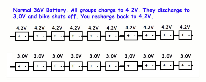

Your first ebike used a 36V battery, so let's start with that, A 36 volt battery is made up of ten cell groups in series, Each group can consist of 1 or more cells in parallel.
Lithium cells have a max charge of 4.20 volt, and battery makers agree to keep the minimum charge at 3.0V. Their nominal charge at 50% is about 3.7V. That means a 36 volt battery runs between 30V and 42V.
If we look at 48V and 52V batteries, they use 13 series groups and 14 series groups,
A 48V battery runs 54.6V at full charge, 48.1V at nominal and 39V at minimum. If you are measuring only 45V on that 48V battery, something is wrong with it or your measurement,
It was out of balance.That is why it only charges to 45 volt. Some groups are 4.2 volt but not all.Then when the lowest groups get to 3 volt or whatever the BMS low volt cut off is it shutdown. You can balance it but it does require knowledge &opening the package. It's not difficult but you have to be extremely careful

No not worth the risk for anyone new to battery repair and I'd say you got your monies worth. It's probably a Unit Pack Power battery. A bottom of the line build. Anyone suggesting balancing without demonstrating their skill set should not be trusted given the risks.

Sounds like you definitely got your money’s worth out of that 48V Calibike battery — 900+ cycles is great! Based on your description (losing power midway), it’s very likely the battery is just worn out. Lithium batteries naturally degrade over time, especially with daily use.
