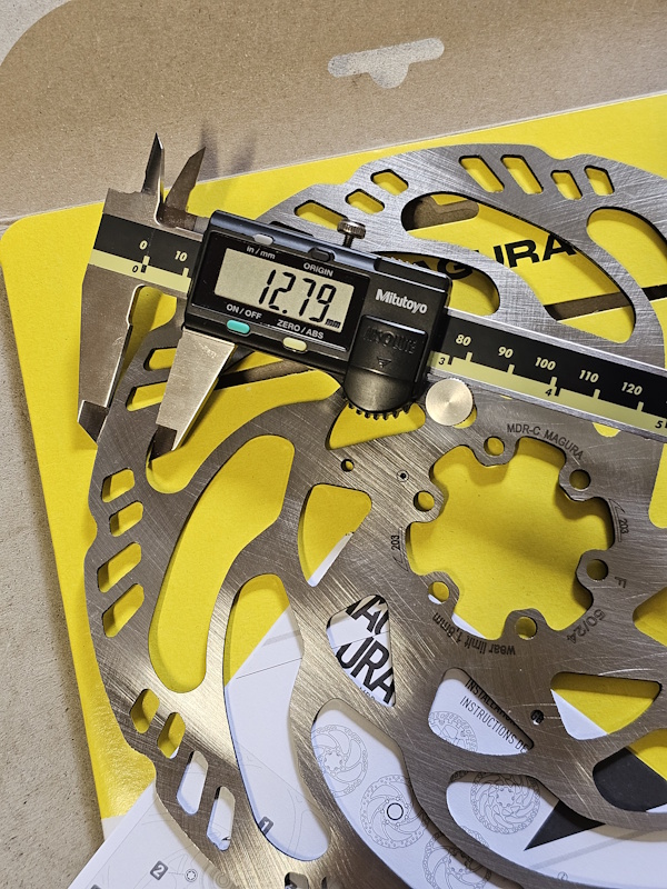

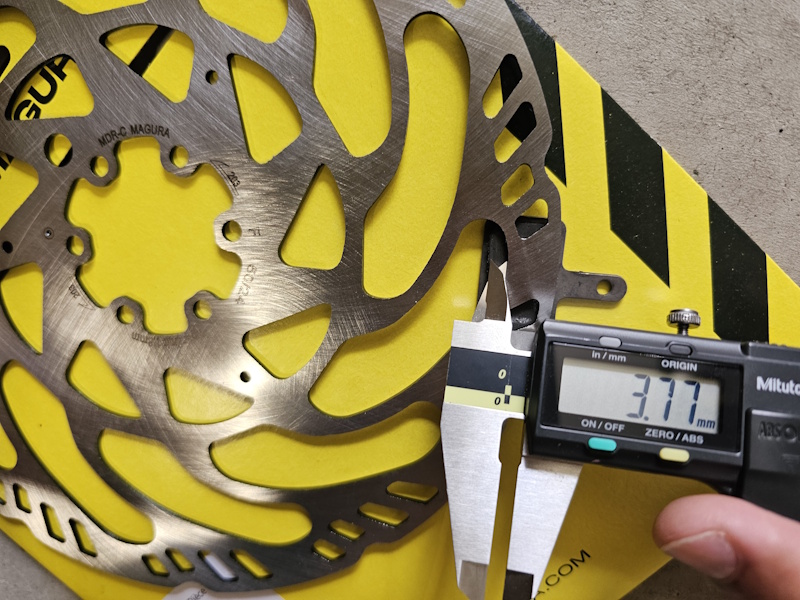

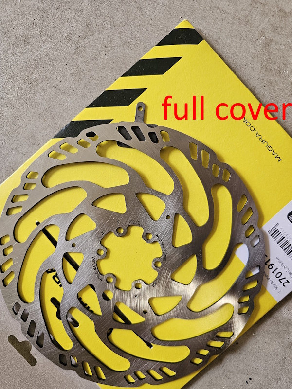

Reading an earlier post saying most aftermarkets rotors in a shop measured around 17mm contact patch I went ahead with the MDR-C Maguras and... as I was afraid, their contact patch at the lowest point measures at most 12.5mm... :( That leaves a good 3.5mm of the B05S pads sticking out as they measure ~15,5mm high (vertically). However as you can see from the pictures this "contact gap" varies from 3.5mm down to 0 (full pad cover) as the pockets on the Maguras are a varying size shape. I wonder whether this constantly varying contact area during braking (as the wheel turns) will a) be felt / heard b) reduce the expected stopping performance or c) won't make any difference apart from looking not sized correctly to the trained eye...
PS. Thinking about possible performance impact: Magura actually sells pads that match these exact rotors. Those pads are made also for 2-piston calipers (but from Magura) so it's just 1x left and 1x right, and are shorter in height than the B05S. That means the contact area is not larger than the one I am getting now with Shimano pads and they are supposed to work fine. That must mean that the only possible side effect is either noise or a varying wear on the pads? but with the wheel turning it shouldn't be the case? I wonder if anyone has tried this combo before. I really want to keep them and try them but that will void any return...
I wonder if the compatible Magura pads are any wider to compensate for the reduced height.
