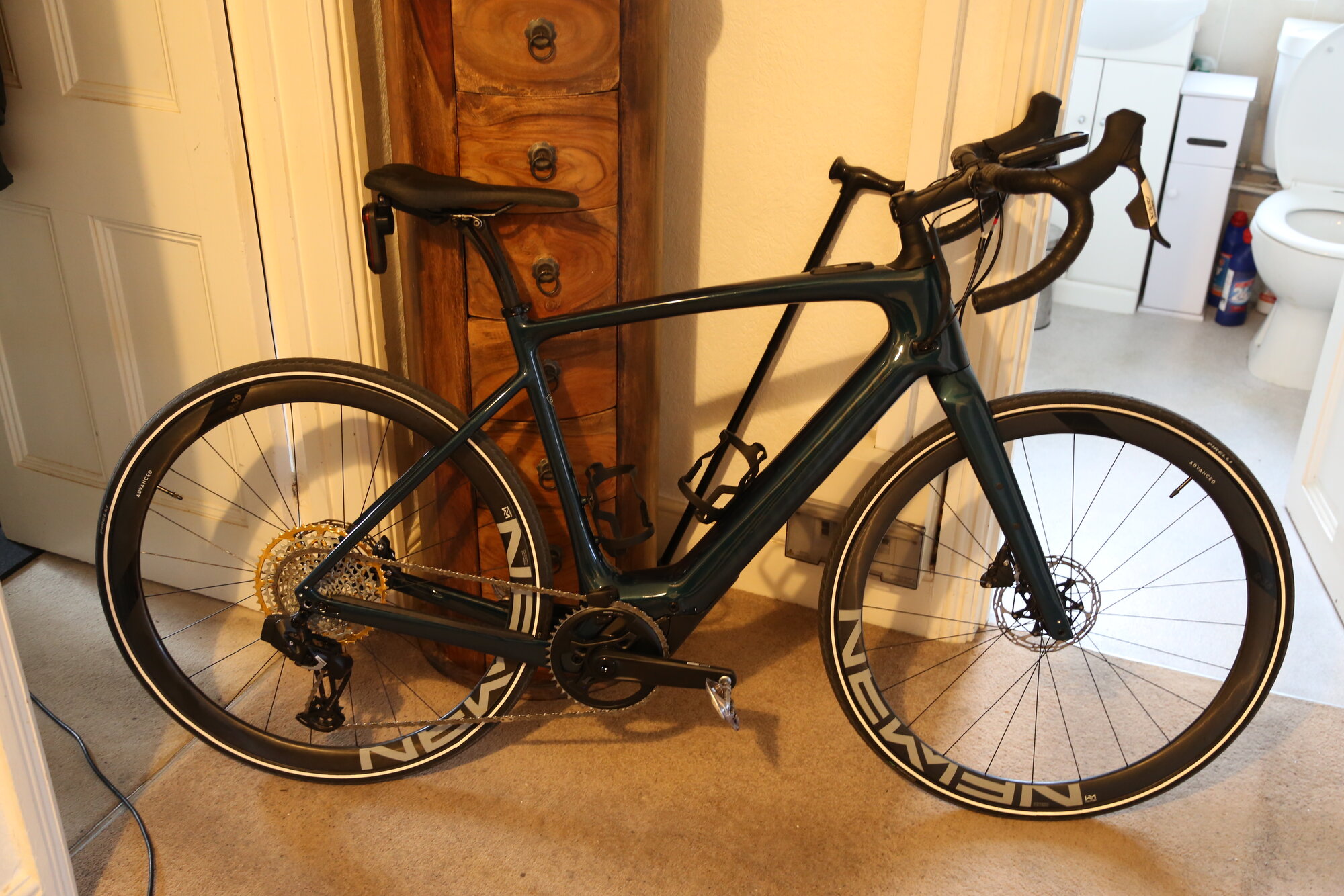

I got my Creo 2 carbon comp yesterday and wanted to ride the back to back so I had a really good comparison. I did a 2.5 mile loop which included a 10% hill so I could hear how the motor was.
First up was my Creo 1, which is heavily modified and light as the S-Works. This bike fits my extremely well and the loop was done with no fuss. Di2 worked flawlessly and motor pulled me up the hill but we audible. Time was 13.18 on this bike
Next up was Creo 2 as out the box with 47mm tyres. Rolled much better than I was expecting, but hard seat post has no give and made the ride hard as concrete. Tyres did damp damp some, but not to the same level as my Ergon seat post. Worth a mention is the Future Shock 3.0. This is the one without the adjustment and is a vast improvement over the 1.0 on the Roubaix. Was considering swapping that for the 2.0 on my Creo 1, but was so impressed, it will now stay. Coming from Shimano gears, the SRAM stuff is good, but not on the same level as Shimano. The brakes were ok and the gear change good. Lap time on this bike was an impressive 13.25, just 7 seconds shy of the Creo 1. Motor pulled well up the hill and very quiet.
Finally, I swapped out a few bit on the Creo 2. I took off the wheels and replaced with a set of Newmen R38 with 28mm tyres. This also had a set of SRAM Red rotors fitted and a Garbaruk 10 to 50 cassette. By swapping these wheels, it took 1.8kg off the bike, the difference is insane. I also swapped the seat post to my Ergon CF3. This now a different bike, extremely comfy rear and very rapid. Yes Specialized states min 38 mm tyre, but the bike feel fantastic with 28mm and did not explode or report itself to the Police !! The new motor is an absolute gem. No more mechanical gear noise, smoother clutch engagement and a very noticeable power increase on the hills. This bike did the lap in a time of 11.33 and I was easy able to pul gears one or two higher than the standard Creo 2. The higher grade discs also really improved the brake quality, so they were much more like Shimano.
I have few more changes to do on the bike. I have a Garbaruk 46T gold chainring on order to match the rear cassette, a Shimano HG+ chain to get the best changes from the Garbaruk cassette and some ceramic brake pads. I also need to decide on which of my handlebars I am going to use so I can get a really neat from end with just 2 cables on show. The dropper cable will be removed and I should be able to get the remote wires along side rear brake cable into the handle bar holes

Thanks for sharing! I have 1 coming in a month as well. I am particularly interested in the 28mm tyres swap. Specialized says that the minimum width is 38mm if order not to drop the bottom bracket too low. May I know what is the length of the crankarm you are using and do you have any pedal strike when cornering?
My bike is 58cm fitted with 175mm cranks. Rode it like my normal bike and this is not an issue. The main reason for the min tyre suggestion is to do the wheel circumference and getting wrong speed ready from TCU. My Garmin handles this for me, so it is not an issue

Dazman what do you think about the Ergon seatpost? I was considering the Specialized Terra but now you have me wondering.
The Ergon Cf3 / Canyon VCLS 15 (same post) is the best. I have the post on my Creo 1, 2 and Roubaix. The split leaf carbon spring gives a similar compliance to the future shock and make the post much comfy. The dropper has zero flex, the Terra will be better but it does not movement of the Ergon. The Creo 1 came with a similar post to the Terra and was an S-Works one and I swapped to the Ergon, again to big comfort improvement. My favourite post for sure.
Thanks for that info….much appreciated. Ergon it is! 👍. This bike is costing me a fortune 😃
That is way I went for the Comp as I knew I was changing much of groupset. To be fair, I did already have some of the parts. I now have all I need the update and just waiting for the last few bits to arrive. I have Garbaruk 46T gold chainring, Garbaruk gold derailleur pulleys and a Sram bleed kit so I can swap over to my Coefficent RR bars. I am loving the bike so far and this will make it complete......for the meanwhile - lol Bikeinn (Tradeinn) had the Ergon post for £169, cheapest I have seen and they do international postage
