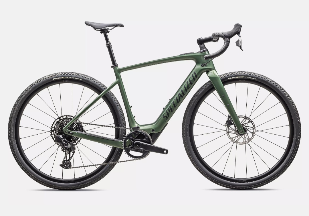

Just look at the picture of that green Creo (lovely colour btw) and imagine flat bars where the stem ends. Now look at how far further forward the hoods are. Or the drops. The only way to be sure is to sit on a Creo and try both positions. Better still would be to swap out the drops and actually test ride flat bars.
I see what you mean. You could lengthen the stem to a point. Hmmm, wonder if someone makes a flat bar that first sweeps forward near the stem?

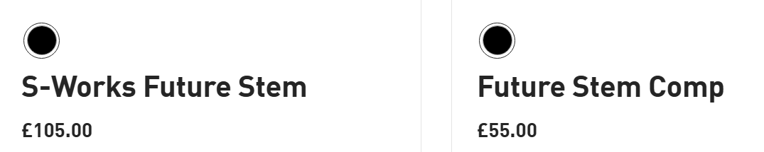

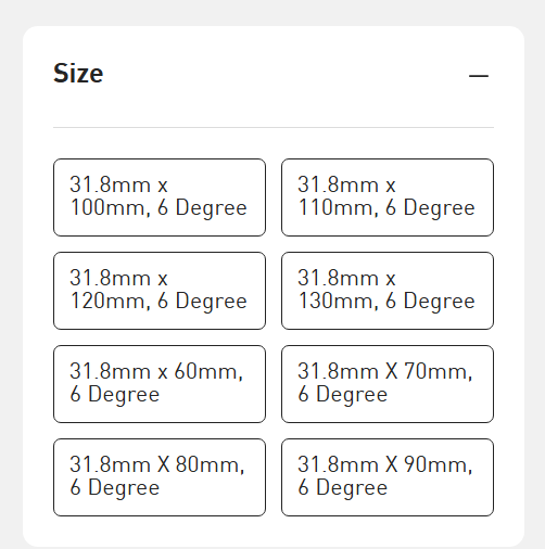

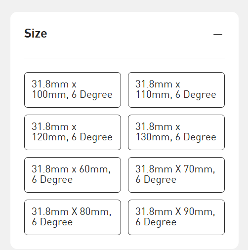

Did you notice installing a 140 mm stem on the Orbea? Creo 2 requires installing a Future Shock compatible stem. I would first check whether such long FS stems were available.
Most stems are compatible with the FS. FS equipped bikes come with shims so standard stems will fit. They just to have the same measurement/height at the steerer tube connection.
Have you asked Specialized? Because I have.
No, I haven’t asked. I looked in the literature and more to the point I own 3 FS equipped bikes and have experimented with different stems on one of them by using different lengths, angles, and one that was adjustable . The shim is for stems other than Future Stems.

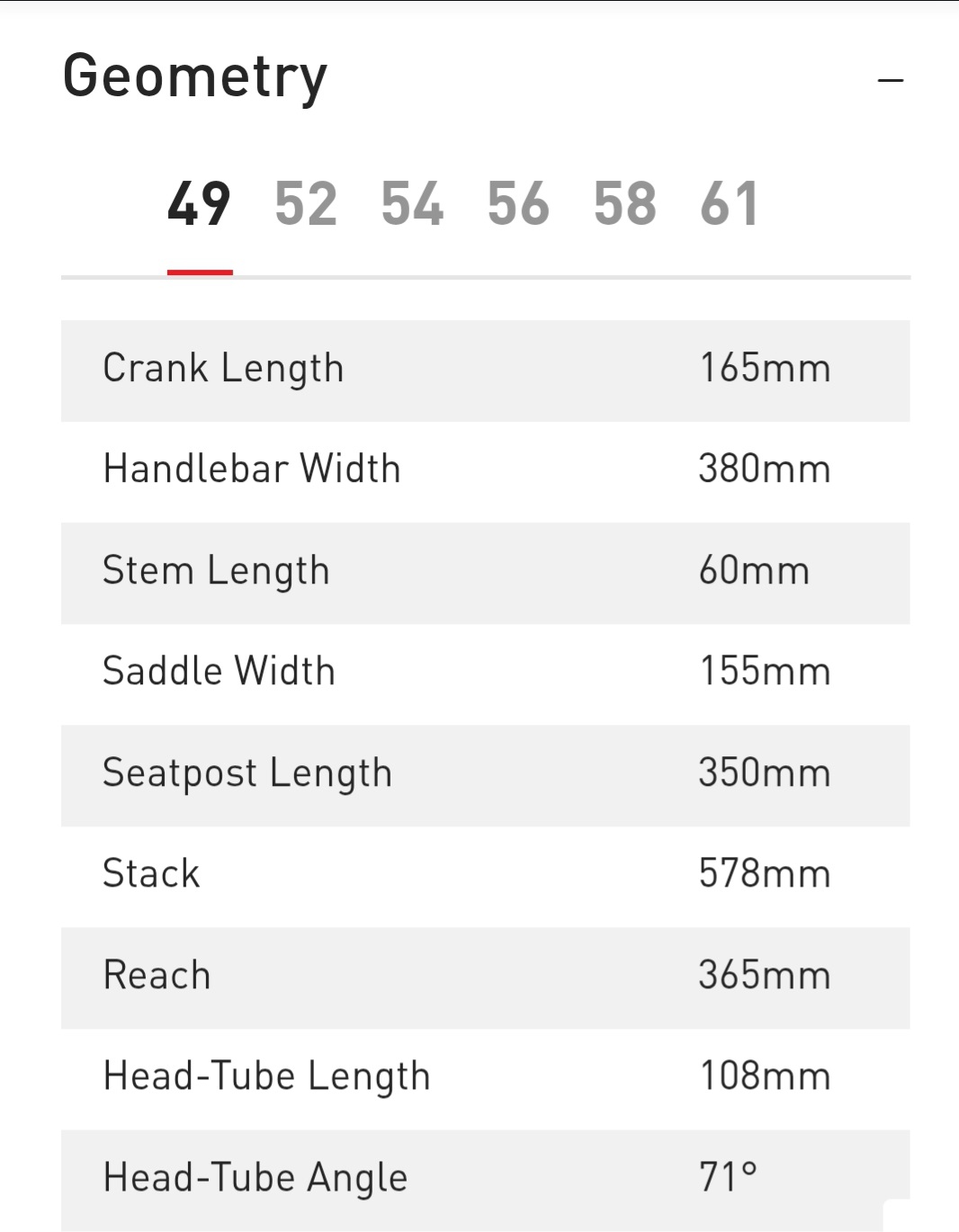

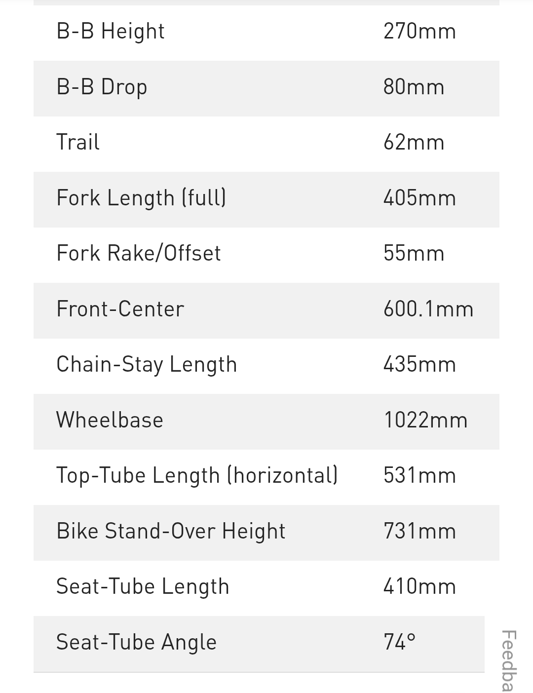

Thanks! So flat-bar suitabiliy in a frame largely comes down to relative top tube length, head tube angle, and wheel base? If so, could someone please look at the Creo 2 frame and see how far off those specs really are for flat bars?
Creo 2 Comp
View attachment 198942View attachment 198943View attachment 198944
Remember, the OP wants to convert a Creo 2 — not a full-bore road bike, and not any old drop-bar bike. If gravel bikes are on the spectrum between drop-bar road bikes and flat-bar MTBs, then the Creo's probably on that spectrum, too. Where?

Comparing the distance from tip of the saddle to the handlebar clamp I find my flat bar M size creo is about 1 in longer than my size 54 vado sl 2. While sizing difference between a "medium" and a 54 account for som of the difference, the stem on the stock creo (80 mm) vs the stock vado (60 mm) accounts for most of this. I noticed this difference at purchase but was told a longer stem would be out of stock for "awhile". I can live with the difference and haven't changed the Vado stem at the moment.

the top tube and wheelbase of a creo 2 is basically the same as a diverge, which is a drop bar gravel bike. a tarmac of the same size, on the other hand, is almost three inches shorter in wheelbase. that's a big difference, and since the top tube isn't as much different as the wheelbase the angle of the fork is a whole 2.5 degrees different. sounds like small differences, but on a long ride, or any ride where you're pushing the limits, it's a huge difference!
putting a flat bar on a tarmac would be nuts. putting a flat bar on a creo 2, certainly much less so. and that in-between geometry is also probably why a bike like the skitch can be offered with different bars without being ridiculous.
