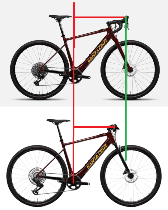

I cannot explain why Santa Cruz chose a fundamentally wrong design for the Skitch...
...but choosing the same frame for the flat and drop bar version has allowed the brand effortlessly (and cheaply) offer as many as eight configurations.
@VadoSL: That would be the fate of your Creo 2 if you converted it to the flat bar. Do you still think it would be such a great idea? :)

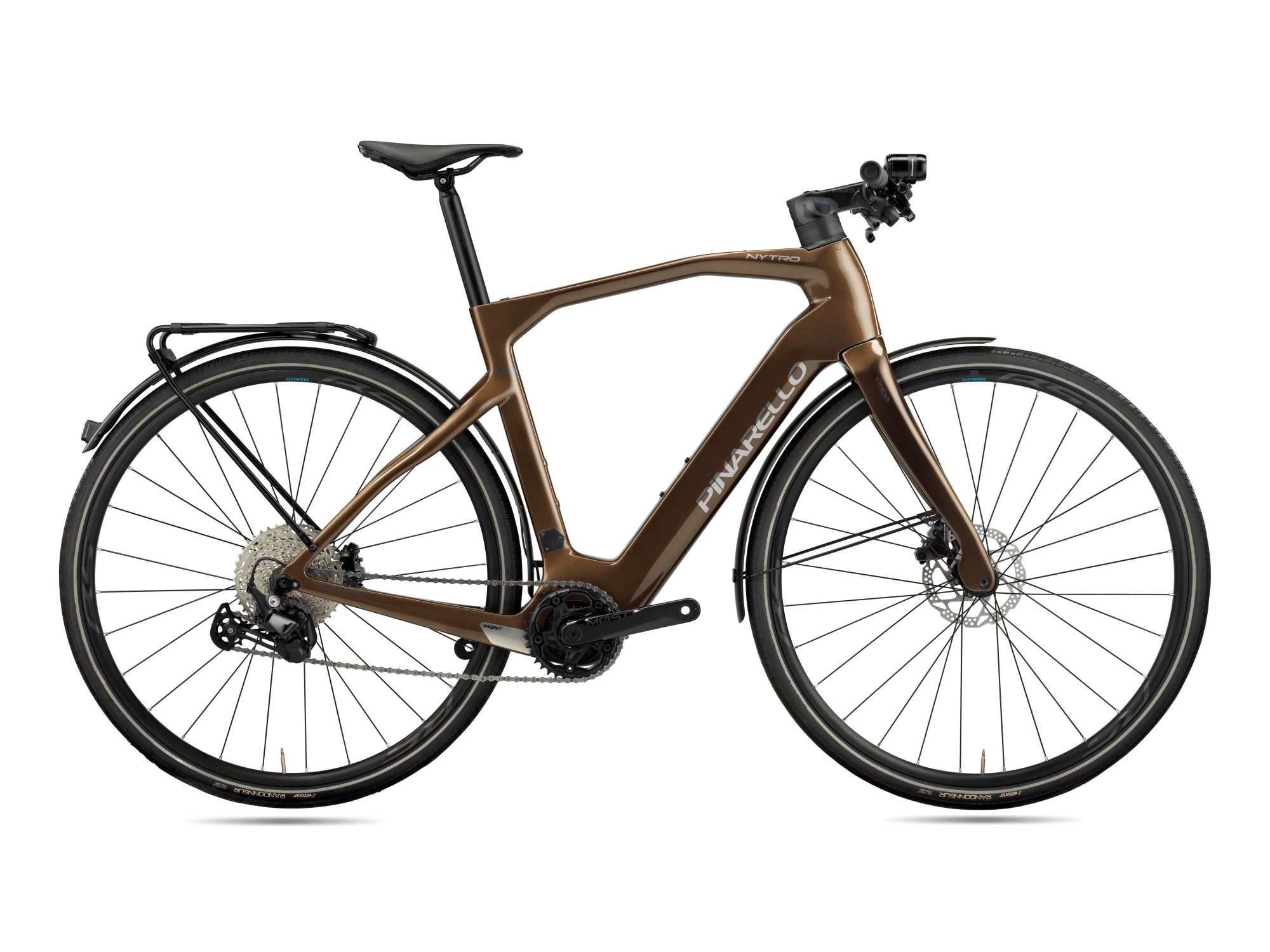

@stompandgo has bought a Pinarello Nytro E5 Allroad, a lightweight flat-bar e-bike with a TQ motor. Perhaps you could consider a Pinarello?
I respect that this is a Specialized forum, but if you're going to allow detailed discussion of the Skitch, then here goes. My latest bike is a Pinarello Nytro E5 Allroad.
It is based on the Grevil E5 gravel frame. As such, it does not have road bike geometry, it has gravel geometry, which is a bit like a cross between road and MTB. Shorter top tube, relaxed angles, stiff bottom bracket but other areas built for comfort. The rack and fenders are SKS. Mine came with a MIK adapter which I switched out for Topeak. The lighting is Supernova. The drive unit is the TQ HPR50 with a 360Wh internal main battery. A 160Wh range extender is available. TQ has also had their fair share of motor failures, but they are honoring their warranty as far as I can see. Pinarello used to use the Fazua Ride60, but switched due to reliability issues and lack of support. The latest gaffe of promising a range extender for years, and then dropping it, notifying dealers and owners with a memo, should not give anyone confidence in the future of that platform.
You could turn a Creo into a bike like this, but it would cost you over $1,000. Not crazy money if you really love the bike, but not chump change, either.
A quick look at geometry specs between the flat bar nitro E5 allroad and drop bar E9 gravel seem to indicate that the frames/geometries are the same for both flat and drop bars. I think the OP was just asking for how to convert rather than a discussion of pros and cons of conversion based on frame geometry but for those that argue conversion would create a hybrid mongrel Pinarello is another premium brand that apparently thinks otherwise.
Sorry, I wasn't referring to your post but to another poster who seems to think that flat bar and drop bar bikes must have different geometries otherwise the manufacturer is just cheap and trying to save money by slapping different type bars on the same frame - to which Pinarello and Santa Cruz (and probably other) premium bike manufacturers cleary disagree.

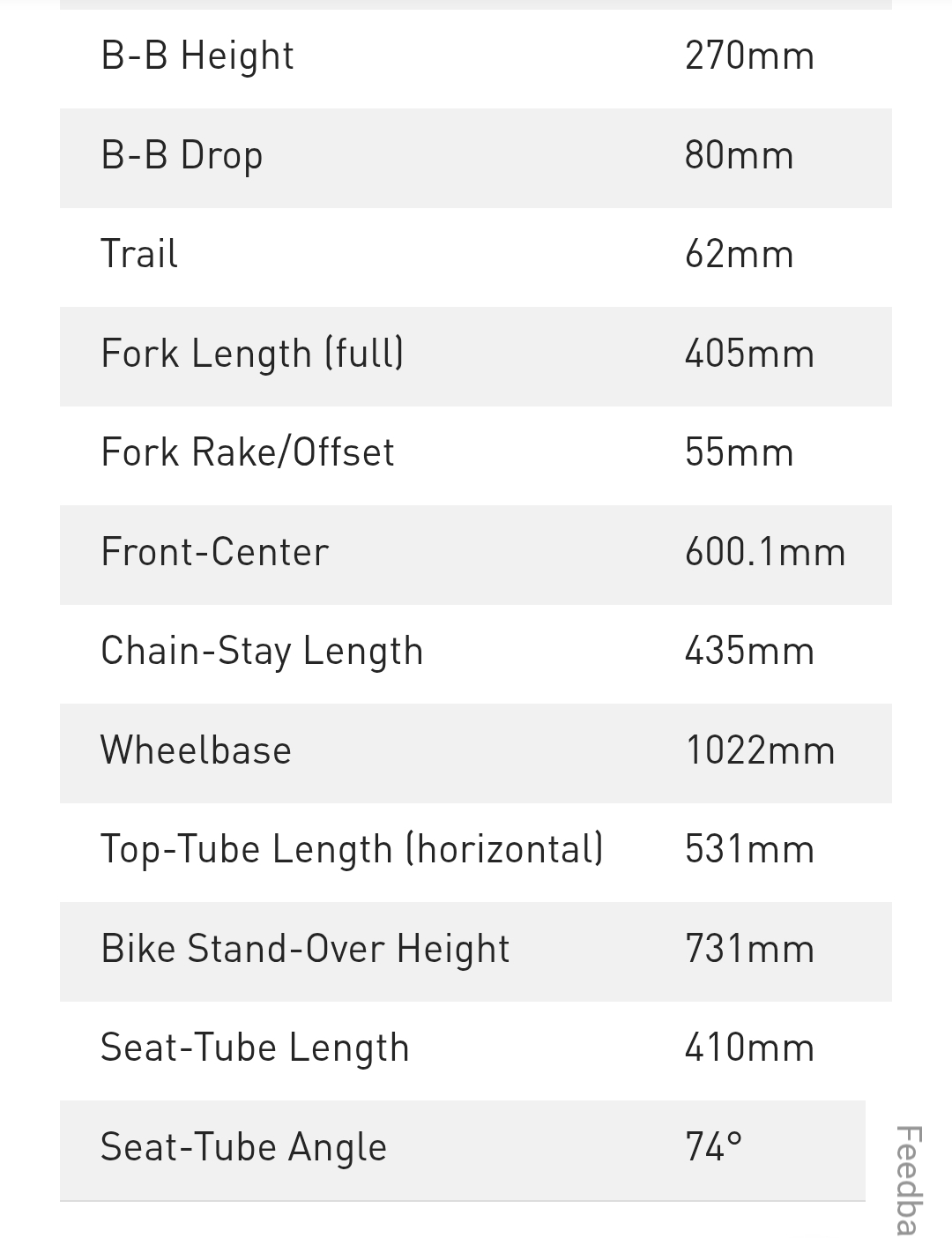

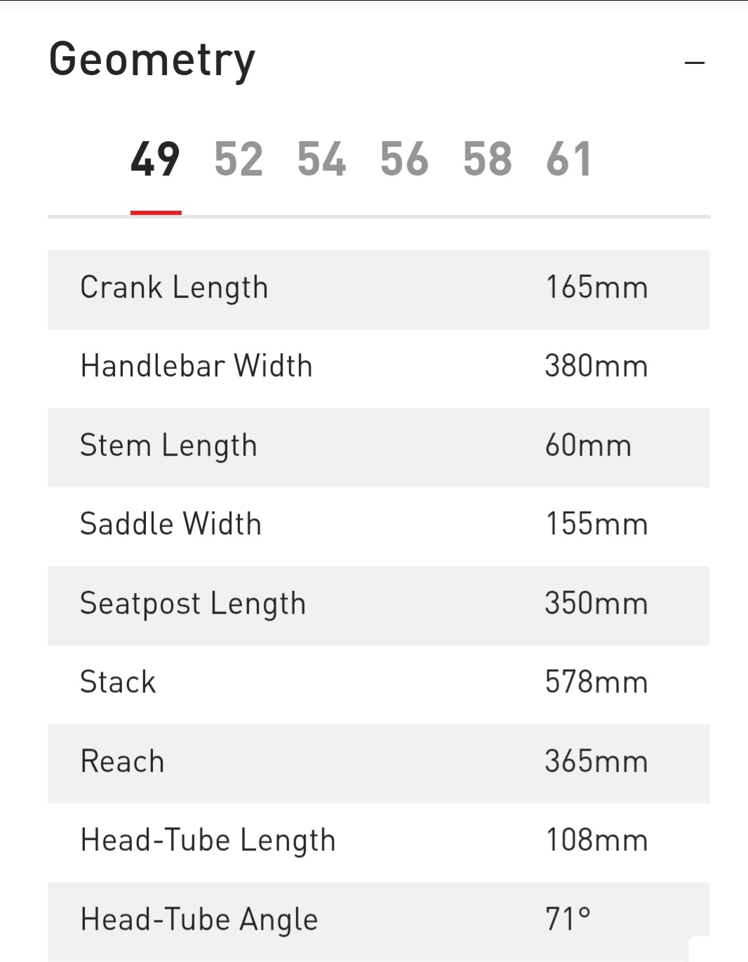

Thanks! So flat-bar suitabiliy in a frame largely comes down to relative top tube length, head tube angle, and wheel base? If so, could someone please look at the Creo 2 frame and see how far off those specs really are for flat bars?
Creo 2 Comp
Remember, the OP wants to convert a Creo 2 — not a full-bore road bike, and not any old drop-bar bike. If gravel bikes are on the spectrum between drop-bar road bikes and flat-bar MTBs, then the Creo's probably on that spectrum, too. Where?

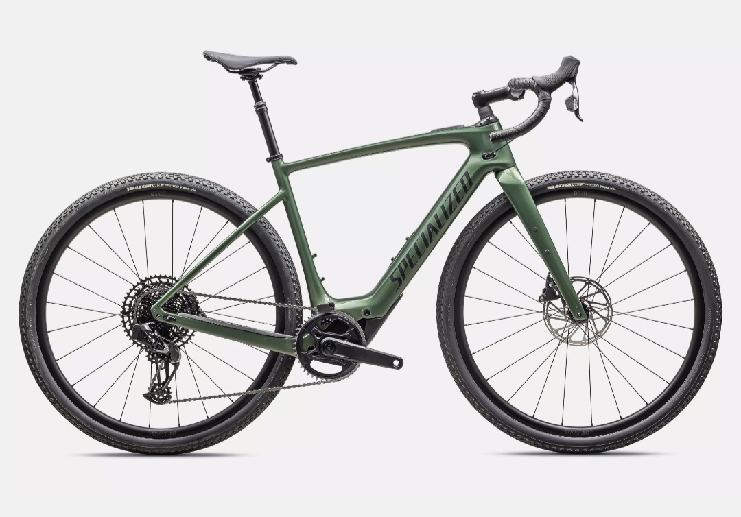

Creo 2 Comp
Remember also that we have at least 2 members with presumably successful Creo 2 conversions. One for sure said that he loved the result.
Thanks!
Just look at the picture of that green Creo (lovely colour btw) and imagine flat bars where the stem ends. Now look at how far further forward the hoods are. Or the drops. The only way to be sure is to sit on a Creo and try both positions. Better still would be to swap out the drops and actually test ride flat bars.
It's a bit like tailoring a suit jacket. Measurements are designed on average arm length and reach. It's why bike fit (we're all different) is important. Changing the bars means compensating somewhere else. It might be fine or it might not.
