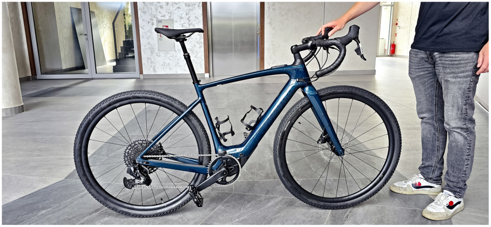

Sorry to have created any friction with my original post. I was just hoping for some technical support on the potential conversion. Like others I would just like a bike that is suited to me, and if that means going away from the original design concepts then so be it.
If anyone does have any detailed technical advice re specific parts then that would be very welcome ....
Not yet purchased, so a bit premature !!! I just want to be clear about what I am taking on before making a decision.

As you already know, @vado SL, I'm all against the conversion. Should you however do it, please consider these facts:
  • 320 Wh battery in Creo 2, 540 Wh in Vado SL 2
  • A flat handlebar to be bought
  • New brake levers and connecting them to the existing hydraulic hoses
  • If this is Creo 2 E5 (Alloy), then you will need to add the proper SRAM shifter. If it is the carbon Comp version, you will need to add a very expensive shifter pod
  • A long, Future Shock compatible stem (or a regular long stem with a shim) to at least partly compensate the geometry difference
  • The Specialized Road Remote is designed specifically for the drop bar (secured there by the bar tape). It is not the regular Specialized remote with all the functions such as F1/F2, walk mode, etc.
  • Anything else I have forgotten?
As the outcome, you will get something that might be good enough or perhaps not. Meanwhile, you could just try a Creo 2 out and find out the drops are not the deal breaker? Or, try a Vado SL 2 6.0 Carbon non-EQ?

I don’t think a different stem would necessarily be needed. Riding on the flats on a drop bar bike fairly well simulates the flat bar position so the current stem may be perfectly comfortable.
That’s true but a drop bar bike is designed to be mainly ridden on the hoods or drops hence the different top tube lengths or if converting a longer stem. The real issue is buying a very expensive bike knowing that your not happy with so immediately spending a considerable amount of money converting it with the risk it will not as good as the original. By the way when you end “ not trying to be rude” with a ”but”……you are always trying to be rude 🙂.
No, I'm very aware of drop bar geometry and the differences. My point is that it's possible to not need to change the stem. As for being rude, I'm also aware that I was rude but I'm ok with that. Stefan went back and stalked my prior posts which in no way contradict anything I've said in this thread.
