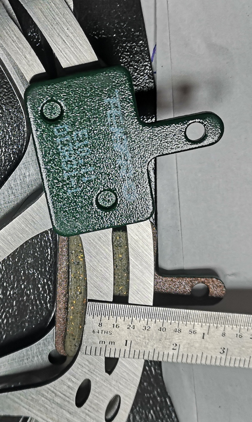

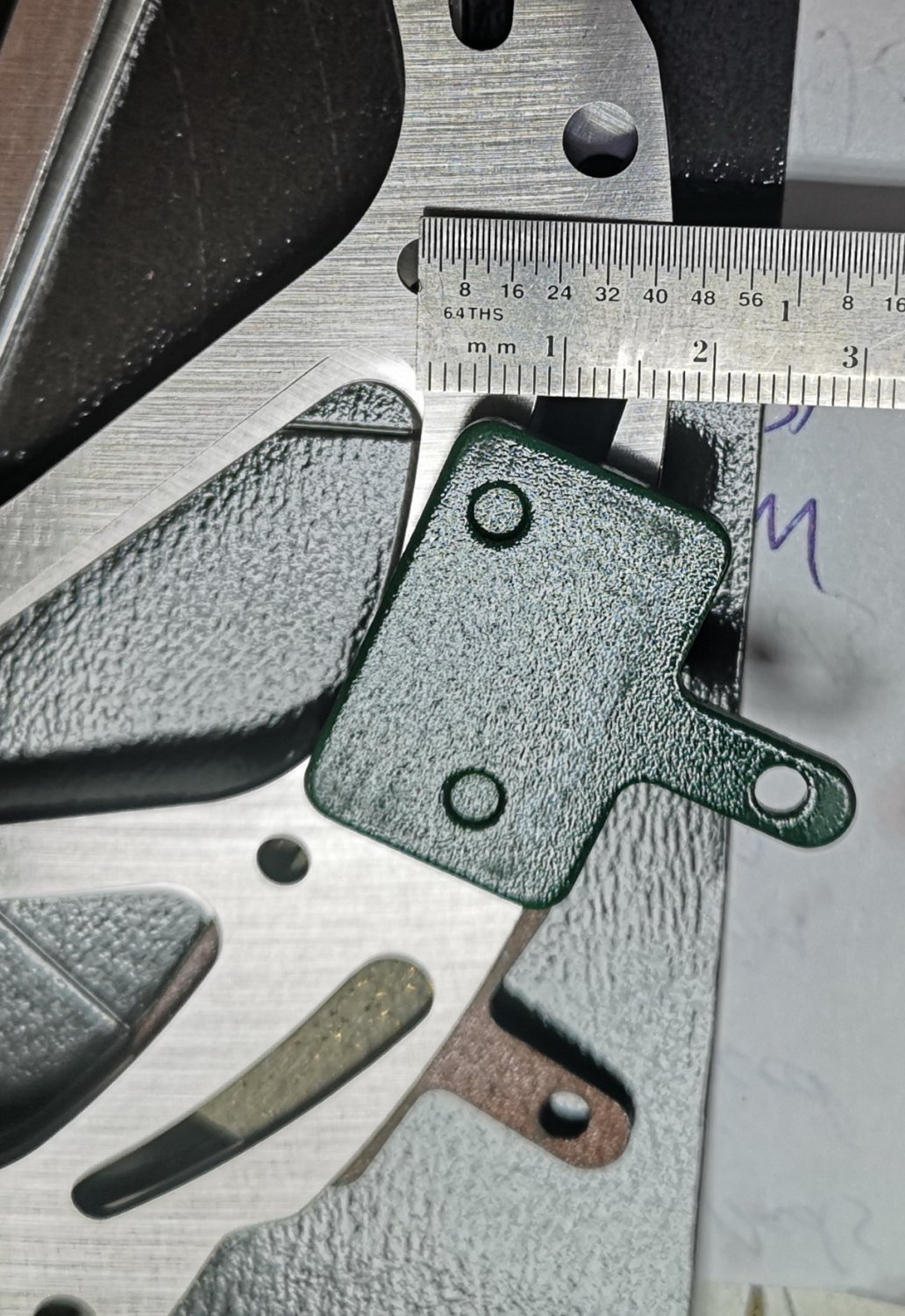

I received the Tektro TR203-52 rotors and E10.11 pads, the outer rotor brake pad contact area is approx. 17mm vs the SRAM Centerline RT-CLN-A1 203mm rotors which were 13.5mm. In the pics, the brake pads align with the contact patch on the Tektro rotors, you can see the brake pad overlap on the Centerline rotors which require the narrow pads and 4 piston calipers. I believe the Magura MDR-C is also compatible with the B05 brake pads that fit your BR-MT410. calipers.

I was thinking of getting the P20.11 pads, I figured the E10.11 will at least be an improvement over the OEM A10.11 pads that my bike came with. Are the P20.11 quiet, no squealing like some sintered metallic pads.

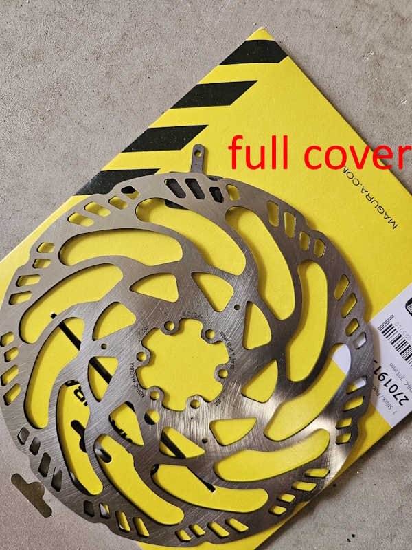

Reading an earlier post saying most aftermarkets rotors in a shop measured around 17mm contact patch I went ahead with the MDR-C Maguras and... as I was afraid, their contact patch at the lowest point measures at most 12.5mm... :( That leaves a good 3.5mm of the B05S pads sticking out as they measure ~15,5mm high (vertically). However as you can see from the pictures this "contact gap" varies from 3.5mm down to 0 (full pad cover) as the pockets on the Maguras are a varying size shape. I wonder whether this constantly varying contact area during braking (as the wheel turns) will a) be felt / heard b) reduce the expected stopping performance or c) won't make any difference apart from looking not sized correctly to the trained eye...

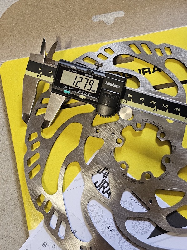

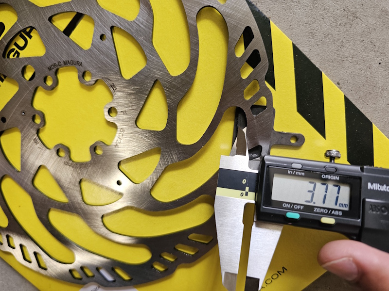

@Ringo9 the shape of that Magura rotor is very interesting. Your measurement isn’t accurate because it’s only 12.8mm at its thinnest point. That's not a ring; it’s kind of a wave with more or less surface area as it rotates, not to mention the varied sizes of the holes. I think you’ll be fine. I’m not sure what the performance will feel like. Could feel pulsating. Don’t know, and not speaking from experience here.
Good luck.
Well I described (and showed) exactly that, that the contact area is 3.7mm less than the pad's area at the lowest point, but it then proceeds to fully cover the pad as seen in my last picture :)
So it's neither fully covering, nor constantly lacking contact. More like alternating between a 12.7mm and 15.7mm contact area as the wheel turns.
The more I think about it, and since according to Magura these rotors are designed to work with both 2-piston and 4-piston calipers, the contact area they are designed to work with must be sufficient, so there should be no stopping performance concern. The only thing that remains to be seen is whether the extra pad material can result in noise/vibrations. If that's not the case then I can surely live with knowing my pads are a bit taller than the rotor area 😄

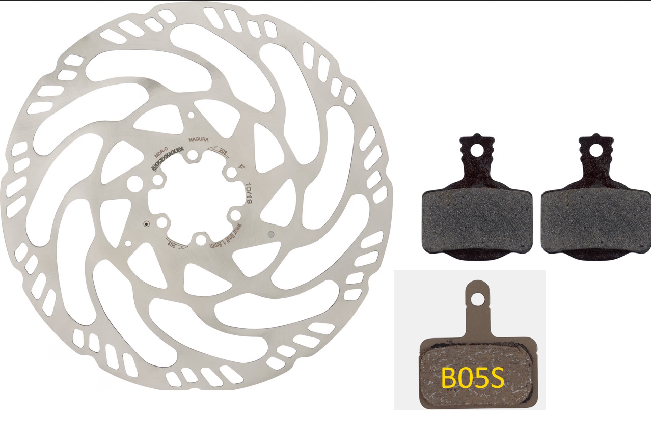

In the picture below is the complete set of this very rotor together with Magura pads for 2-piston calipers that is also available.
I pasted the image of my B05S pads to roughly compare shape and size. I can't say those pads seem really "longer" than my B05S that would compensate for the shorter "height"?

If you check Maguras website regarding their MT 2 piston calipers, they use the 7P brake pads, which are considered narrow type pads, they are not the same as your Shimano B05S brake pads that fit your BR-MT410 calipers.

You can get the Tektro 203mm TR-52 rotors on amazon for $32/each, I can confirm that the outer contact area is 17mm and they are definitely compatible with 2 piston caliper wide style brake pads. I just installed mine, will bed them in tomorrow.

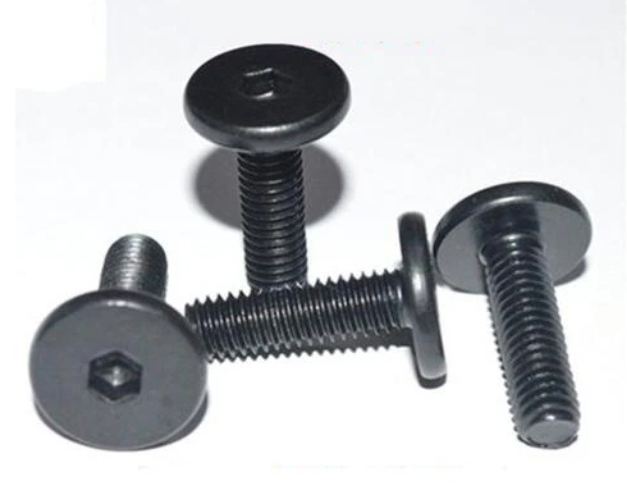

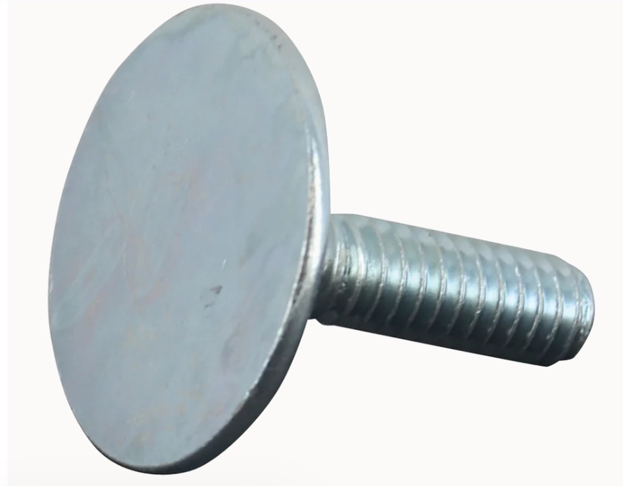

If it's a thru_bolt you can try and source something like this elevator bolt and put the nuts on the other side.

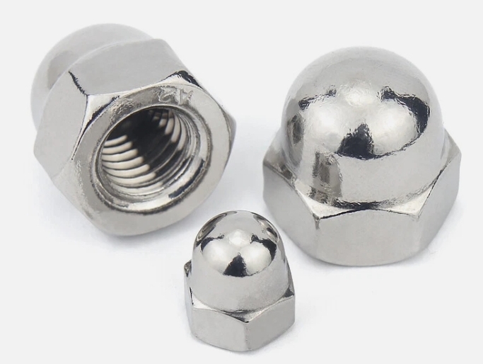

Then get some cap nuts for appearances if that bothers you.
View attachment 198090 View attachment 198092
