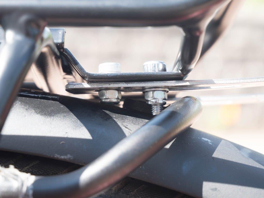

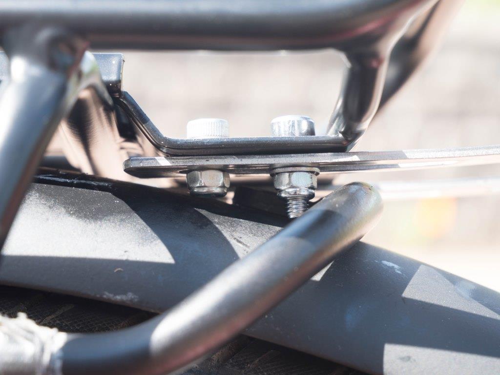

One difficulty is that the bolts supplied with the rack to attach the seatpost rails to the rack are too long. You can squeeze the forward bolt in, but not the rear one of the pair (see first pic). So you need some 10mm M5 bolts there.

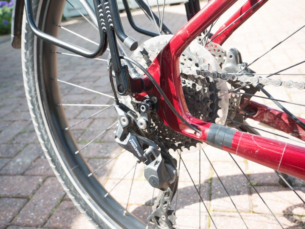

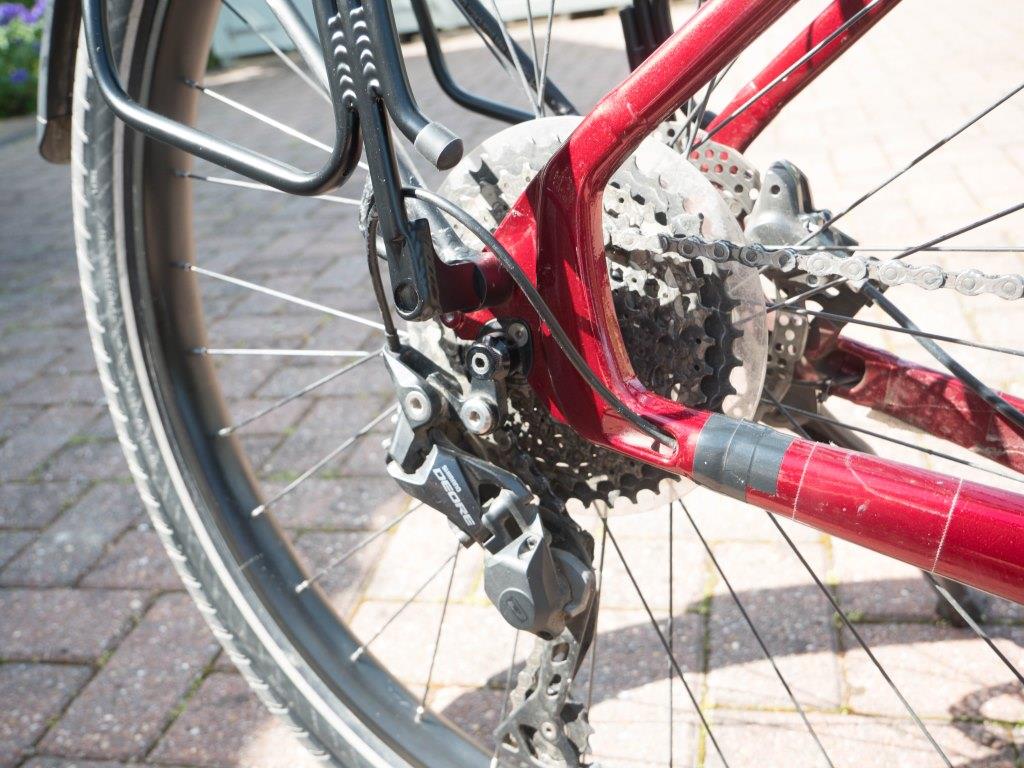

In the next pic you can see the spare mounting point. It appears to be to the right of the existing rack mount point in the pic but it is also lower down, hence the problem.

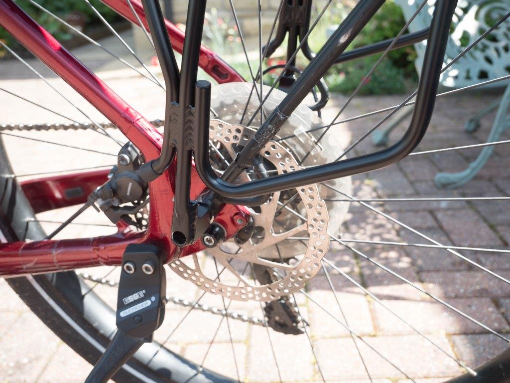

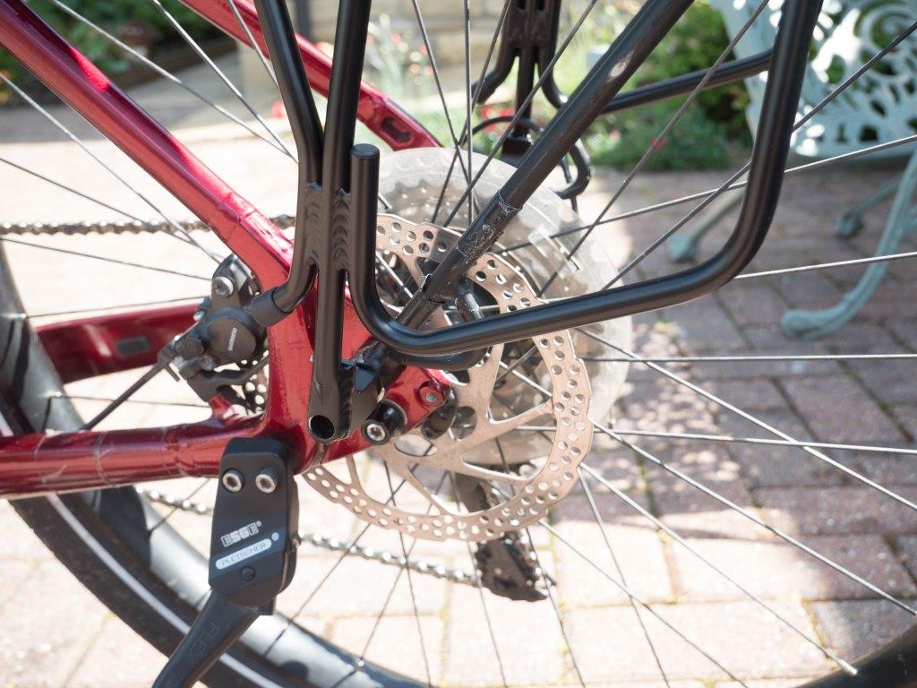

In the next bpic you can see the new rack mount sitting on top of the existing one. Although the rack mount sticks out quite a long way, it is mostly hollow so the replacement bolt only needs to be 10 mm longer rather than the 30mm longer it looks like will be needed. Also you can see that the new rack actually protects the gear cable, which the old rack didn't.

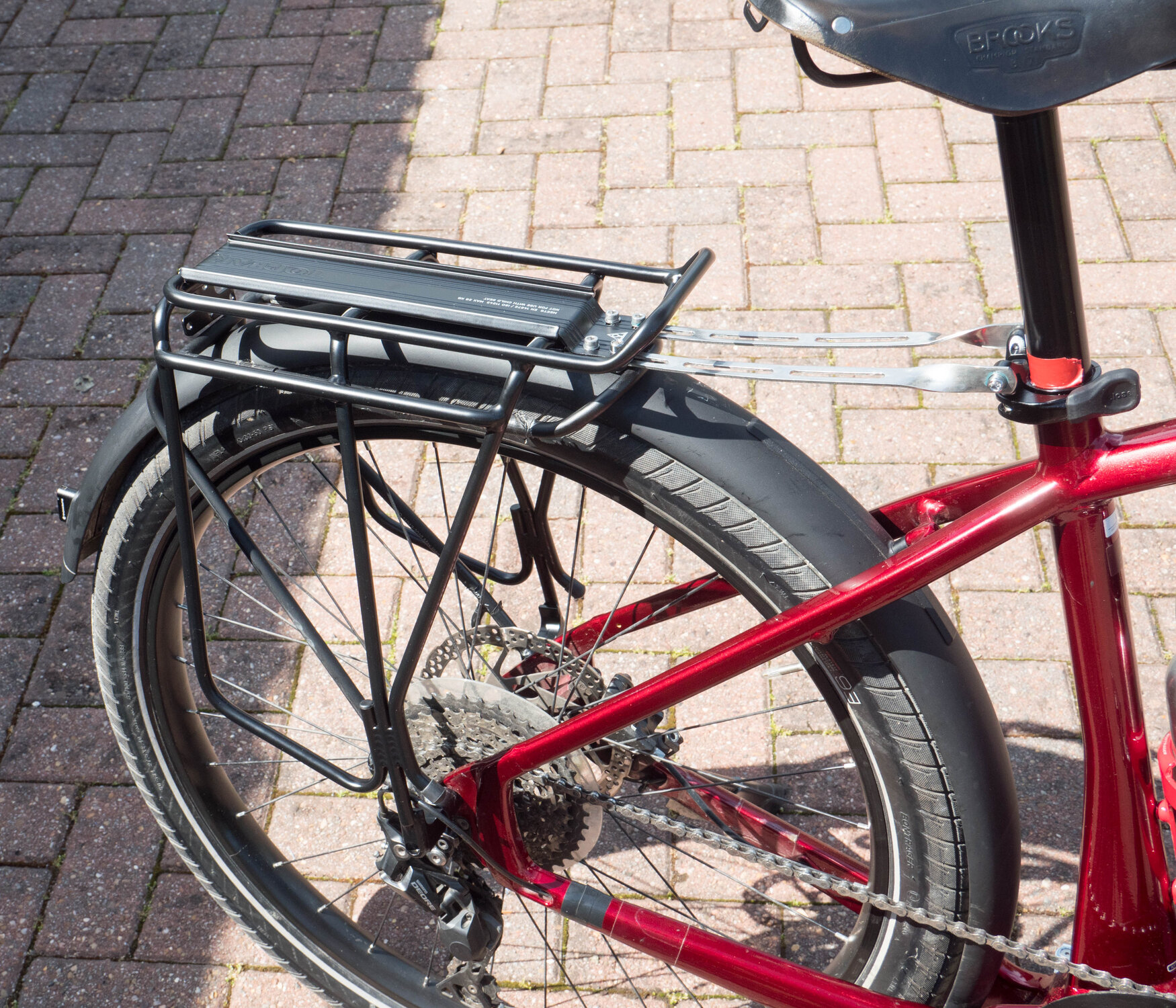

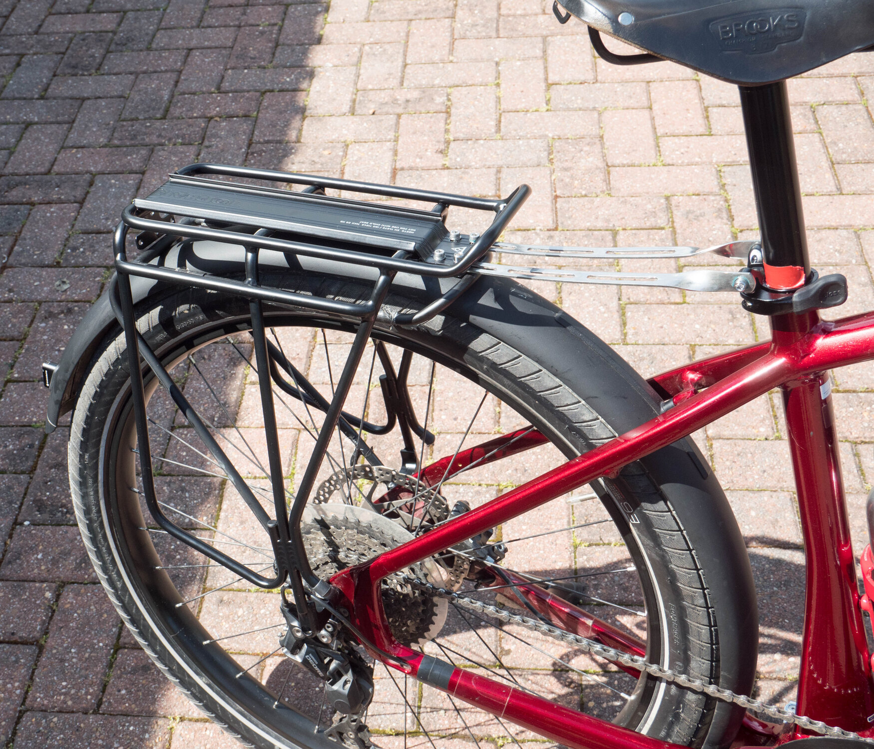

next pic shows the whole set up, with the topeak rack sitting above the existing rack. No contact points or other worries. Note that you need to replace the exxisting seat clamp with an eyeletted one (I ised the Bontrager QR one) to attach the rack rails to.
