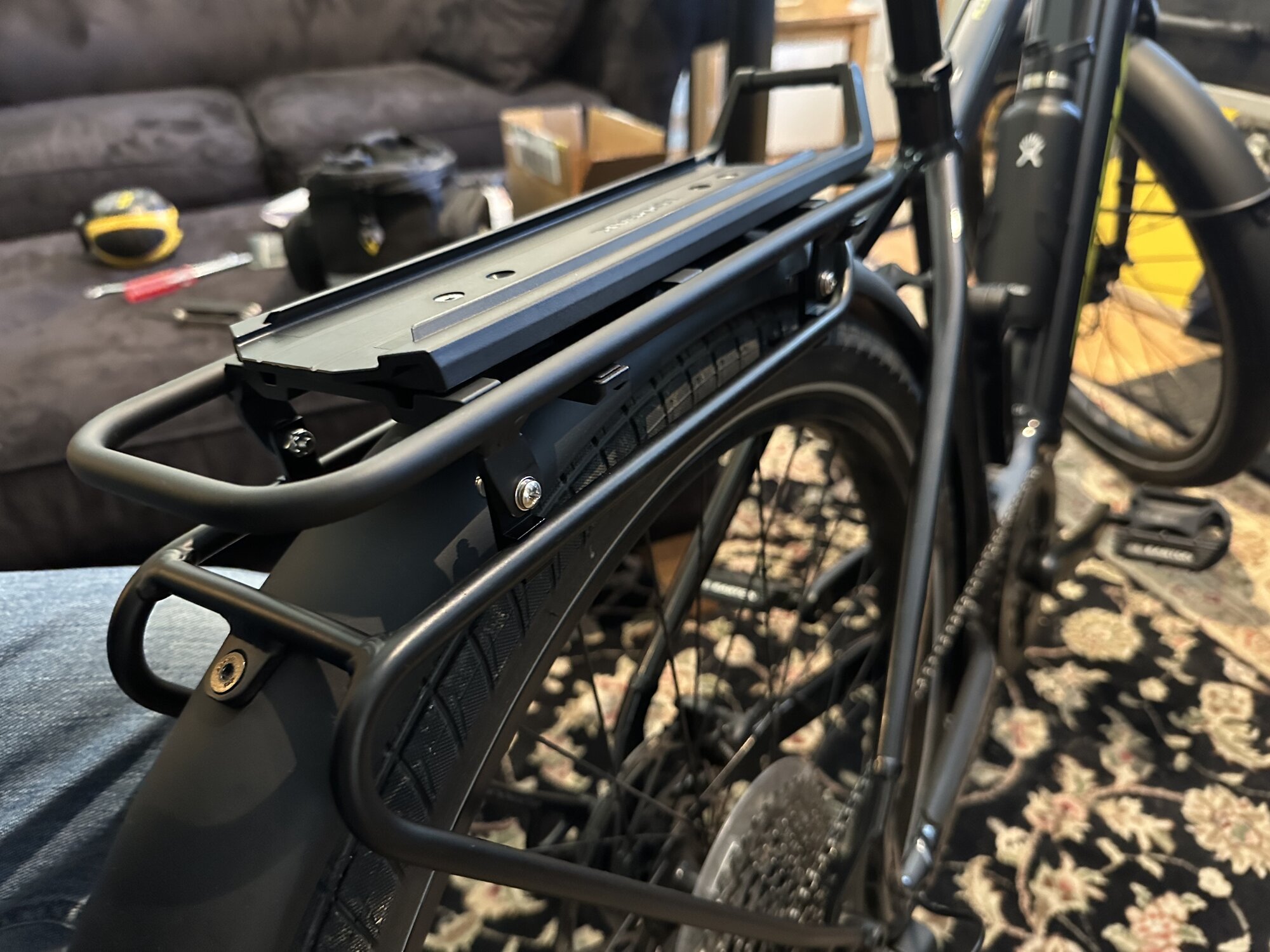

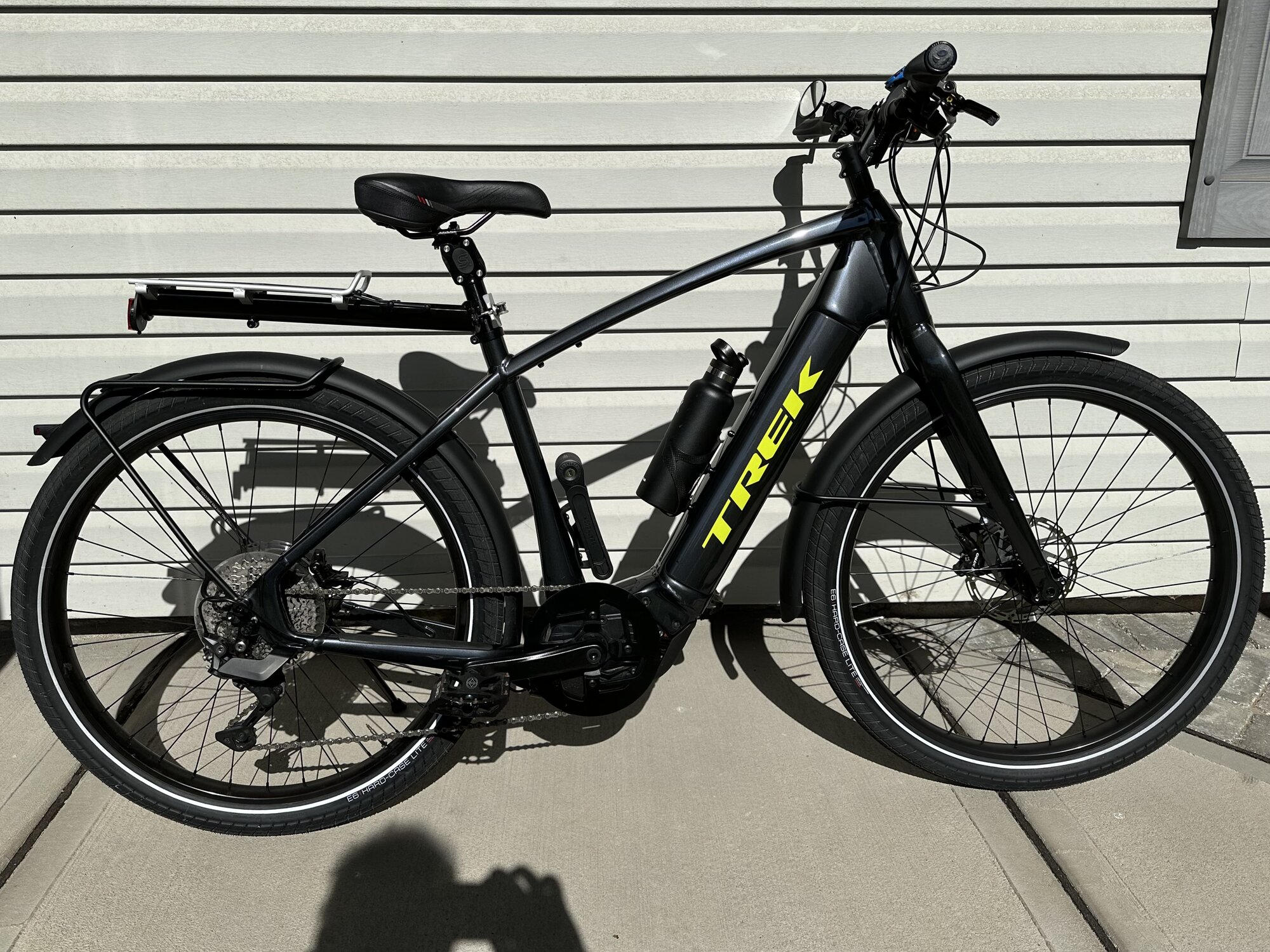

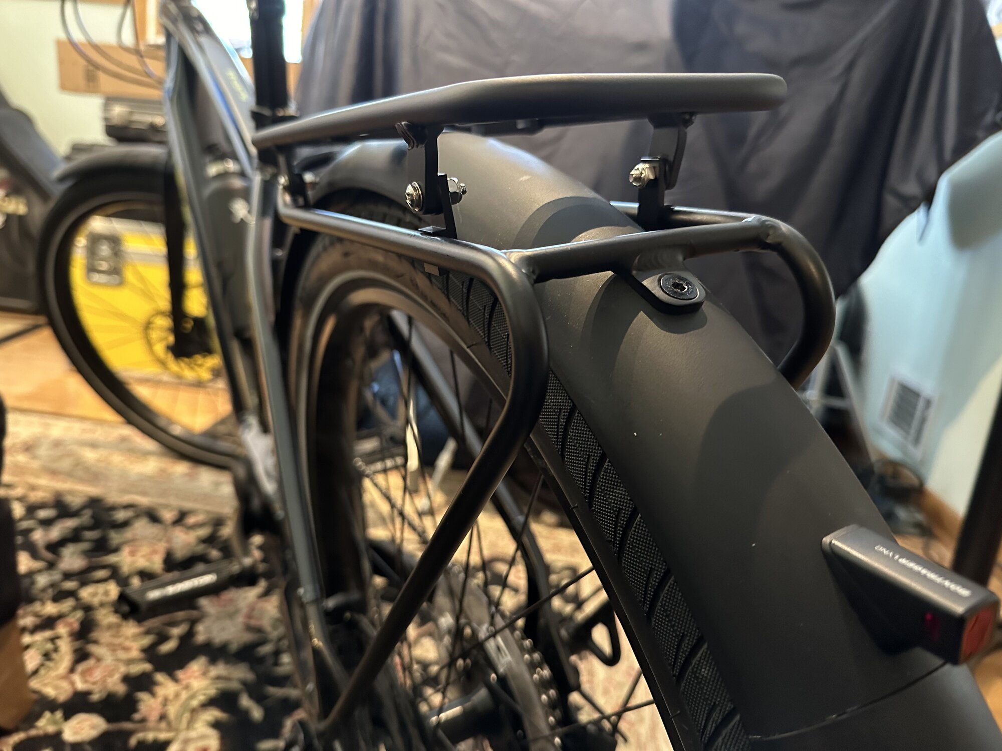

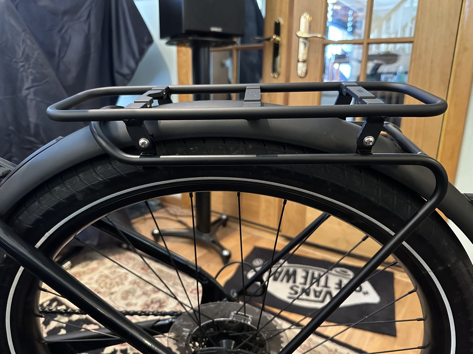

Heck, I just got one of these and mounted it above the existing rack on my 8. View attachment 105279
I NEED A PICTURE OF HOW YOU MOUNTED THIS RACK......I HAVEN'T FOUND A SIMPLE SOLUTION YET......DO YOU HAVE PICTURES?
HOW DID YOU MOUNT THIS ON YOUR ALLANT 8? I COULD SURE APPRECIATE PHOTOS OF YOUR MOUNTING SYSTEM ON YOUR BIKE!!!!
Just logged in after an absence... if you go for the rack a couple of us fitted, you can see pics for that at the start of the thread. Allows a much improved carrying capacity too.

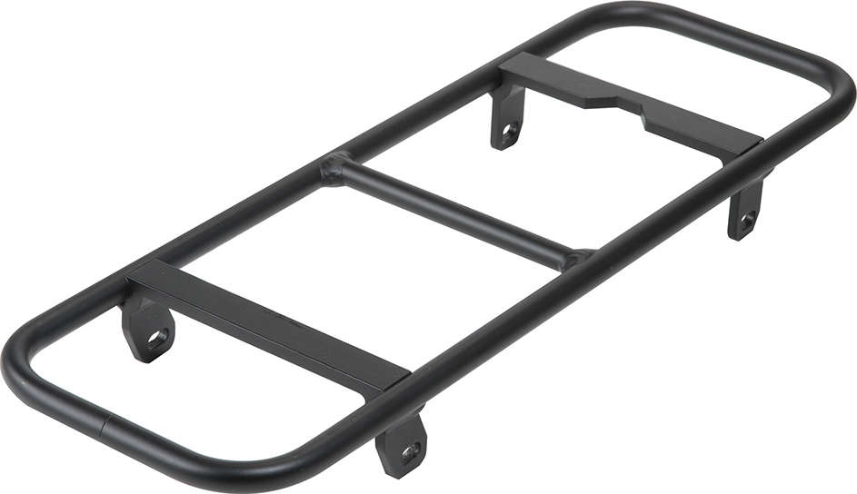

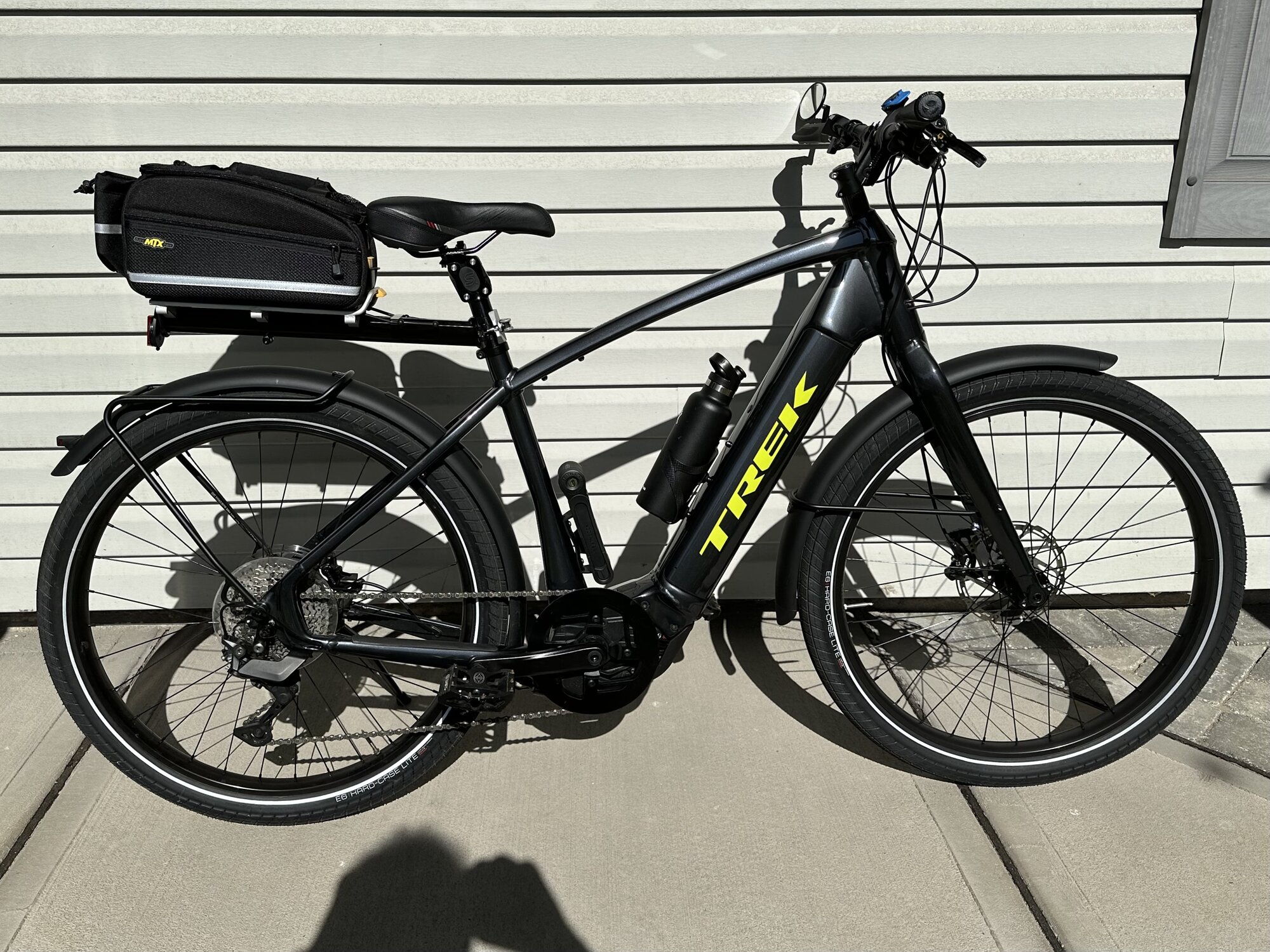

After looking at other's solutions and trying to think up a few of my own, I gave up and just bought this. https://www.topeak.com/global/en/product/136-MTX-BEAMRACK-(E-TYPE)
After looking at other's solutions and trying to think up a few of my own, I gave up and just bought this. View attachment 163995View attachment 163996

I just ordered an MIK System Deck from Giant with intentions of attaching it to the 8s pannier tubes.

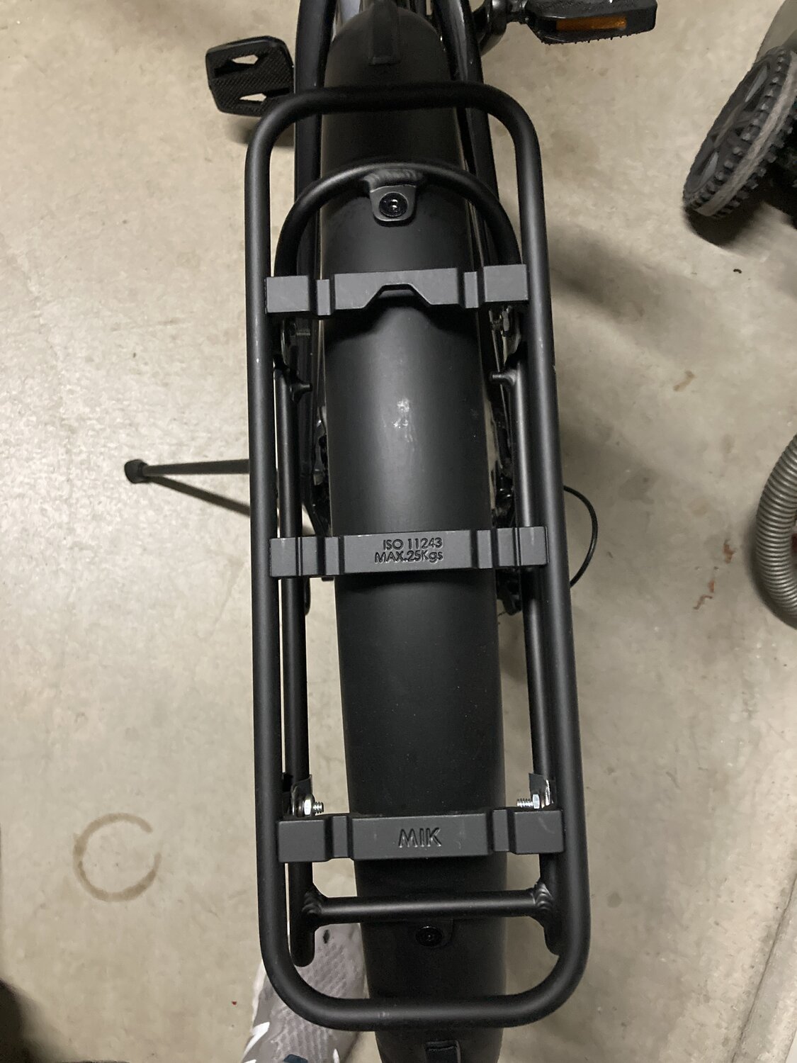

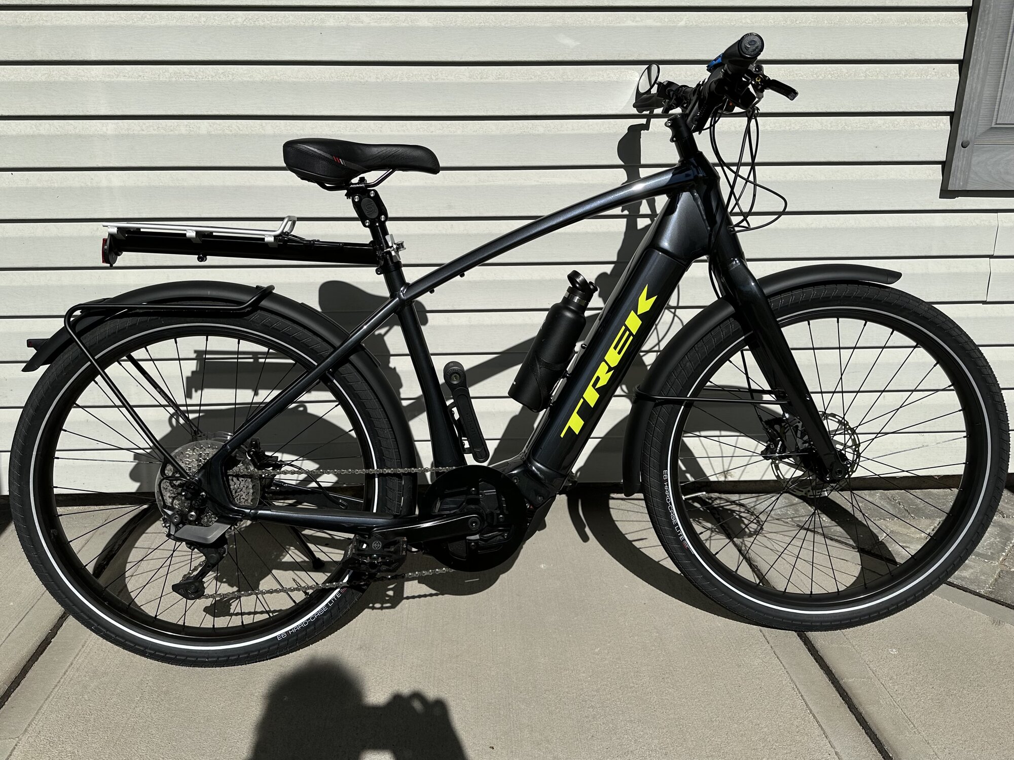

Why not just get a rack from a 7 and put it on the 8? That rack on the 8,9 makes no sense to me - can't put anything on top.
#offthewall is correct. Although the frame is identical, Trek made the parts nearly non-swappable. In theory, they felt panniers-only makes it a better commuter bike.

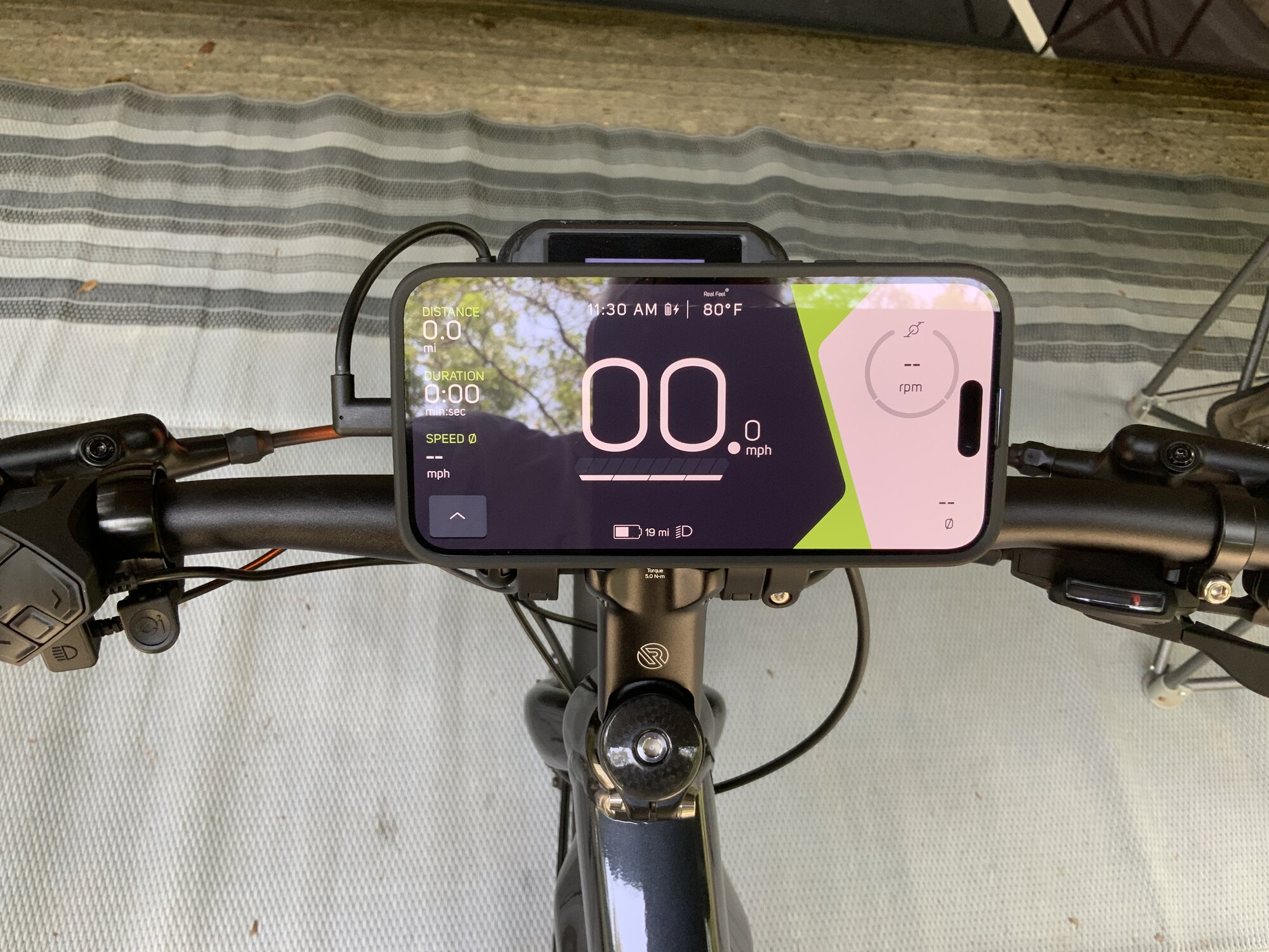

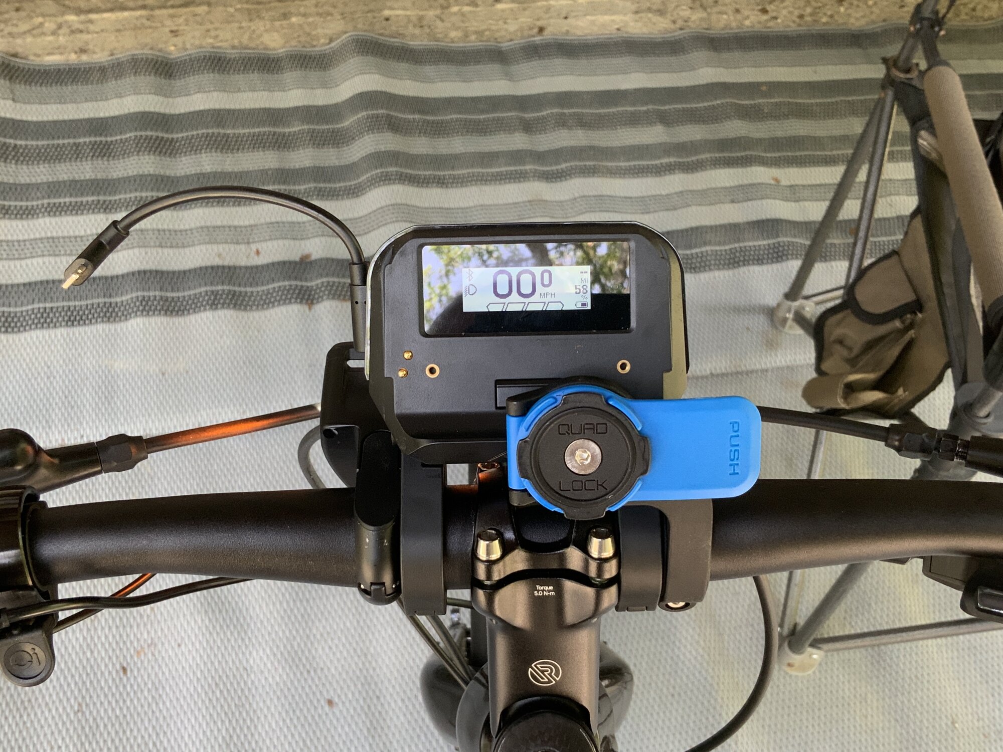

Maybe I’m not as picky (well I really am 🤣 ) but the only thing I don’t like about the Cobi.bike system on the Allant+ 8S is the junk phone mount.
Mine broke a couple of weeks in. I removed the mount, keeping the display and added a QuadLock Out Front mount for my iPhone. Perfect now.

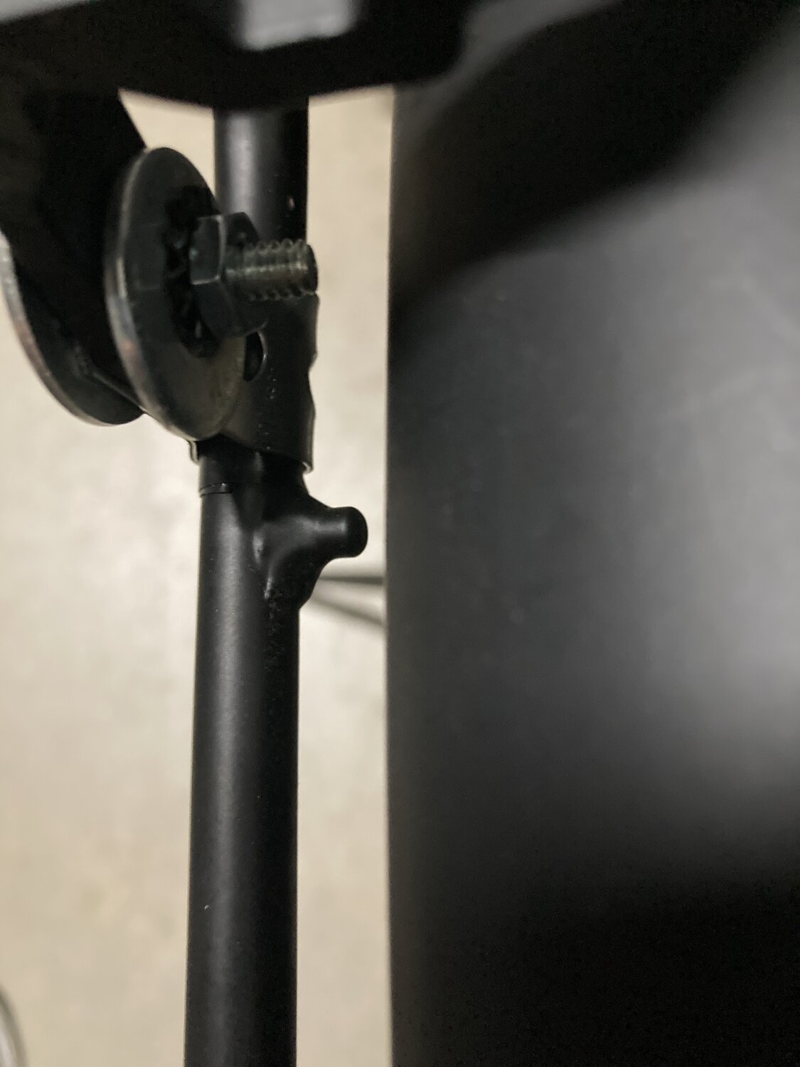

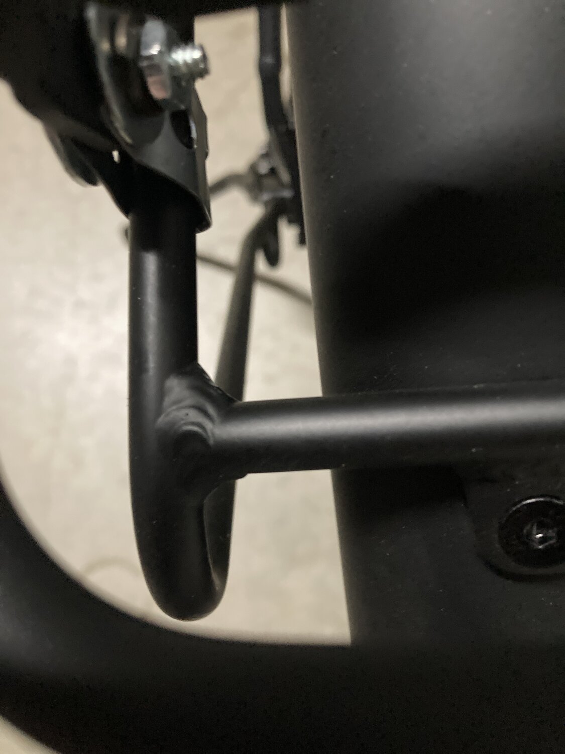

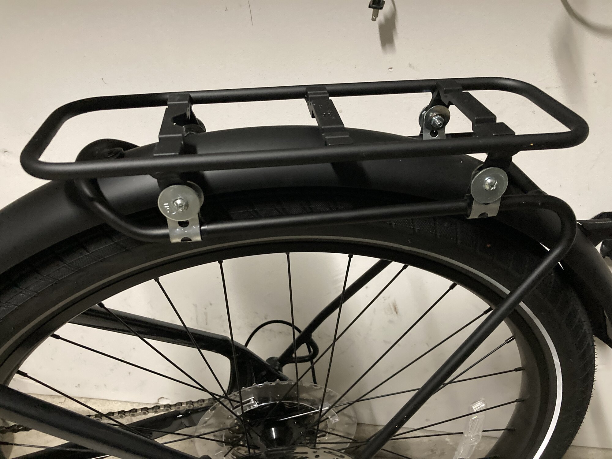

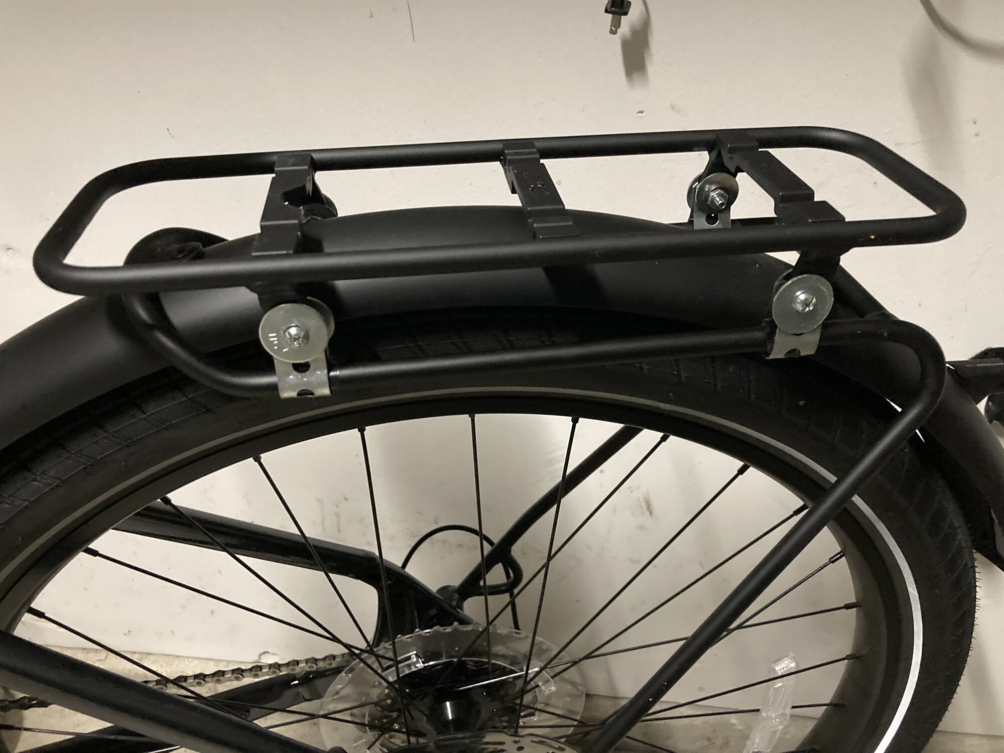

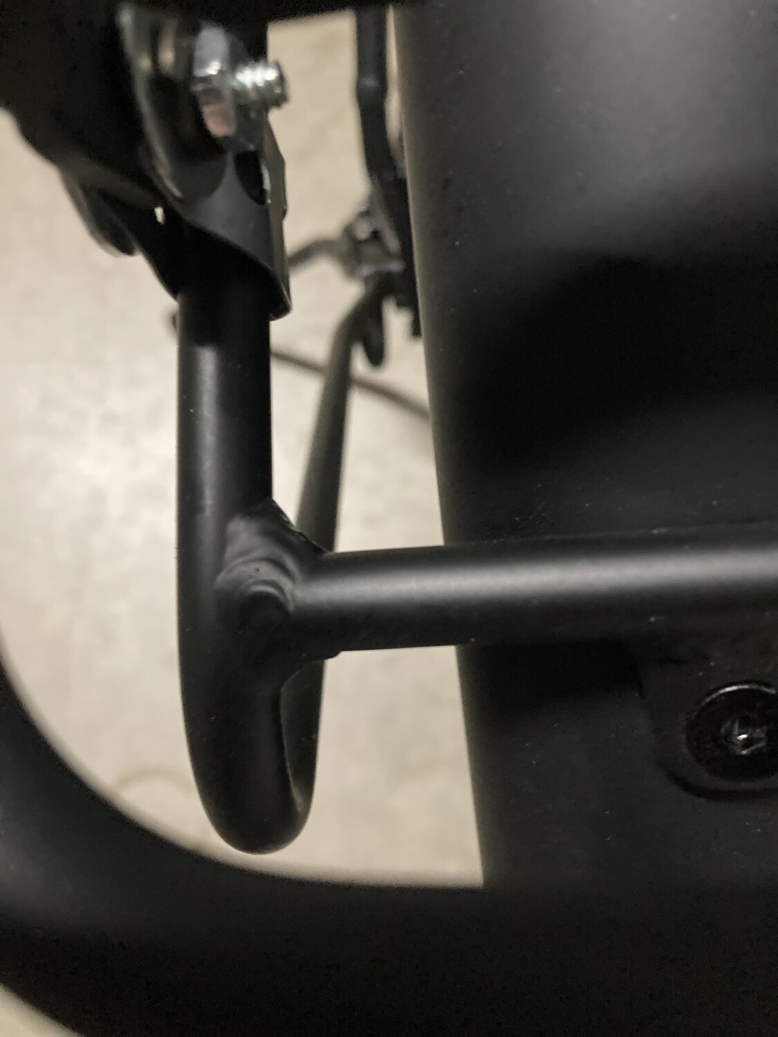

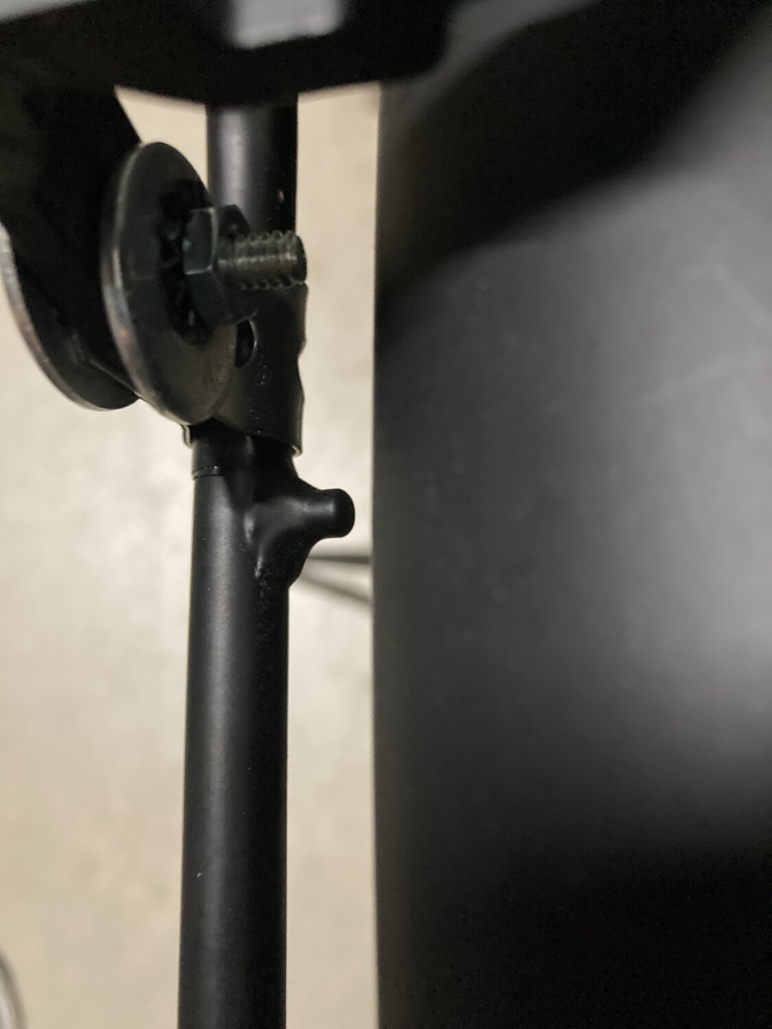

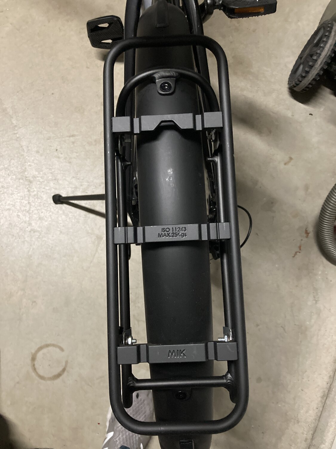

I copied retiredNH’s solution. The oversized washers are needed to compress the hanger strap around the pannier rack pipes.
Is that the “Giant MIK compatible rack”? Could you tell me if the vertical mounting tabs line up on center with the Trek’s rack or are they slightly inboard or outboard? Thinking of an alternate mounting system. Thx
The Trek rack is 4 1/2” outside width, the Giant MIK rack is 4 3/4” It also has those 2 nubbies on the inside I thought I could use but didn’t. Per pix I mounted just ahead of the nubbies.
Please share your mounting solution. Interesting to see.
Concur on the junk Smartphone Hub mount. I strap my phone with rubber bands. The first thing the Trek tech who built my bike advised me about the bike was don’t put the phone in the holder! It will fall out and break. A confidence building product endorsement that was.
Nice...my MIK top plate arrived today, and I will be doing the same this week. I will upload pictures when I am done. I got rid of the Cobi Smartphone Hub when I purchased the 8s in March, and replaced it with the Kiox aftermarket kit. It works great, and to be honest, this is the display that Trek should have offered on this bike in the first place. Silly rack, useless Cobi app..........
View attachment 164441View attachment 164440View attachment 164439View attachment 164442

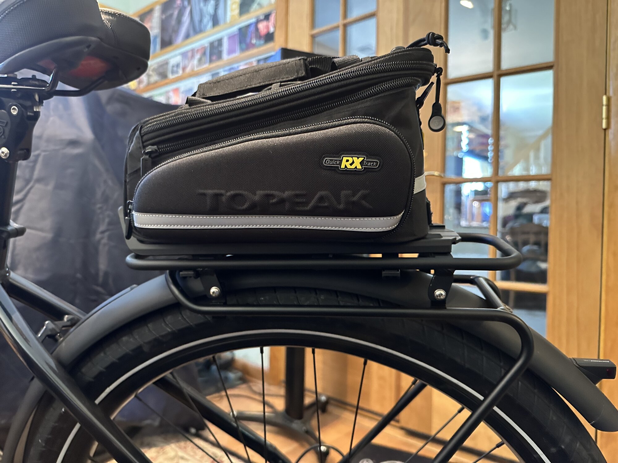

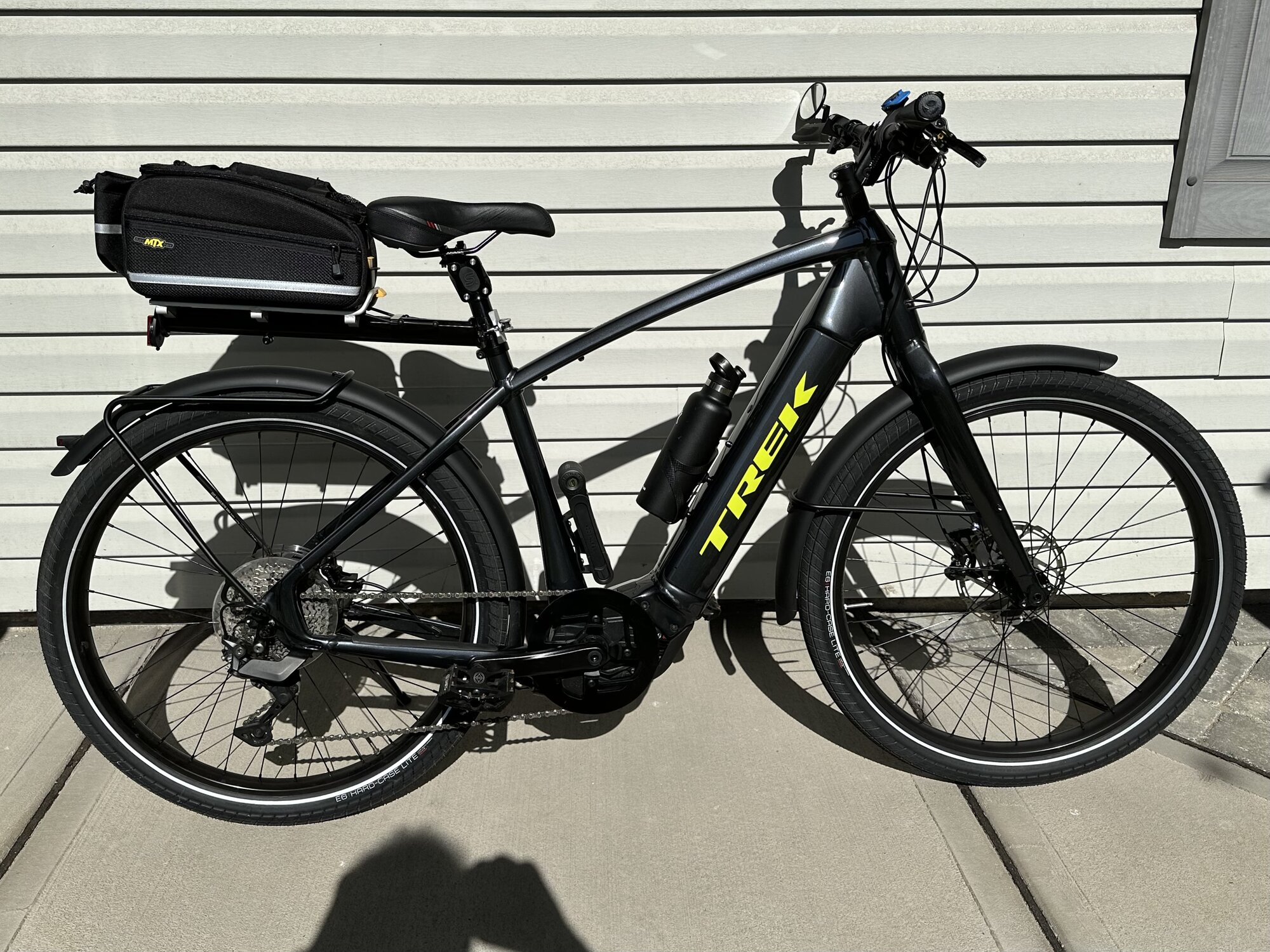

@Sparky731 This is what I wound up doing. I used the same Giant MIK rack and mounted it with 1/2 of these Billet Aluminum P-Clamps. I have Topeak MTX/RX bags, so I then mounted Topeak's platform on that. Pretty slick looking IMO. :)
