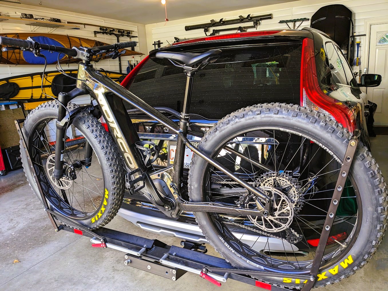

FWIW, 1Up also sells spacer kits to accommodate fat tire bikes up to 4.9” wide and they will also work with standard bikes. However, 1Up's new XTtreme Duty version rated for off road use can now fit tires up to 5.25”. The tires in the image are 3.8s but I run 4.5 studded versions during the winter months. NOTE: The original 1Up wheel locks are not long enough to span the full width of the spacer kit so one must either acquire the longer fat tire versions or use a standard cable lock to secure bikes to the rack.
Rival Quikrstuff rack will fit tires up to 5” without the need for spacers but costs more than the 1Up HD/SD versions. The name of the rack is a bit of a misnomer as the lead time in acquiring one is up to 8 weeks. Still, a quality product.

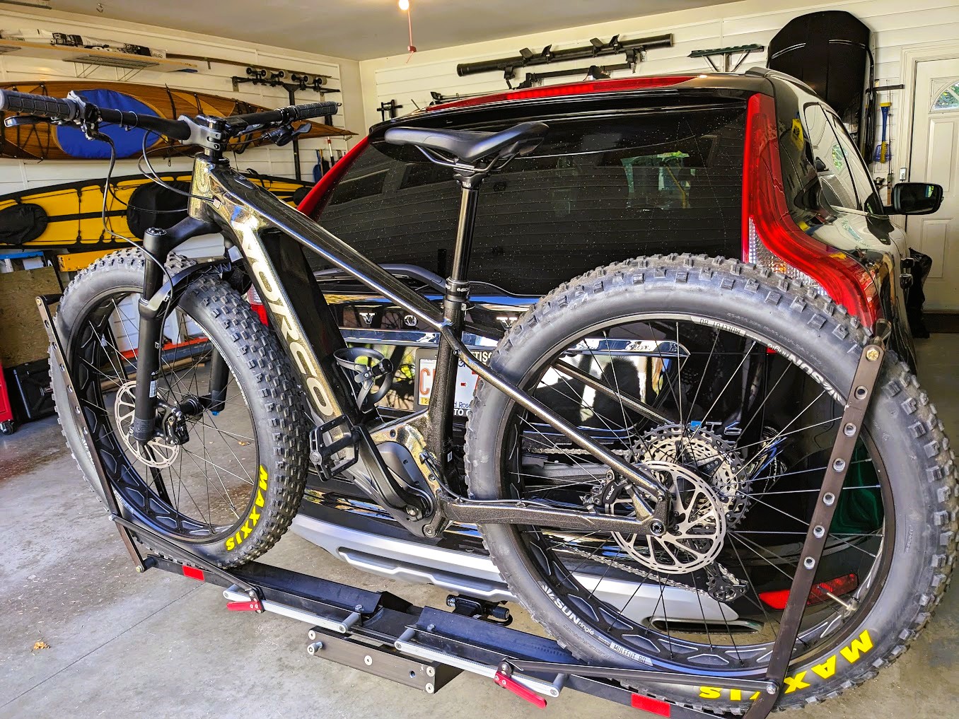

Prairie-How big of a PITA is it to change out my standard size 1.25 Quick rack and add the spacer kit for my Lectric XP (4 inch tires). I noticed the kit is only $38 US...
It’s not too bad. It took me about 10-15 minutes to swap out the wider spindles, guide bar spacers and end bolts. All of the hardware is included except the washers which get reused from the original bolts. I only have the one spacer kit so it might take slightly longer if you need to perform the task on two trays. You won’t need to swap back to the original spindles/bolts since the spacer kit will work with narrower bike tires. On our road bikes that are shod with 700 x 28/30c tires, we use the wheel savers which work exceptionally well.
I noticed that the current trays are likely wide enough to fit 4" tires but not sure about anything bigger than that. Guess I'll find out soon enough.
I guess I will throw the XP up on the current rack and see what happens! They are 4x20 inch tires...
Sounds good. Let me know how they fit. With the smaller 20” wheels, you may find that you'll need to lower the spindles down a couple of notches.

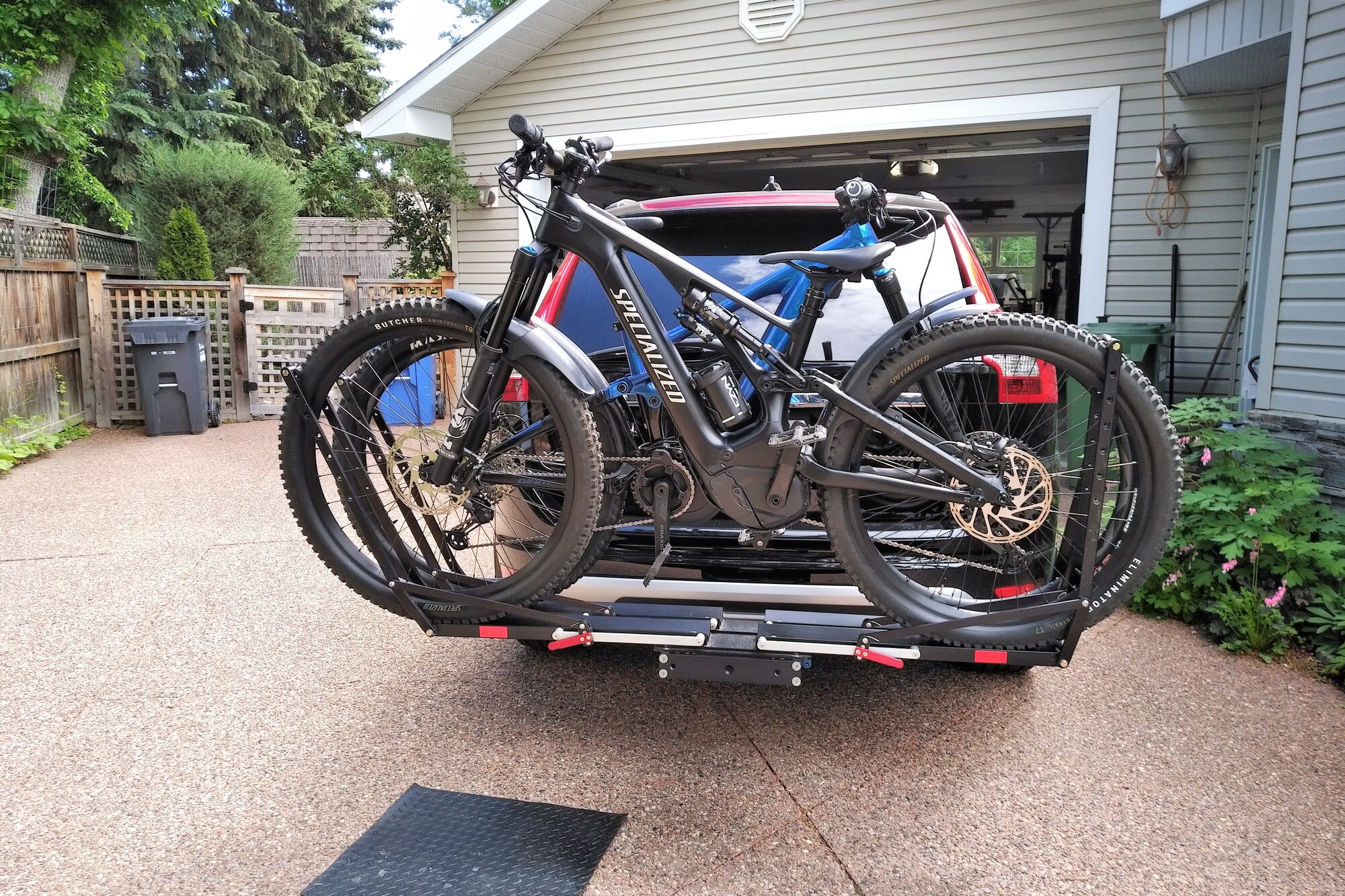

(5) 1UP-USA Super Duty Single:
For a single, the 1UP is probably fine, but for 2 bikes there are issues using the ramp for the second bike. Also, if your axle to axle distance is too great, you have to be sure the arms are ALL the say down, and even you've got to lift quite a bit above the tray.
And the locking mechanism uses a spring loaded arm that uses grooves in an aluminum bar, and those grooves wear quickly, causing the thing to jam or at least not slide easily.
It's good that the two bikes are kept as close as possible to the vehicle (don't want to over-leverage the 2" hitch), but that does mean you have be careful about seat heights and pedal locations, and like I said, does mean you can't really use the ramp to load the second bike.
I give the 1UP Super Duty a "B" rating for 2 bike usage, but maybe an "A-" for 1 bike usage.

I find that a bit of grease/lube prevents the metal ends of the bar from rubbing against each other and creates an overall smoother release. Over time, the amount of metal-on-metal friction along with trapped dust/dirt is what causes the bar to become more tenacious, sometimes on one side more than the other.
The only time that I used a tie down strap was when I placed transport covers over each of the fatbike’s wheels. Even though the rack arms and spools were still secured firmly down against each tire cover I did so just for my own peace of mind.
What’s nice about these types of tray style racks (unlike versions with fixed wheel holders) is that if you are transporting multiple rides, you can roll each bike along the trays to get the perfect fit and avoid having them touch each other.
I use my ramp on the opposite side for the second bike. Bikes are faciing opposite direction. I like my Super Duty 1Up.
Yeah, that helps --- if you have the room on both sides of the vehicle to have the ramp and space to roll the bike to it.
EDIT: Also that means one of the bikes has to be rolled on backwards. Not that big a deal, but can be a bit awkward.

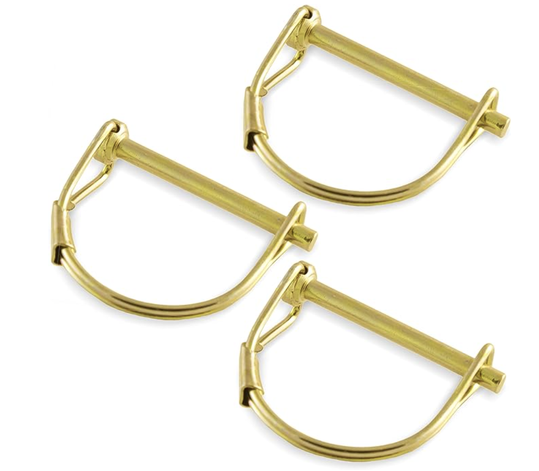

I also replaced the pins that come with the ramp kit since if they rotate they can actually fall out. I got these locking ones instead:
