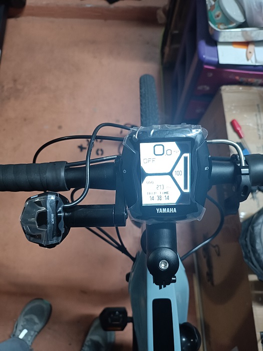

I am also a new Wabash RT owner. I have swapped out to the Display C, which has a USB port along with Bluetooth that Display A doesn't. It was an easy plug and play swap.
Yes, In the US, but bought from an Italian firm off of eBay. They offered it with the brackets as well. It took about 3 weeks, but worth it. I'm new here, so not sure if I can post the link to the item on eBay. He seems to have 2 left.
Ok, then here is the link. He says 2 available, and 3 sold. It comes out to €200 (about USD 205) including shipping to the US. https://www.ebay.com/itm/186841232293
It took me about half an hour to swap out. I removed the battery, then the hex bolt that covers the cable that goes into the downtube, just unplug the old one, and plug in the new one. I also assembled most of the mounting pieces before making the swap, and just needed to attach to the handlebar the display and the buttons.
