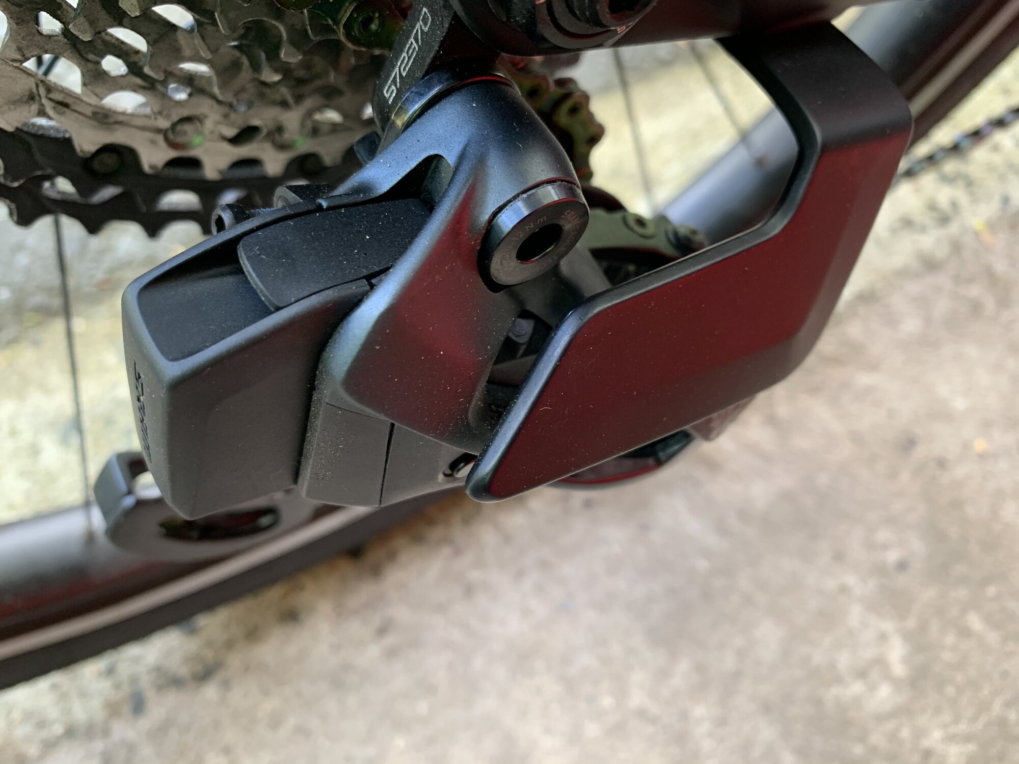

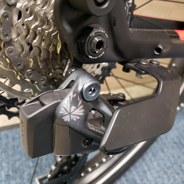

For you Allant owners who are upgrading to the Sram AXS wireless system, a note about the derailleur guard that came with the Allant. The AXS derailleur is bigger than the stock Shimano one. The bike came with a very nice guard for it but the AXS does not fit behind it as installed. Joseph, the head mechanic at the Trek shop who does all the work on my bike, cut out, drilled and painted a little adaptor plate from 3/16 aluminum stock to mount the guard outside the AXS derailleur. If your guy did not do that, it would not be too difficult a DIY project or take it back to the shop that did it and show them these photos.
For you Allant owners who are upgrading to the Sram AXS wireless system, a note about the derailleur guard that came with the Allant. The AXS derailleur is bigger than the stock Shimano one....
It seemed, from watching the videos, that one of the benefits of the SRAM is that it self-aligns and is very resilient to taking hits from rocks and what not. It is designed to take an impact and will reset itself. If this is true, is the guard necessary? Particularly for road riding?
I just went out to the garage and looked at mine, and it's the OEM guard and it works/looks fine. Pictures to follow.
The Sram does have an impact relief clutch that allows it to take a hit on the outboard side and collapse inward and then pop back out...a really cool feature. The bike came with the derailleur guard, a rather unique add-on. I figured at least it will keep the paint and finish on the derailleur looking better and might actually save it from a hit that surpassed what the relief clutch can handle.

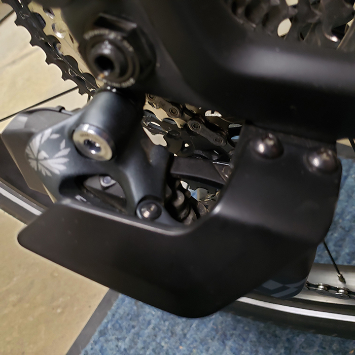

My OEM guard works fine (photo attached)View attachment 51973
looks like you got a different, lower profile derailleur than mine. I got the x01 and it appears you got the xx1 which is a bit lighter due to paring down and carbon fiber components. Nice that it fit behind the guard with no mods needed...oh well. Now we just need to know if the Onyx classic is available to configure on our bikes without replacing everything else. I assume @JonVonGod is waiting for a response on Monday.
