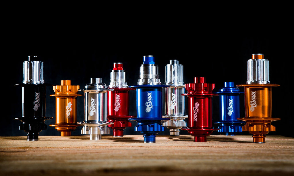

Probably the best hub option for compatibility with the 12 speed shimano system are the Onyx hubs which are silent, have instant engagement and minimal drag (and cost $445).
I have Onyx hubs on my Moots Rogue YBB and they are awesome. Completely silent and super sharp engagement.
