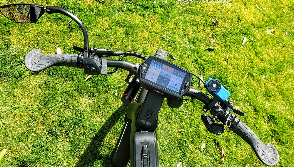

Glad you found my mods usefull. FYI, the city model Baramind is their narrowest. I like the sweep back angle and the rise but I found that I liked the Sqlab grips mounted slip out about 3/4" on the bars to give a bit more leverage and also provide a skosh more cockpit space. Given how the grips clamp on the inside rather than the outside, I gave that a try. I guess it is not entirely kosher to install the grips that way but I could not see any harm in it and it makes the Baramind City about 1.5" wider which felt just right to me.
Also you might note where I mounted the AXS controller inboard from the brake clamp and the Knog OI bell. That got it out of the way while wrapping my hand around the grip and eliminates unintentional shifting. It also made it ergonomically easier to put my thumb on the switching surfaces. (inboard from the controller is the button for a little USB chargeable horn (visible just under the lower right corner of the Nyon).
