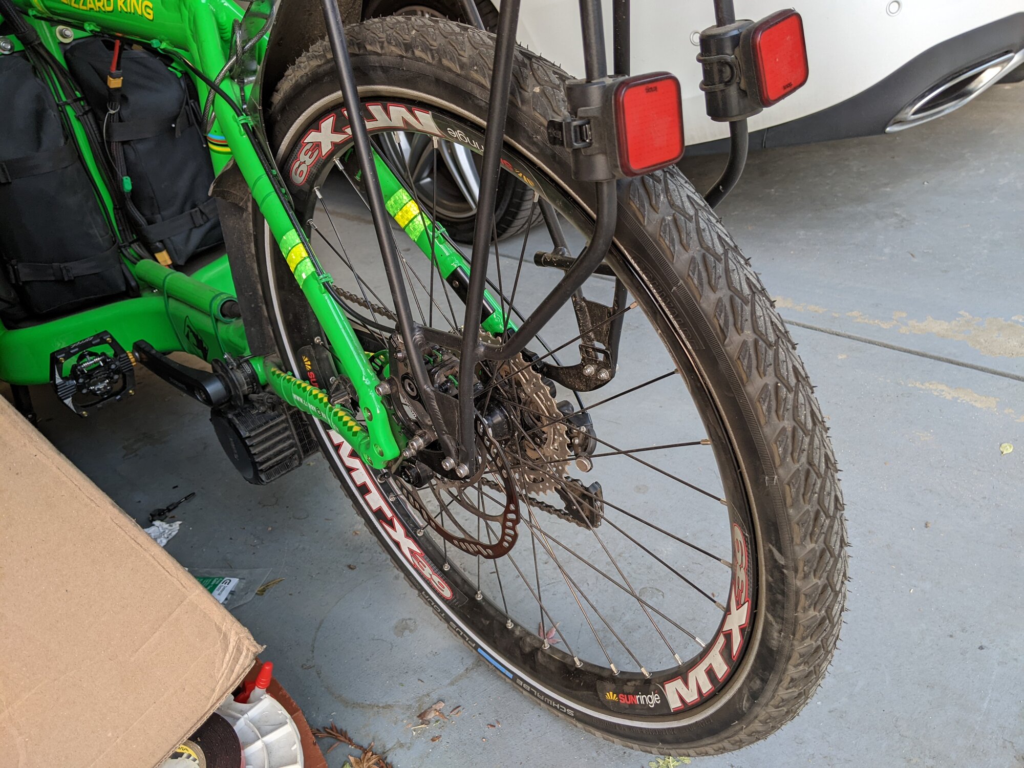

However... I am getting no flats and haven't in months. Its usually a combined effort between a sealant, a thick inner tube, Tannus and a belted tire (layers, Donkey!), or if the tire isn't belted, do all that stuff and add your own (Tuffy). OR if your tire set is tubeless, just use a badass sealant (FlatOut) that can seal stuff no matter what it is so long as the tire casing holds its integrity.

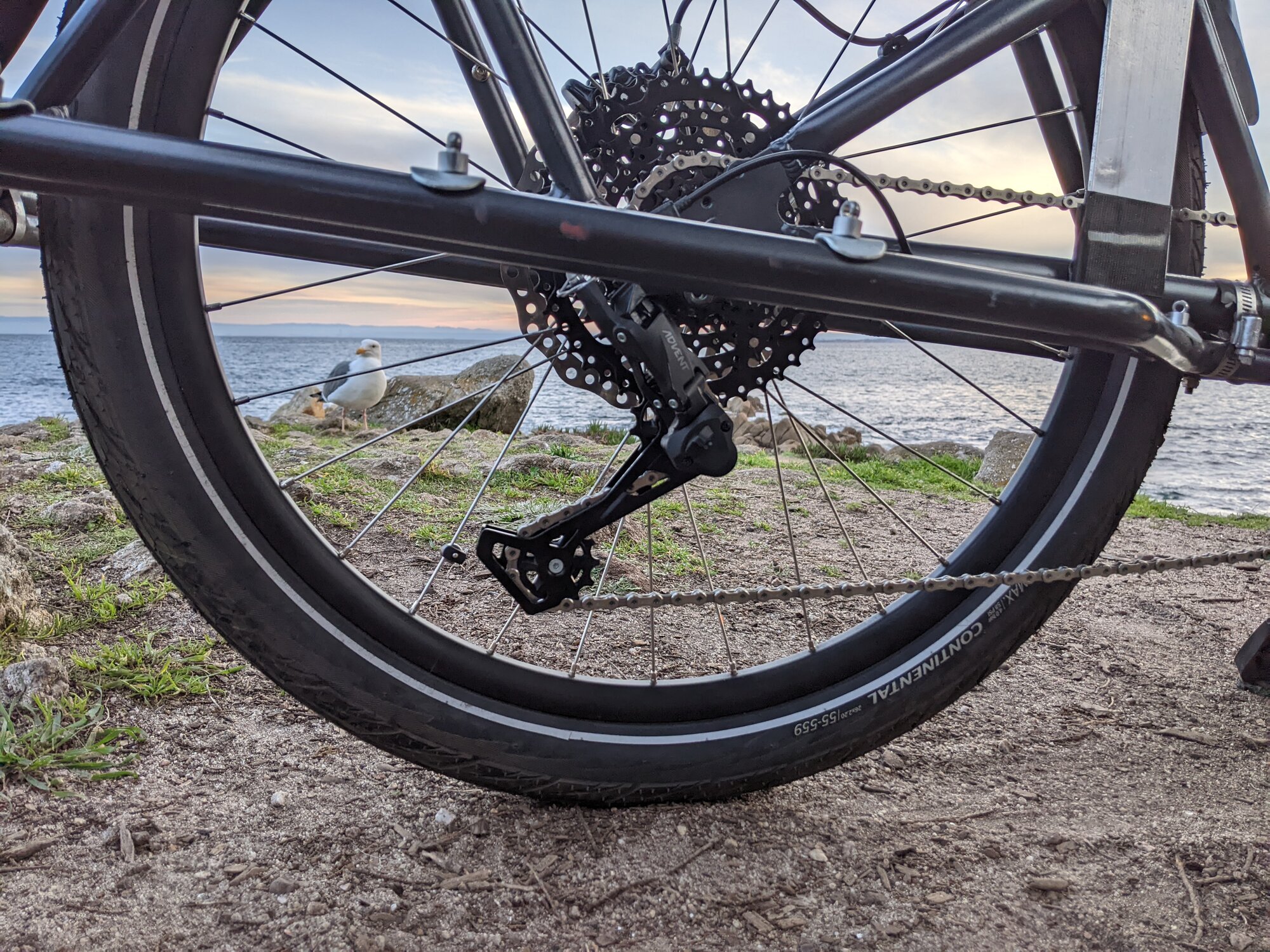

Schwalbe Marathon Plus - pretty much what the majority of the cargo bike community rides. This is the tour version I put on for the winter and it also has a nicely increased load capacity over the standard Marathon Plus I use for three seasons of the year. An oversized thornproof tube is underneath with a full load of Flatout inside. No flats since I built the bike over a year ago.
Continental Contact City Plus - a cheaper Marathon Plus clone from Conti. Super thick belt inside of it. Thornproof tube with Flatout inside, again. No flats since it was built in October of 2019. This pic was taken a couple of weeks ago and I'm temporarily back to my original wheels due to a broken spoke....

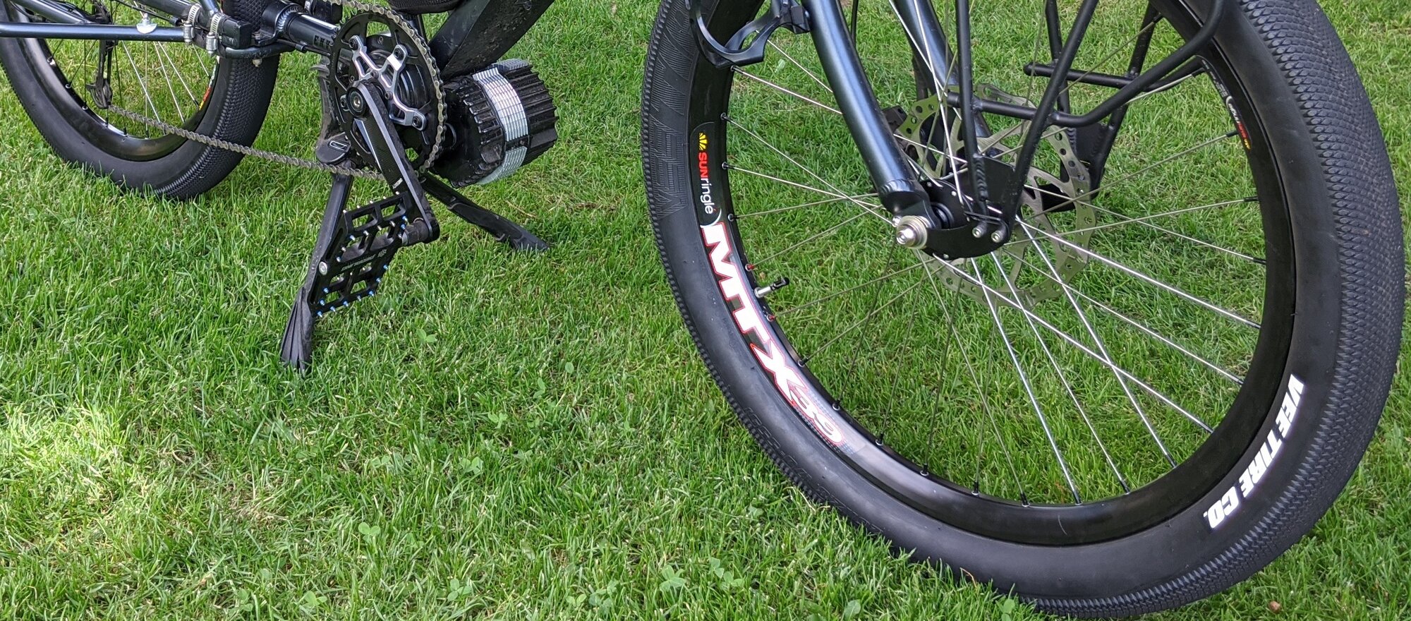

When that spoke gets fixed, I will be using these again: Thin but poofy/comfy Vee Speedster 26x2.8's. No flat protection in the tire, but underneath: Tuffy XL, then under that, Tannus Armour 2.5" (a little undersized), under that a thornproof tube (35 psi tops) and inside the tube, Flatout. And again... no flats on this bike since 2019. The Tannus will be a new addition that I'll be adding for the first time on this wheelset.
