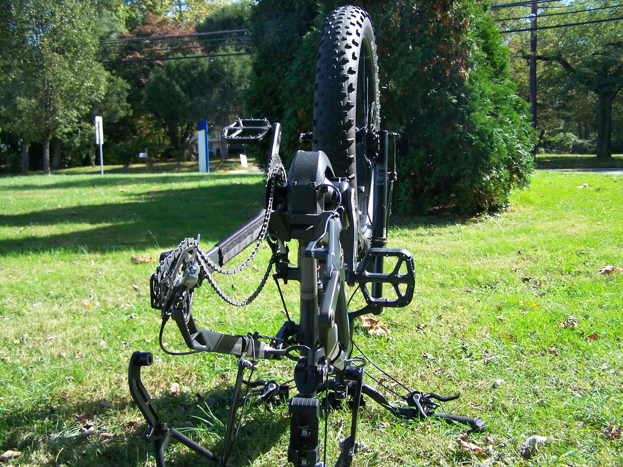

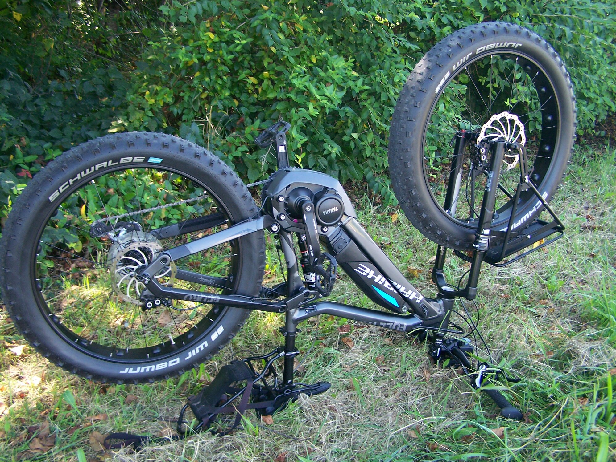

You learn pretty quick what needs to be done in fixing a roadside flat: remove handlebar bag, LCD display; rear bag(s), put rear cassette gear in highest gear (smallest sprocket); shift front chain ring to granny gear, disconnect rear rack (not pictured here) from rear thru axle. Find a shady spot, preferably grass. Put towel under saddle to prevent wear of seat cushion. Watch for ticks....

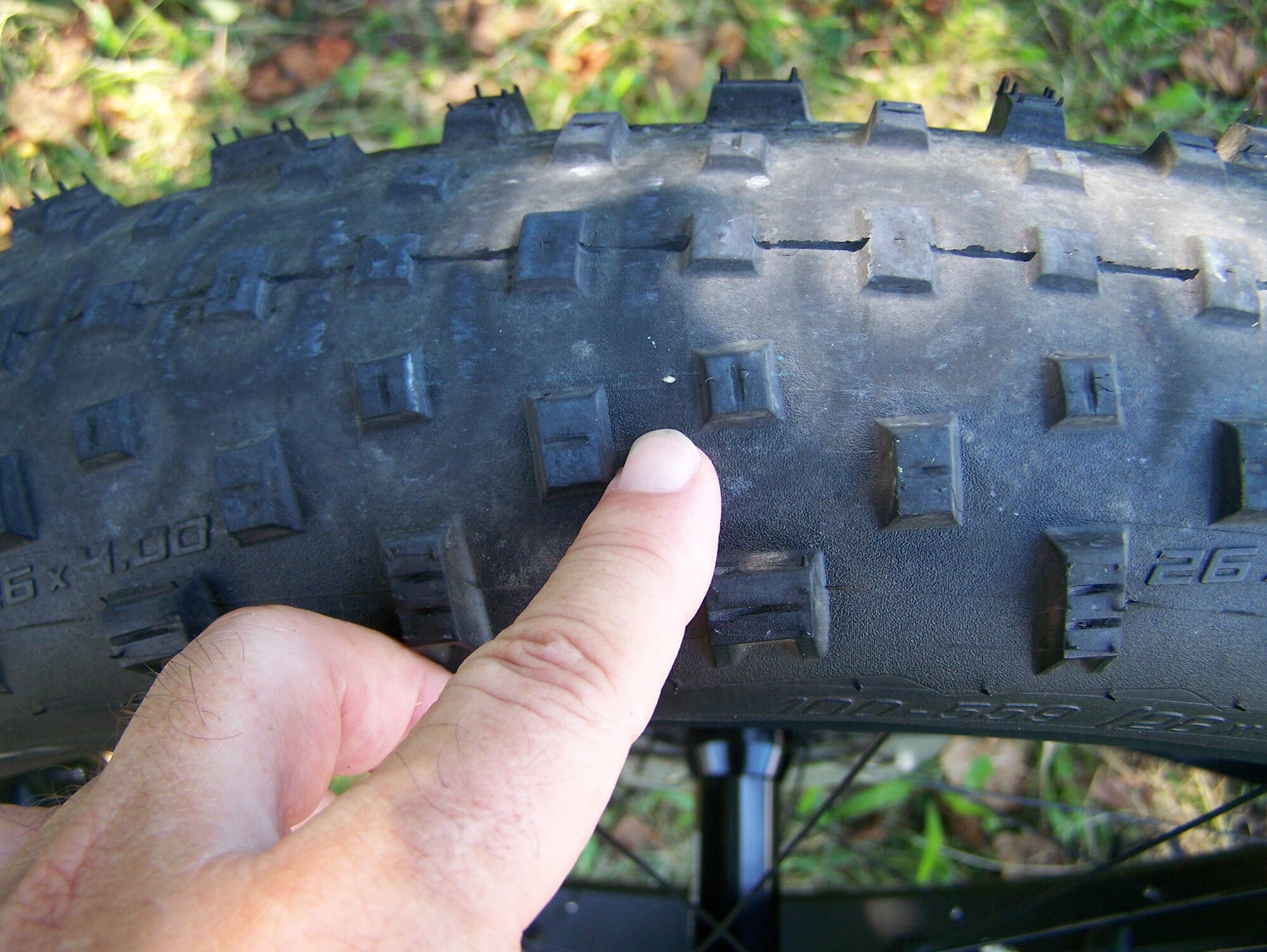

Alot of grief over that little white dot, which turned out to be a quarter inch thorn I picked up on the shoulder of the road. An asphalt shoulder. And that tiny thorn also pierced the Mr Tuffy Liner that I was using on at this time. In my thousands of miles riding first a Specialized Fatboy, then this Haibike, those little white dots have been the cause for a lot of grief on my rides.

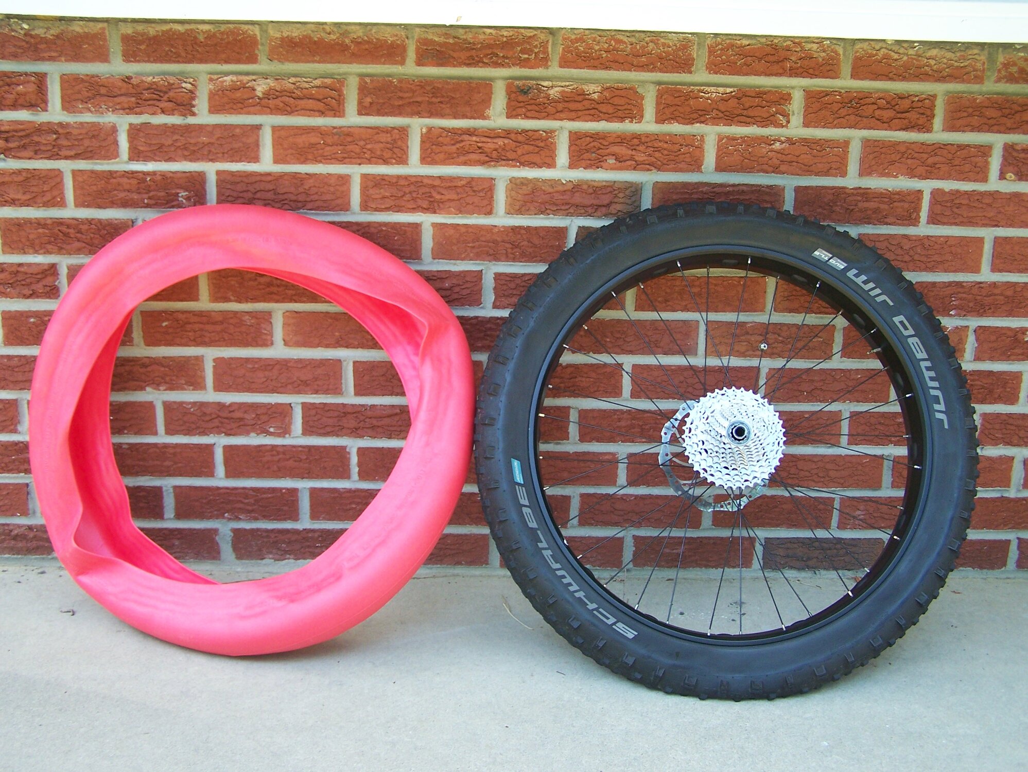

Tannus Armour was ramping up when I went all-in with their tire liner system. I was skeptical, especially after looking at the small tube they include with their fat tire liner system. But, it does work...

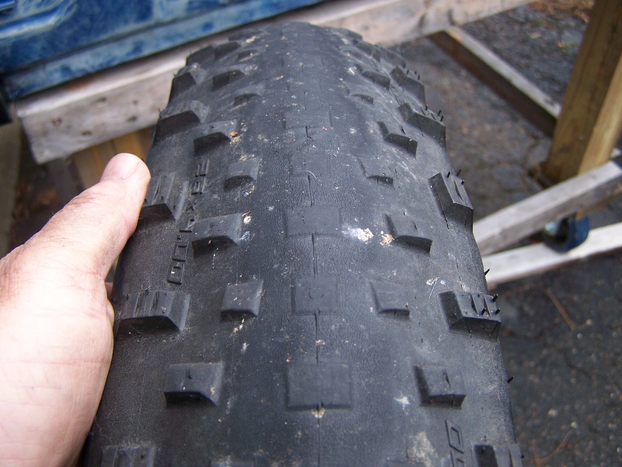

October 2020 had another roadside flat repair as a 1/4 inch thorn pierced the rear tire, T/A and pricked the tube ever so slightly. As the tire was going flat, I remembered the Tannus boast of riding on the flat with that liner. Maybe so with a small 700c tire but certainly not with a fatbike tire. I did not want to risk bending the rims, so I just pulled over and went about patching the tube. These fat tires look cool and all. They move easily and roll very nice. But their profile presents over 75% of tire contact patch more than what the commuter crowd shows with their contact patch. The odds are so much greater to get flattened out. But you do build up those tire patching and fixing skills.
That flat in October 2020 was the last flat I've gotten on the Haibike Full FatSix. I estimate some 5 thousand miles later on that rear tire, we come to this, a severely worn rear flat tire that was replaced with a new Schwalbe Jumbo Jim in December, 2021. That is a personal record for me and still am floored that actually happened.The trick to this longevity? What alot of you folks have figured out: staying mindful of the debris in the shoulders in which you ride in. Riding more on the white line when it is safe to do so. Taking care when riding off road to avoid dropped small tree branches, especially thorny locust trees. Not going off trail, where alot of thorny plants reside. And a ton of luck. Especially that!

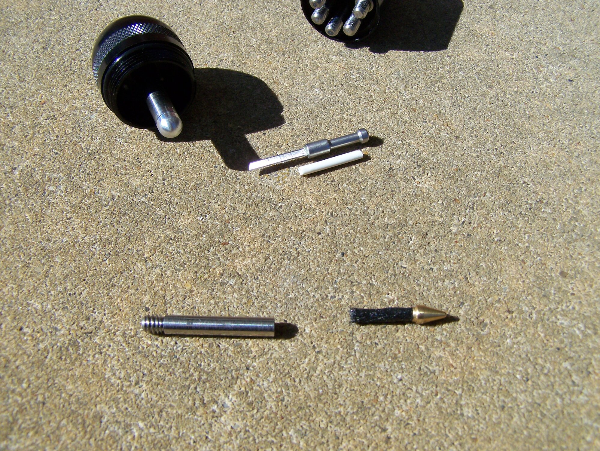

I run a light fat tire setup and Orange Seal sealant. I carry a home made tire plug kit consisting of regular automobile tubeless tire plugs plus some of those plugs cut lengthwise to make smaller diameter plugs. You would think that when the plug wears down flat and even with the tire that it would push through very easy but that is not the case. I have put as many as three automobile size plugs together to fix one hole the size of my finger and run the tires until replacement. When the tread gets low the tires flat easier. I had one set of Jumbo Jim's that looked like a porcupine with plugs. This system has yet to leave me pushing the bike in 25,000 Km.
