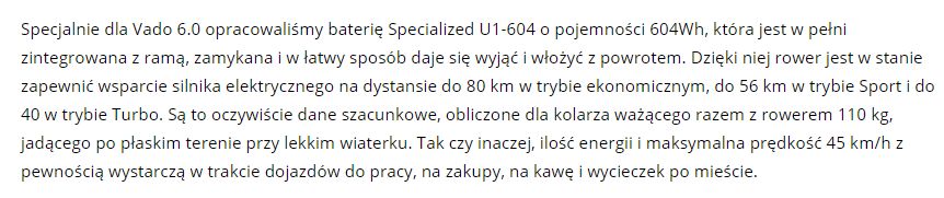

That's what Specialized wrote on their Web site before:
"For the Vado 6.0, we developed a custom 600 Wh battery that seamlessly integrates into the frame, is lockable, and easily removable for simplified charging.
Thanks to the battery, the motor can assist the rider up to 80 km (50 mi) in Eco mode, up to 56 km (35 mi) in the Sport mode, and up to 40 km (25 mi) in Turbo mode. These are of course estimated values for the total weight of the rider and the bike of 110 kg (240 lbs) riding on the flat with weak wind.
In other words, and with the maximum speed of 45 km/h (28 mph) there's plenty of juice to take you to and from work, a trip to the grocery store, or even to that new café on the other side of the city."
/I found this older text in a Web site of a Specialized dealer who has not updated the wording yet/
I was cheated. Yes, the Vado 5.0 is a nice e-bike yet the real range is frustrating, especially as a spare battery costs $1000 (It is $500 for Lovelec).
(I attach the 2019 Specialized advert for Turbo Vado 5.0 as the proof, unluckily in Polish. I have found it only now).
