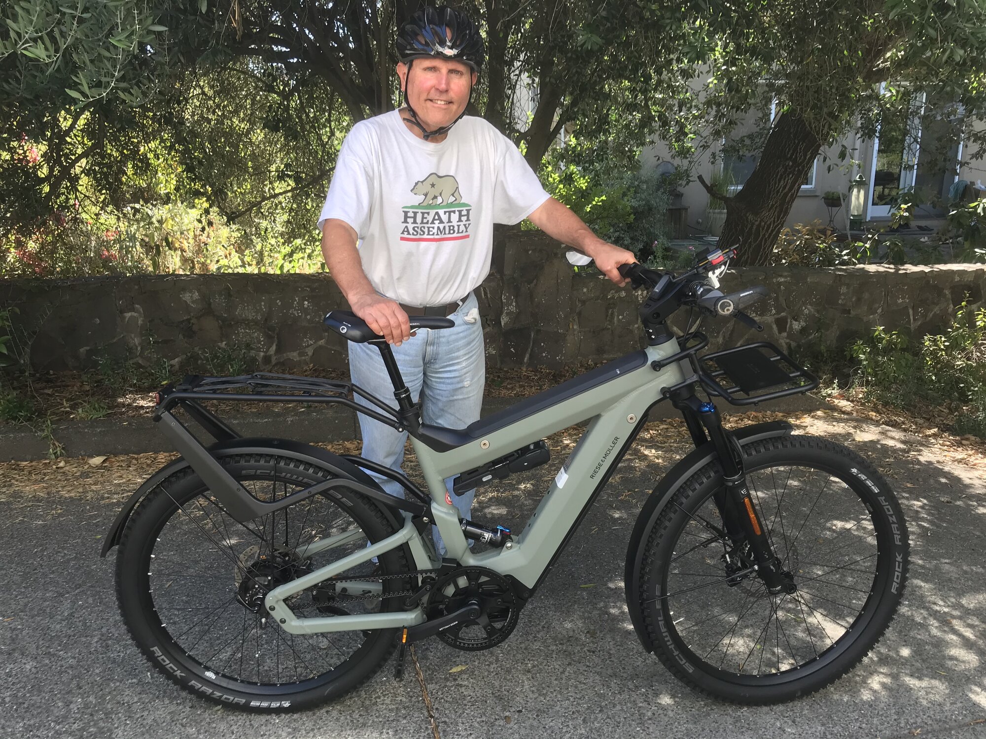

About a week ago, I finally received my Superdelite with the vario belt gearing, GX, and smartphone hub. My intention was to use this about 50/50 for touring and riding on fire roads (sometimes quite steep (30%+ grade) and occasionally quite rocky (with ~6” - 8” diameter rocks). I’ve now ridden about 100 miles with the bike, and have some thoughts about my initial post with regard to gearing and Vario vs Rohloff as well as some other posts about the smartphone hub.
Note: I used to ride a mountain bike regularly in similar terrain that I’ve taken the superdelite — one of my knees wasn’t appreciating the torque, so I decided to make the investment in an e-bike with long range potential (1125 wh on the superdelite) and front and rear suspension.
1. On several occasions with perhaps a 35% grade on sometimes narrow trails and other times fire roads with large rocks, I’ve had to get off the bike and push it up. The first time I did this, I hadn’t discovered the powered walk function. The second time I did discover that function, but it didn’t help much. A heavy bike and pushing it up a steep grade wasn’t easy (I’m a pretty fit 72-year-old). If I had it to do over again, I would probably have ordered a Rohloff gearing (or simply the standard chain drive).
2. On fire roads with 25% grade or less, I’ve very much enjoyed the bike. I’ve also appreciated the bike on steep paved roads, of which there are many in the Northern CA area in which I live.
3. On one occasion when trying to navigate up a steep/rocky firewood, I crashed. Cut my knee (not terrible), mirror broke off, water bottles dislodged, but my trusty iPhone stayed on the smartphone hub and was undamaged. In order for the iPhone to fit securely on the hub, I removed the case. Turned out to be a good idea.
4. Overall, though a mixed review, I figure that I’ll accommodate to the bike’s capabilities — less ambitious grades and trails and more touring through interesting country on fire roads, roads, and bike paths.
