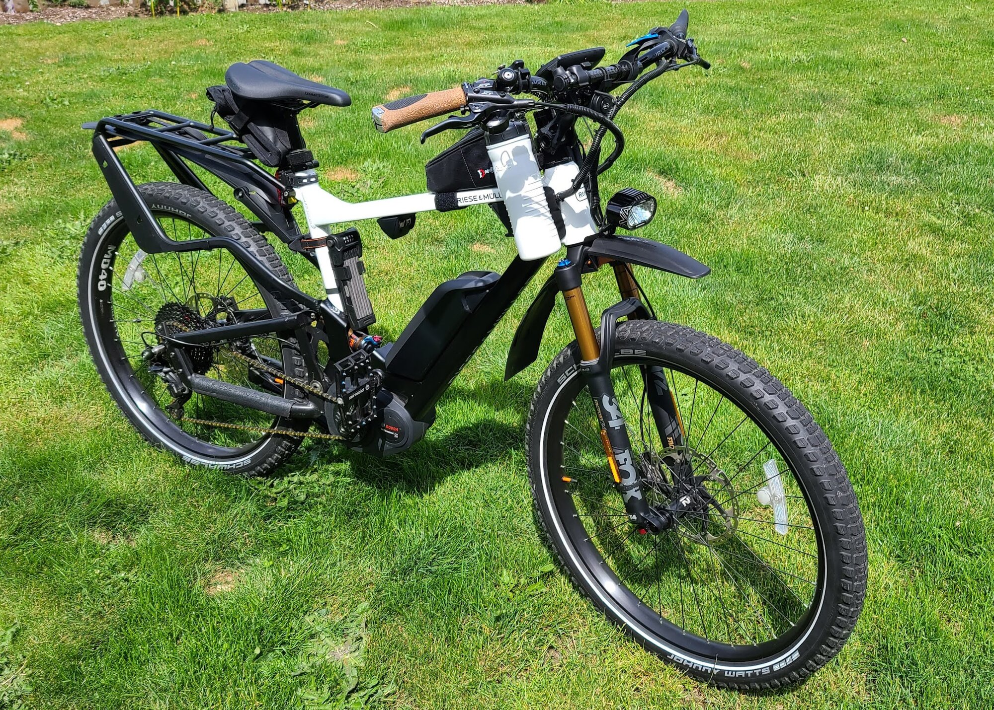

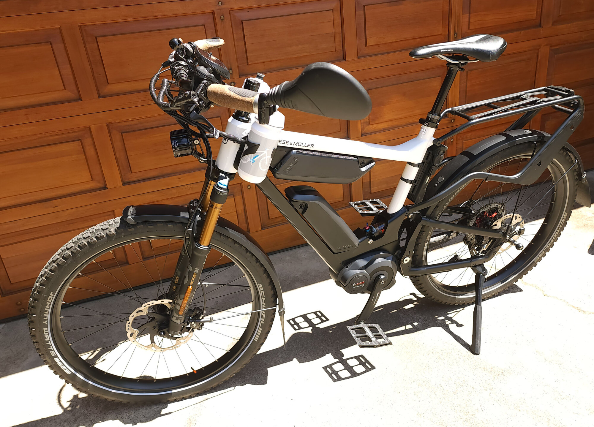

I owned a 2018 Delite mountain with 11 speed derailleur, that I modified with a delimiter to obtain higher speeds, thereby voiding the warranty (no big deal as I just recently sold the bike with 6,500 miles and absolutely no problems with anything). Obviously getting a speed version up front is a smarter option. I also upgraded to a Nyon display, which I highly recommend.
Having had two other bikes with Rohloff E14 I ended up with a strong preference for a derailleur versus Rohloff. It is slightly more efficient, if you keep it clean and well lubricated. The Rohloff with the belt is cool and, when it runs well, a terrific system. However if you among the unfortunate few, as I was, who experiences a leaky seal, it can take months to get it fixed, months without your very expensive bike. A conventional drive train with a cassette, shifter and derailleur needs regular cleaning and lubrication, replacement of the chain and eventually the cassette as well. However parts are readily available in most bike shops as are people who can do the replacement for you, if you are not mechanically inclined. Problems take days to fix rather than months with the kind of spotty service Rohloff has had here in North America
I rode mostly on roads in the Pacific Northwest (lots of rain) so I also added SKS Bluemels 75 fenders and Johnny Watt 2.8" tires, plus the Supernova pro headlight. I also had a pair of SKS raceblades for quick off and on during the summer months. After three years, I upgraded the fork and shock to Fox Factory with Kashmina. The rack comes off and goes on in about two minutes by removing 3 bolts. I swapped out the handle bar for a surly Terminal with a 30 degree sweep back for more hand and wrist comfort.
I would definitely recommend getting the dual battery and get the dummy cover so that you could safely ride with only one battery but also go with two whenever you wanted to go longer or carry more weight. Although Kansas is not very hilly, it does get pretty windy there out on the plains and wind is a real battery eater as well as hills.
All in all a fantastic bike that will put a smile on your face every time you saddle up. Note the different fenders in the two photos. The first photo in front of the garage door is quite recent. As you can see the bike has held up quite well.
I am happy to answer any other questions you might have.

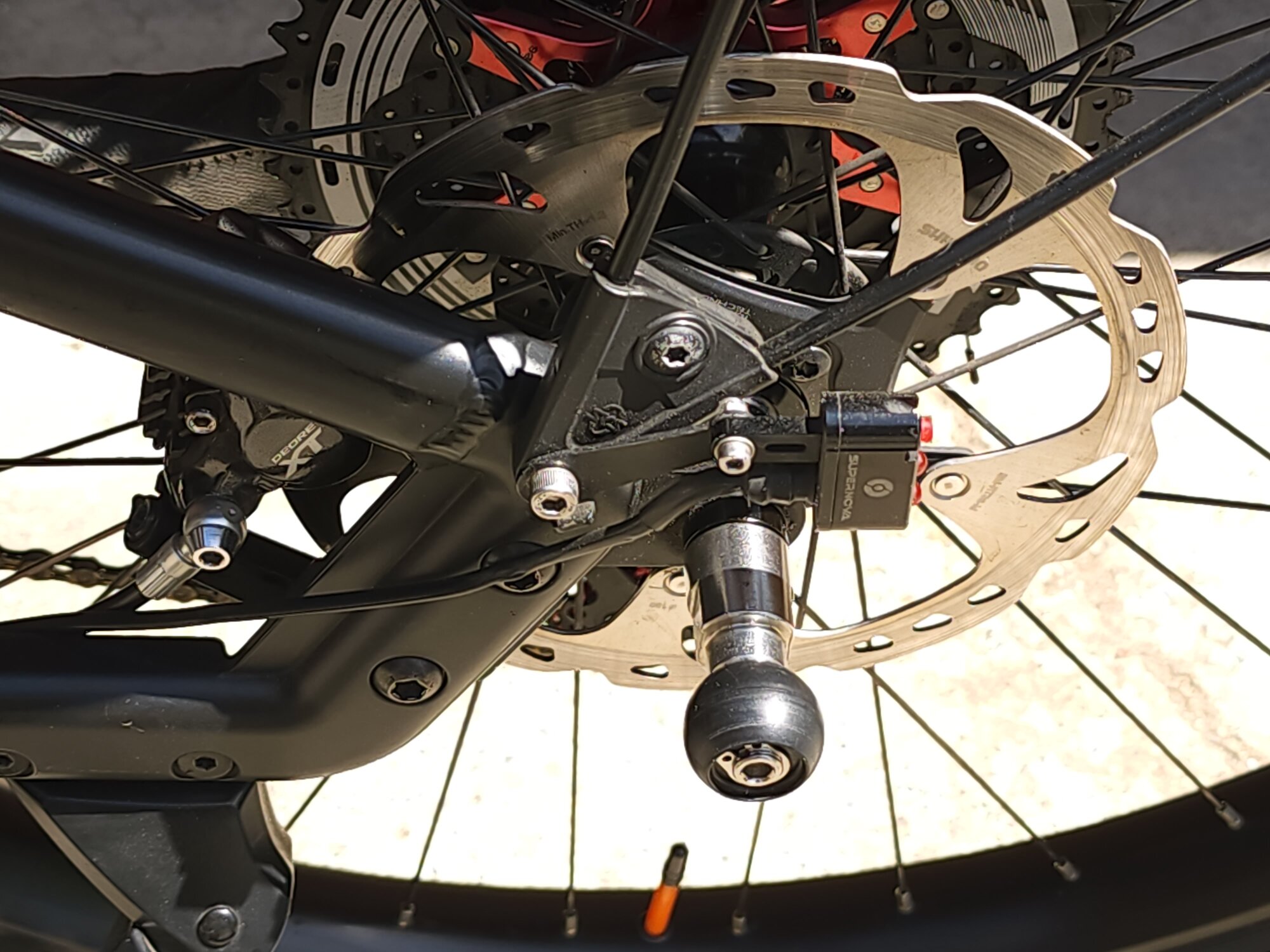

Alaskan: When you take off the rack what do you do with the taillight and associated wiring?

the tail light is a bright 3-light Supernova that is not on the rack but rather attached down low, by the rear dropout. In the photo below you can see it along side of the back wheel brake rotor. It is attached to the fender mount threaded hole
