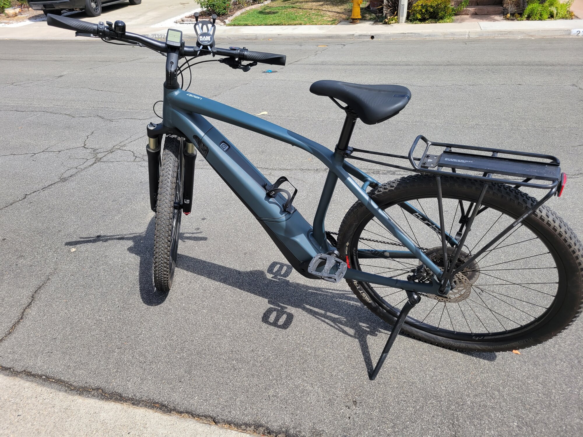

I'm liking the bike. Was looking for something for off road that was better than the Vado SL. I had a Levo SL but found I didn't need the full suspension for the types of off road I do. I would have gotten the Tero instead of the Levo if it had been available or even announced. I've done green and blue trails on all the bikes and the lower powered SL's could be a challenge on some of the steepest grades with cadence crunching rocks or ruts that need steering around. The Tero handles those easily both because of the extra power assist as well as the bigger tires (bigger than the Vado SL anyway). Most of the time the greater power of the Tero is not needed, but it is good to have it as a bailout -particularly when trying new trails.
Downsides are the pedals and grips which I've replaced. Also added a kickstand :). I also have swapped in S-works 42 mm Pathfinders for the days I know I will only be on pavement - probably > 20+% increase in range over the stock Ground Controls. Bigger downsides are the weight and the Class 1 limitation including the 36 tooth chainring. The other downside is I think the 29er fork is too long for the bike. I've ridden a Vado 2022 with it's shorter 80mm travel and 650B wheels - and I liked the handling better. The Pathfinders are about the same diameter as the Vado's 650B 2.3 in Pathfinders and I prefer the Vado's handling.
I may or may not Peartune and change out for a larger chainring. Gonna wait til my "free" checkup/adjustments are done by Specialized in any case. I'm also researching swapping the fork for one designed for a 27.5 bike. In any case could always go with the one on the Vado - should be good with the pathfinders but unsure how it may affect the original Ground Controls. One good thing about 700C is that there are a lot of different gravel tires available and the Tero can fit them - something my Vado SL with fenders can't do.

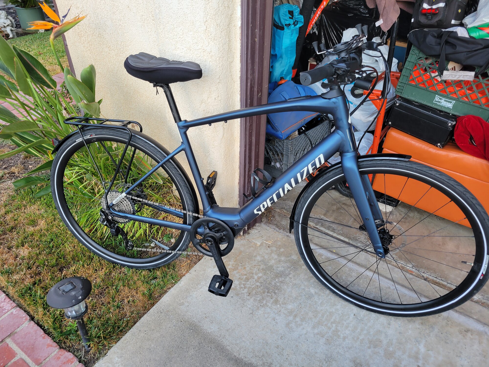

I am not using these bikes to commute but to exercise so for me the Sl is better fit but I know I can use it to commute if I wanted to and I like that it's not as heavy of the bike just incase I need to pedal without the assistance they are both excellent bikes it was very hard to choose one over the other one

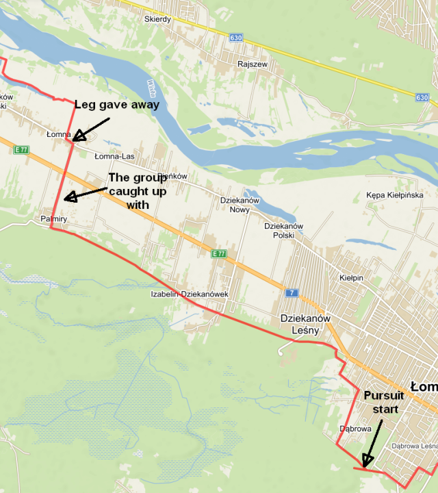

Once the ride started, I was left by the boys and girls in the dust! (I forgot to derestrict my Vado SL @jodi2) :D Once derestricted by a button push, I could follow my mates until the moment I took a wrong turn on the route and it was all over since. Yes, I could catch up with the group by a 10 km pursuit in SL Turbo mode (off-road). When I eventually reached the group tail, my ailing leg gave up and I had to leave the group ride.
The trouble began after the group restarted the ride from that point (after having repaired a flat on a group member's bike).
SL Turbo pursuit for 10 km.
I continued the solo ride on my own terms and speed. I closed the loop at 106 km, the ride including reaching the train station was 112 km, and I did 127 km on that cold day.
