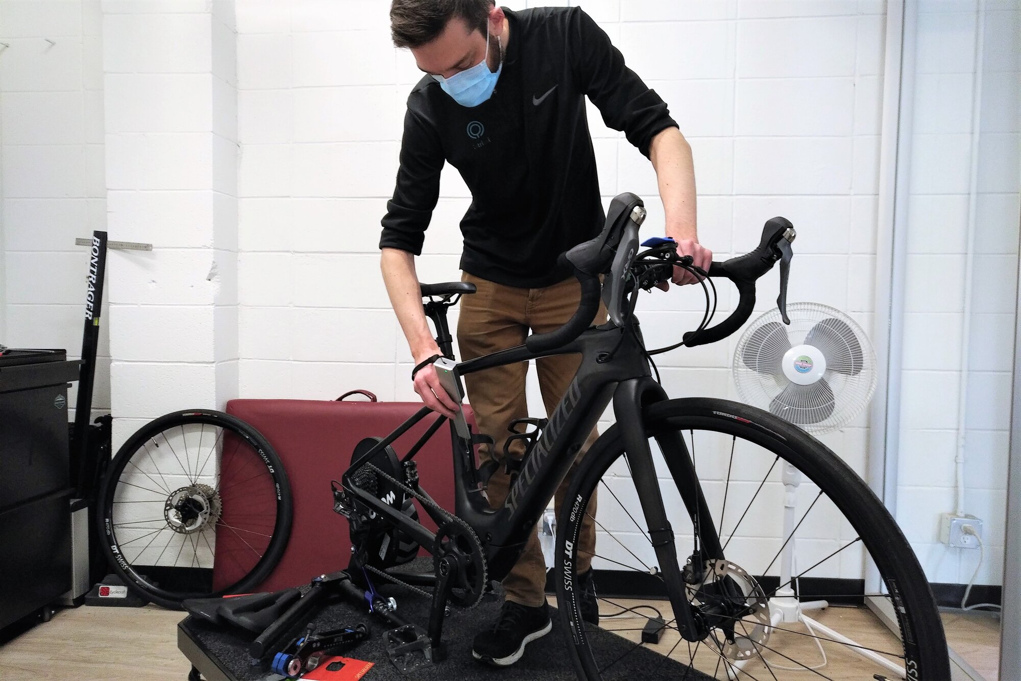

My wife who is 154 cm (5.0’) tall rides a small 2020 Creo CC is able to straddle the top tube with both feet planted without a problem so I think that you would be fine. Cranks are 170mm. She did undergo a Retul fitting at the LBS just to ensure that her bike was better suited to her riding style. They replaced the stock 80 mm stem with a shorter 60 mm version to accommodate her shorter reach as well as made a few adjustments to the brake levers, handlebar angle, seat post height and replaced the stock seat with a Mimic. It certainly made a difference with respect to her riding comfort.
Her other analog Cannondale with Ultegra Di2 is 48cm and fits her like a glove. She boasts how wonderfully crisp and precise the shifts are and would likely prefer to swap out the GRX mech groupset on her Creo for the same but for now she’s content sticking with its current set up.
