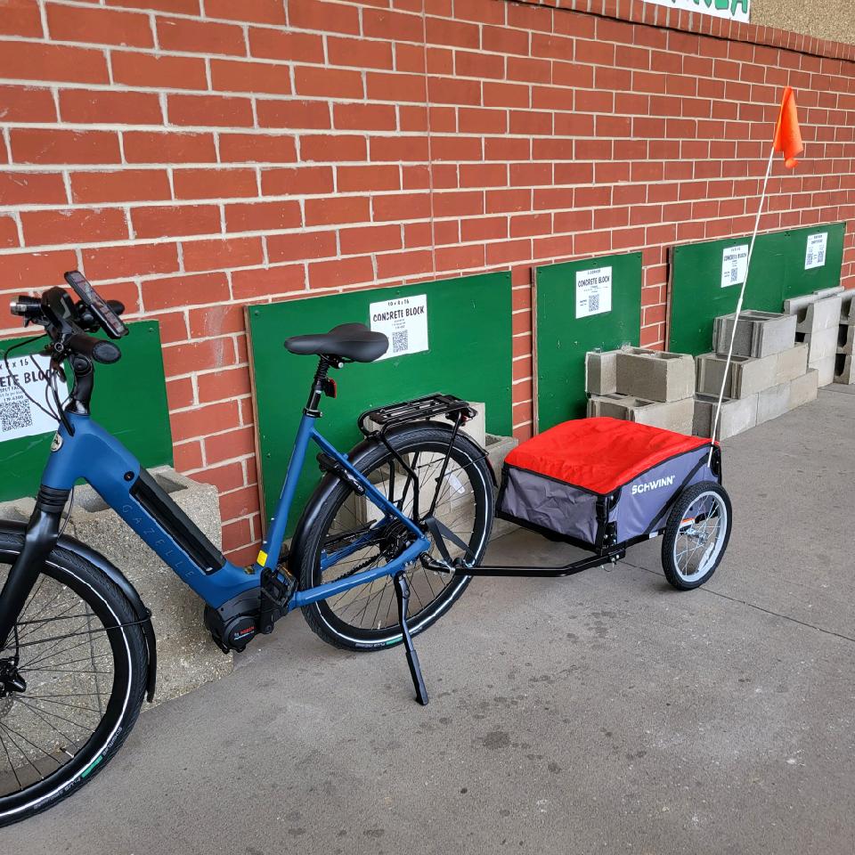

Don't know how good it is in winter because we store them in the winter, but the C380 goes great with this Shwinn trailer for cargo.

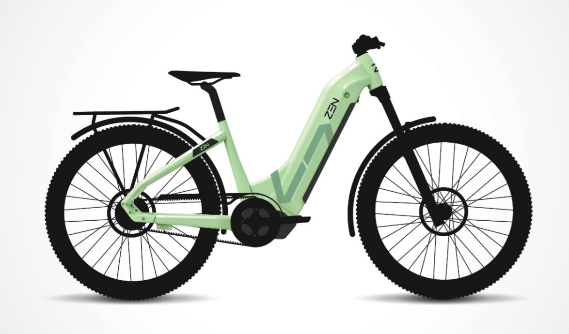

Other bikes you might like to look at include the upcoming step through model from Zen Ebikes that apparently uses a Bafang Ultra motor that would be a very strong hill climber.
Have they released more info than what you linked me to? It's not much to go off of.

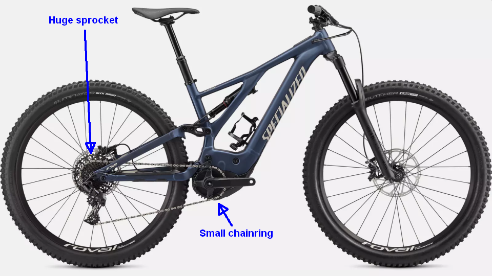

Sorry, I tremble at the sight of the dérailleur. Maybe I'm unreasonably scared of them, but dang have they made me hate bikes in the past.

Ah, don't let a derailleur scare you off-but I will defer to the riders on this site that have a ton more knowledge than I do..

I saw it discussed by one of our European members on this thread, but there are a couple of shops with MY23 specs listed like this Texas store, just not on the official Gazelle North America site yet.
Re: Zen Ebikes, is a small custom ebike builder in Halifax, NS. It would be best to contact them directly, one of the co-founders @Ravi Kempaiah is a forum member and you could message him here if you prefer.

@Eiri , we do assemble Bosch-platform based E-bikes and we do have some belt-driven bikes with Enviolo heavy duty IGH.
Happy to share more info. The bike we are receiving towards the end of May has an advanced BMS+ battery (52V,20Ah)/ smart charger combo.
The production version will have front basket capability as well. It will look something closer to the render shown below.

With a steep hill ahead, the rider downshifts (to make the pedalling easier) and gradually increases the assistance. With inadequate gearing and underpowered motor, the e-bike slows down as much as it becomes impossible to control it (at some 8 km/h). Then the rider has to stop, dismount, and walk the heavy e-bike up the hill, which defeats the whole purpose of the pedal assisted e-bike. With proper gearing (I must mention the derailleur system) and a powerful motor, the rider can rotate the cranks pretty fast, the e-bike remains at a controllable speed (10-12 km/h), and climbing the steep incline is doable.
How so? By what margin? Because so far my experience with hills and dérailleurs has been "welp, gotta get off the bike, I didn't downshift enough and now I'm stuck", I'm kinda scared of them but maybe I'm just misunderstanding something?
The Internally Geared Hub has a certain gearing range, and the lowest gear a.k.a. "granny gear" typically does not fall within what we call "mountain gearing". With the lowest IGH gear and inadequate motor power you could be stopped during your climb, as I described above.
With a derailleur e-bike properly chosen for the purpose, the largest rear sprocket can be huge, and the chainring (front) very small. It means "mountain gearing" that gives you mechanical advantage on climbing (you pedal fast with reasonable effort, and the experience is as if the e-bike "lifted" you uphill). Necessary to mention, derailleur/chain system is very efficient, turning most of your leg & motor power into motion. IGH is far less efficient, and a significant portion of your & motor effort is lost to heat in the IGH.
A model e-MTB. It is intended to climb steep hills and safely descent. Not made for carrying the cargo for sure. The gearing here makes the climbing a breeze, giving the rider a huge mechanical advantage.
The only alternative to mountain gearing is getting an e-bike with a very powerful motor.

Well, I don't have a strong attachment to on-bike cargo capacity. I'm entirely fine with a trailer, really. That would be fine, right?
A trailer would be fine. However, your typical mountain e-bike is not made for towing a trailer, and hauling a trailer uphill requires a significant motor power. Again, I am sure Zen Bikes can propose an e-bike with a very powerful motor and a big battery (including the belt drive with IGH) to make the task feasible.
