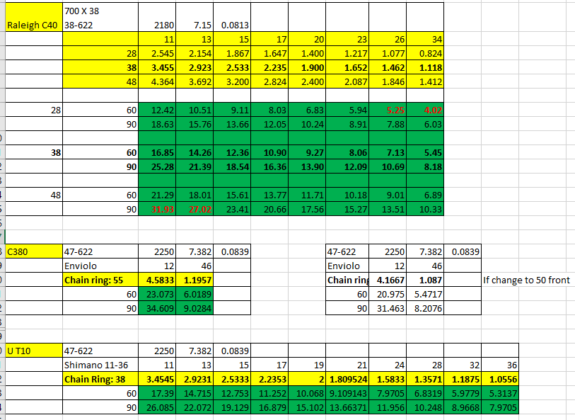

Can you help me understand those numbers? 11-42t and such. Sounds like the key to understanding gears, but I'm confused considering the first number doesn't change but the 11-46t one still helps with hills?
Answering for Trevor:
The gearing (gear ratio) is the number of teeth on the chainring divided by the number of teeth on the largest rear sprocket (a.k.a. "granny gear"). For serious climbing, the gear ratio in the granny would be the best less than 1. The front chainwheel in the Gazelle is 55T. According to the info from Trevor, the equivalent largest rear cog in the Enviolo is 42T. Divide 55/42 = 1.3. It is not only far from "mountain gearing" but also the 65 Nm motor is not what you need for your dramatic hills (too weak). Generally, IGH e-bikes are not made for steep hills, these are an urban thing.

I question why Gazelle picked 55 tooth front sprocket; I don't need 34 mph on a Class 1 bike; wouldn.t mind a bit more on the other end. Much prefer the U T10 gearing, but wanted to get out of the derailleur business.
