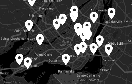

My mom and I are going on a weekend trip to Montreal towards the end of May. Montreal is a huge city, so I have no doubt they sell all the brands. I intend to try some bikes there. Not sure which store(s) I'll visit. I've identified Quantum eBikes that seems to carry both Gazelle and Riese & Müller, as well as some other brands I don't know much about, like O2feel, Gepida, Stromer, Quantum and Urban Arrow. But it's not like they carry
everything. Maybe I ought to find another store to visit.

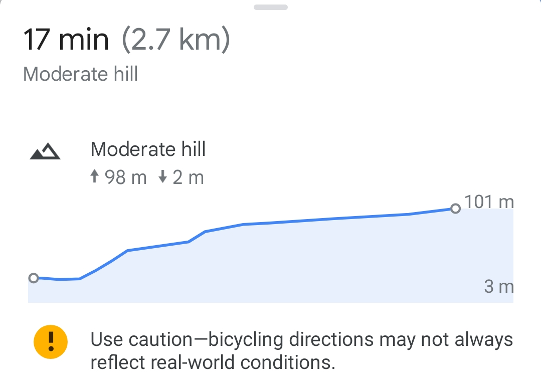

On the other hand, it is just less than 2 minutes of hard pedalling in the maximum assistance level...
What happens exactly when you try to climb but the motor is too weak?

The gear range on 380 IGH is same as 11-42t cassette, combined with 65nm motor more than enough when towing heavy trailer. I similar bike with this motor and gearing.
I have one hill which is 16m elevation over 70m. Which is steepest hill around here. 11-42t cassette struggles but straight forward with 11-46t cassette.
Can you help me understand those numbers? 11-42t and such. Sounds like the key to understanding gears, but I'm confused considering the first number doesn't change but the 11-46t one still helps with hills?
