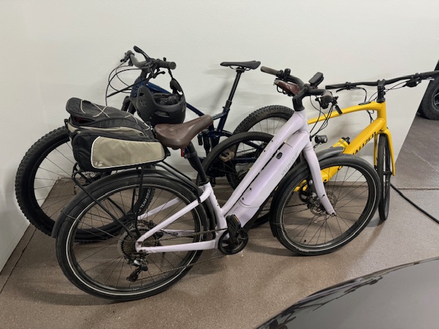

It is the previous generation of Como (Gen 1). I would not recommend it because it might be problematic to get a new battery, motor or some spare parts in the future.
Also, this older Como has no suspension fork, making it a 100% urban machine.
Maybe so, but it is half price and it os Specialized and they stand behind their products. Its our 5th Specialized bike.
That's the best advice you've received so far.
Good point but any big brand should have dealers in most areas so if you get for example a Trek then any Trek authorized dealer will be able to support it. I would be far more concerned with online only brands. I have a Bikesdirect gravel bike with Bafang M800 and good luck getting that serviced in US. As far as I know the only option is sending it in to the Bafang California offices. I actually have my motor there now due to an issue after 3k miles.
That's right. However, that e-bike generation began in 2017, and now it is 2024. I was lucky to accumulate batteries for my Gen 1 Vado 6.0, replace the display + remote set, and have my e-bike "lifetime frame warranty" repaired but the farther we move into the future the more difficult it would be to maintain the older e-bike. (I agree to the "half of price" argument). I was recommending Vado SL, which is a relatively new design and it does not cost an arm & a leg to buy new.

There has been a few suggestion for the Como. My wife's Como will tackle about any hill, rides great and the quality has been superb.
