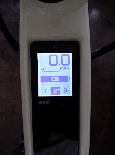

Riding to work this morning I noticed there was a message on the Omni screen asking if I wanted to update?
I went ahead and did it, and it said do not removed the battery or attempt to turn off. It then fired back up flashed a drive error I hit ok and it cleared itself.
Having not riden the bike yet (as I arrived at work) I noticed a little cell phone signal strength indicator now resides on the home screen of the Omni.
Forgive me if this had been posted elsewhere, just wondering what other ST2 owners notice about there update.
Yup, mine happened 3 days ago.
Now, OMNI looks like a phone screen from 2005's. Very cool to see this on a bicycle. I think we should rename this ST2D :) like P85D
Same thing .. after Update ..... It then fired back up flashed a drive error I hit ok and it cleared itself. Seems to run fine.
