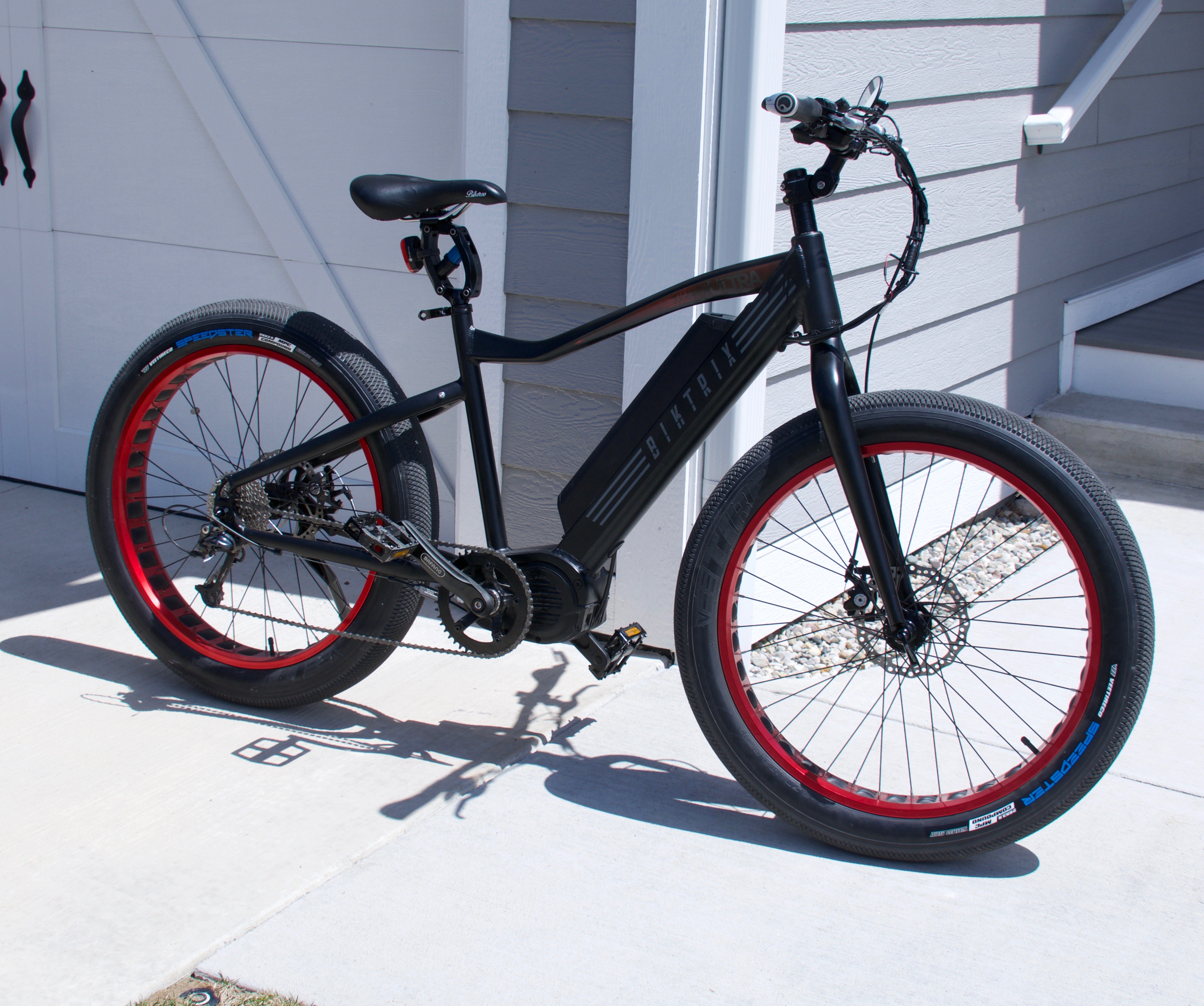

I have a Biktrix with the Ultra mid drive. Love to ride a Stromer one day.
oh I must be having a senior's moment because I thought you had a Stromer . Which model Biktrix do you have ? got any pics? I just went to their website. The Juggernaut classic HD looks pretty cool!
