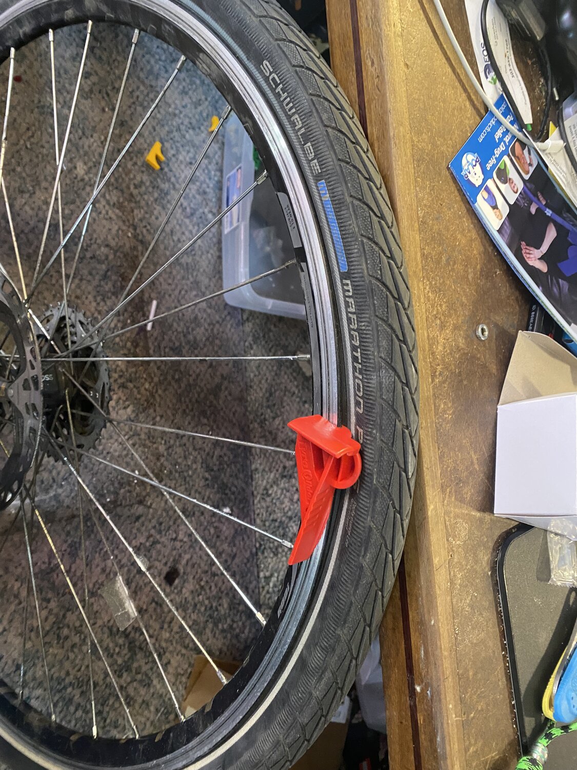

holly crap this is the best tool I have used for tires. I am not super strong and I have struggled with my marathon plus ties. but I got this puppy today and tested it on a spare wheel and it was not a big deal getting it on or off. I had to use two levers and the tire jack to get them on and it was still la struggle.An easier way to take off and install a tire:

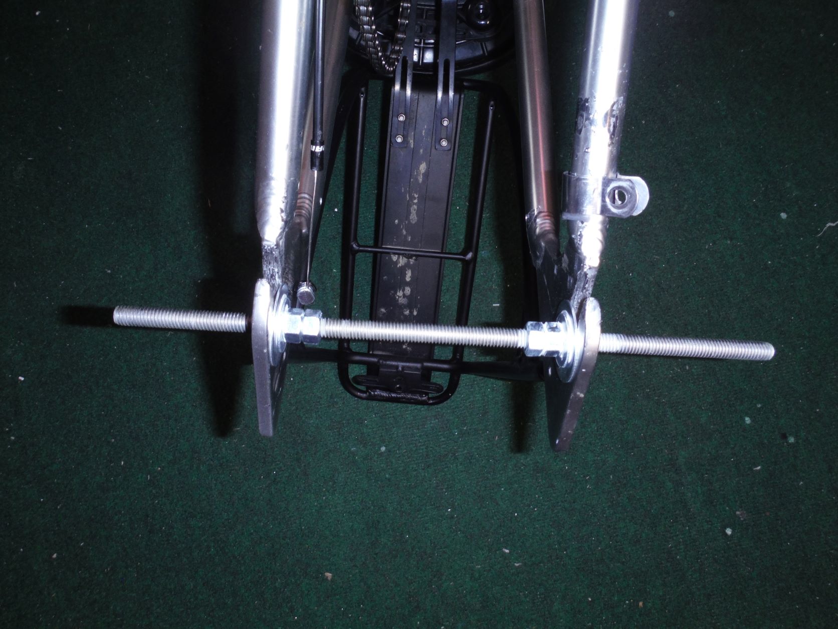

I made a similar tool with 1/2" rod, nuts and washers to seat headset bearing cupsSometimes I need to slightly alter a dropout's width. Here it is pushing out. That can be reversed.

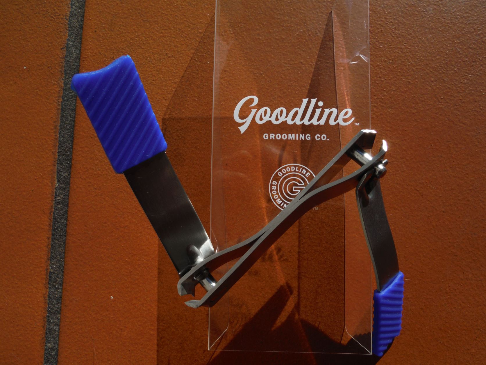

This tool has a flat cutting blade and a concave blade. It is high grade stainless with Park Tool colored gel grips. It is ideal for cleanly trimming zip ties.I made a similar tool with 1/2" rod, nuts and washers to seat headset bearing cups![]()
