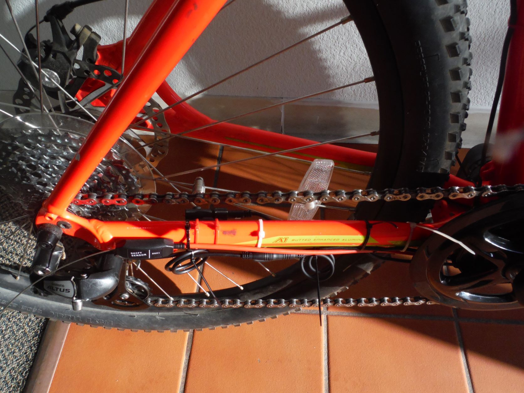

If you really go off road, branches & plants can snag the wiring on a converion. My wiring is visible & blatant. I ride on road 99% of the time; on gravel city trails occasionally. You see in the picture left, the motor & battery are on the front, the controller is under the seat out of the rain. When a Luna kit came with too short wiring to fit the controller under the seat, rain shorted out two pins on the ASI controller and burnt the pins off into the wiring harness. ASI controller was under the battery above the fender.
I don't see a "picture left".

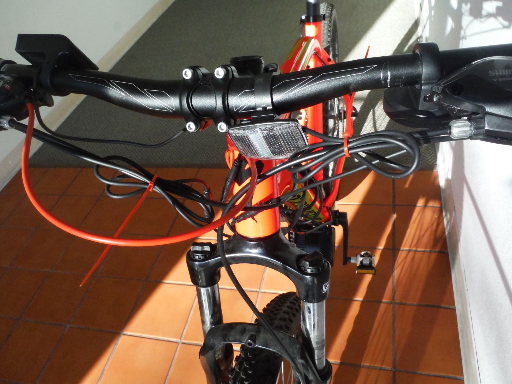

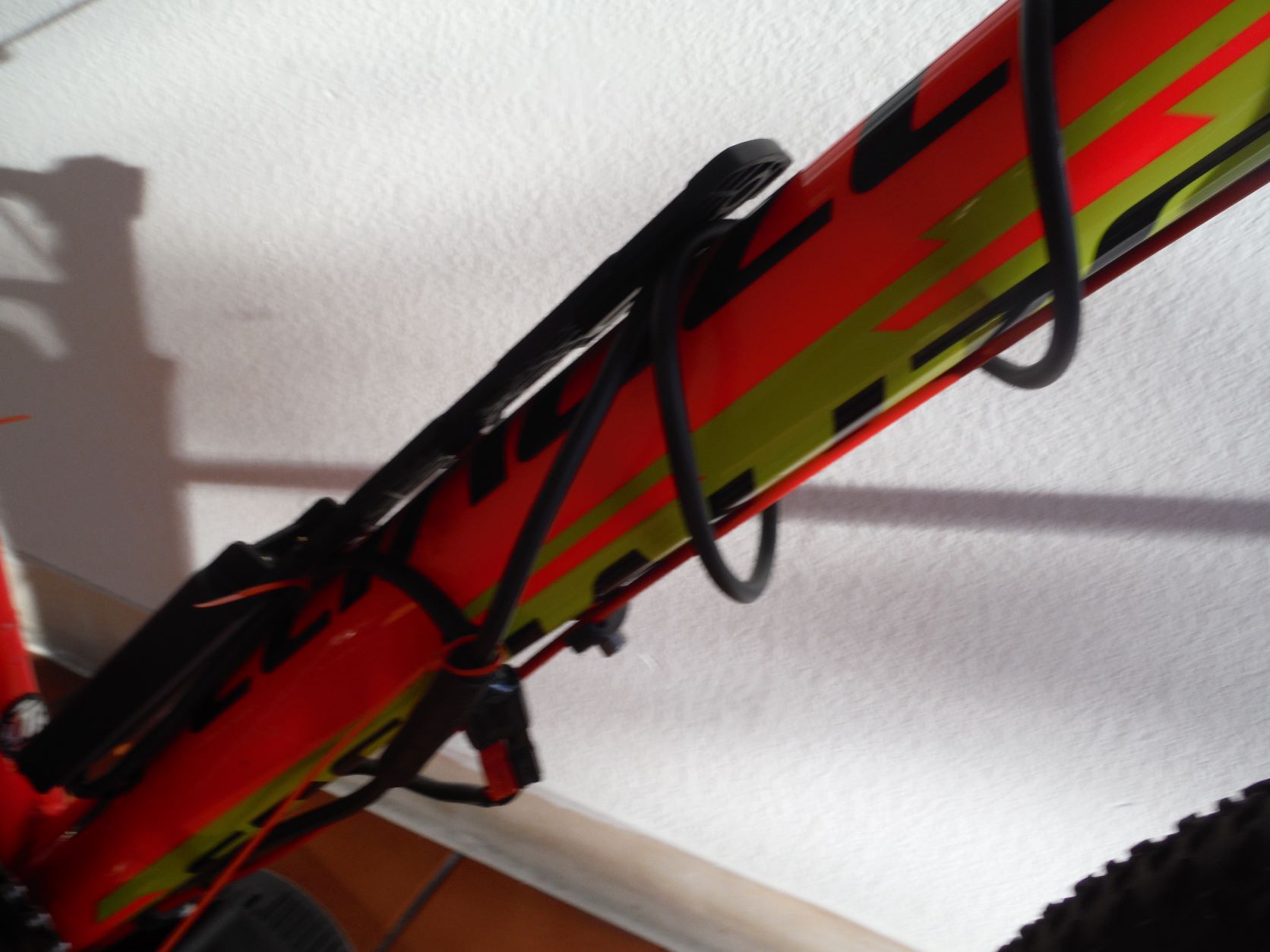

I have a ton of wiring for lights, horn, GPS, action camera, in addition to the standard kit wiring. I even have extra long wiring that instead of cutting, I wrap around the frame.
With a little due diligence, it is easy to strap down all that wiring with zip ties and or wire wraps. I mostly ride on trails, but have gone trough thick bush with no issues whatsoever.
