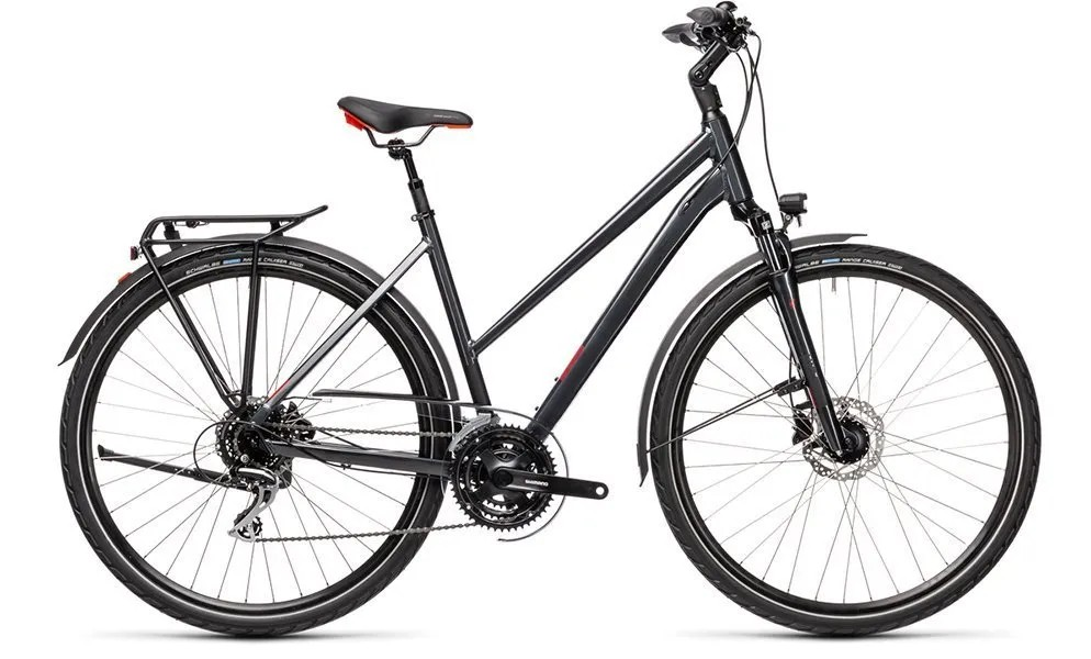

I am currently in the process of choosing my first ebike. I made a list of criteria and found the Cube hybrid one 625 to hit nearly everything I want except it is quite heavy. I live in a rented apartment on the 3rd floor, the elevator is too small to fit the bike in, and insurance won't cover me if I leave it in the shared bike store on the ground floor (no fixed racks to lock to, everyone just locks their cheap bikes with frame and wheel and takes their expensive bikes into their apartments). I am looking for an equivalent lighter alternative and wonder if I have missed something, or alternatively what item on my list should I compromise.

- Small size option, if possible with the trapeze shape.
- 22kg or less, ideally <20kg. I think that is about the limit I could carry up the stairs comfortably every day.

Diamond frame, I think.
Trapeze is a compromise between a traditional diamond frame and a true step through frame - retains the stiffness of a diamond frame with a much lower standover height. Not sure if there is a difference btw trapeze and mixte though.

If the Trapeze is what BlackHand showed, a Vado SL ST is s good choice.
Yeah I'm basing this off a test run of how heavy a suitcase can I comfortably take up and down, which is not the most perfect comparison but I think sub-22kg accounting for having to tilt the bike should be manageable. So a trapeze or diamond would allow the right kind of hold for this, just thought a trapeze would be marginally better for my short legs but it is certainly a 'would like' rather than 'need'.
