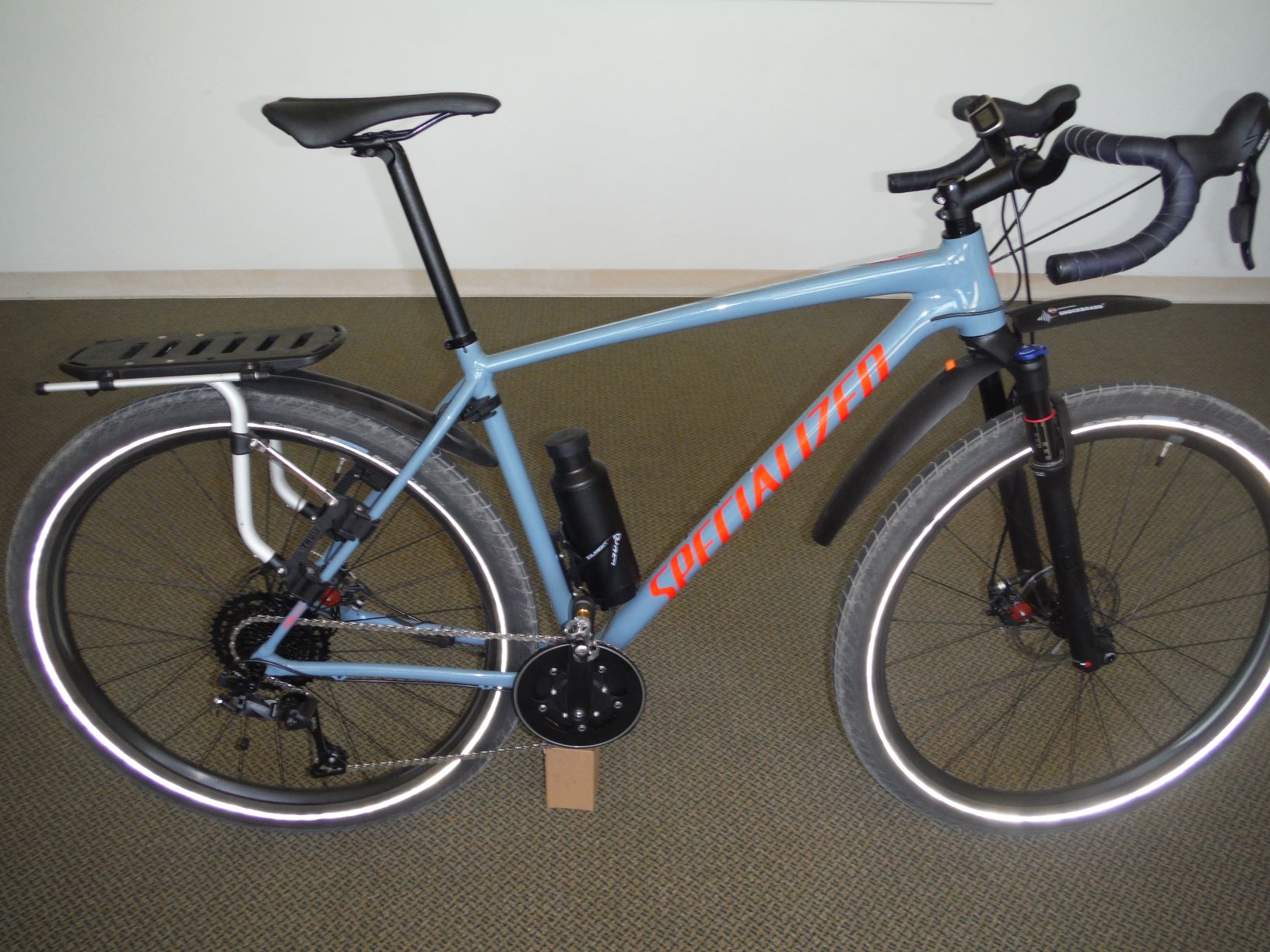

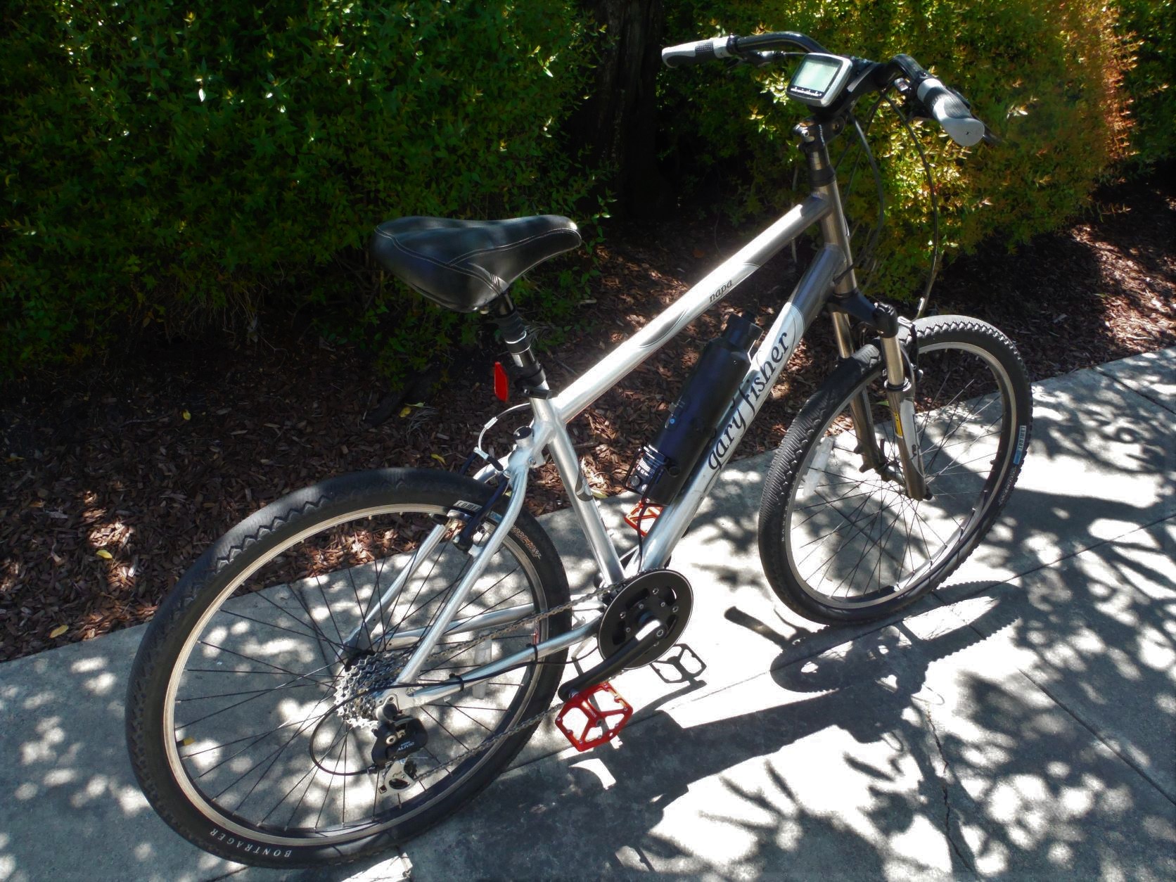

I did an old Gary Fisher today. My Specialized Chisel came with an air fork and makes a great all around bike, including mountain trails, but not rock gardens. It got the all through frame treatment. With no connectors.

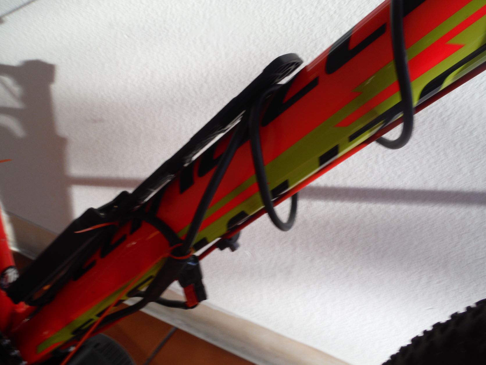

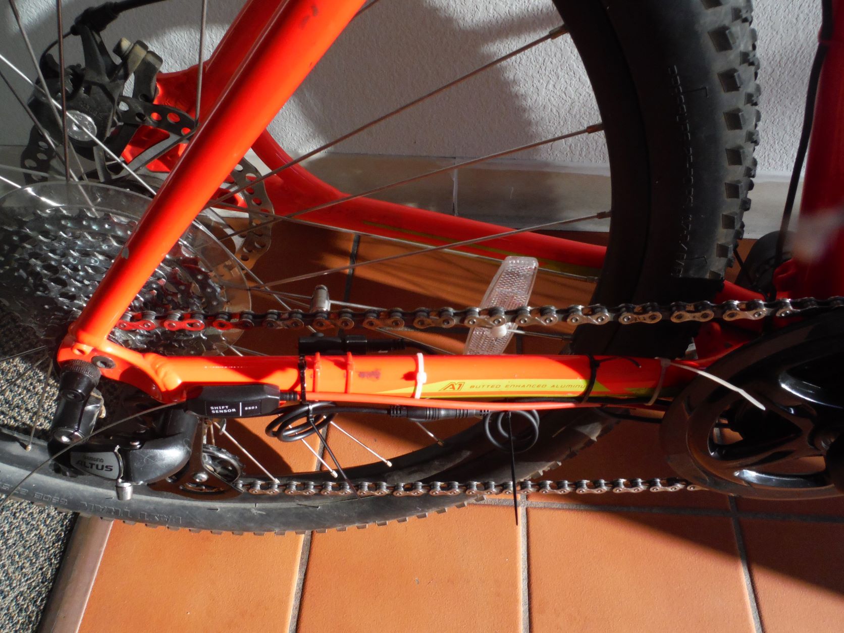

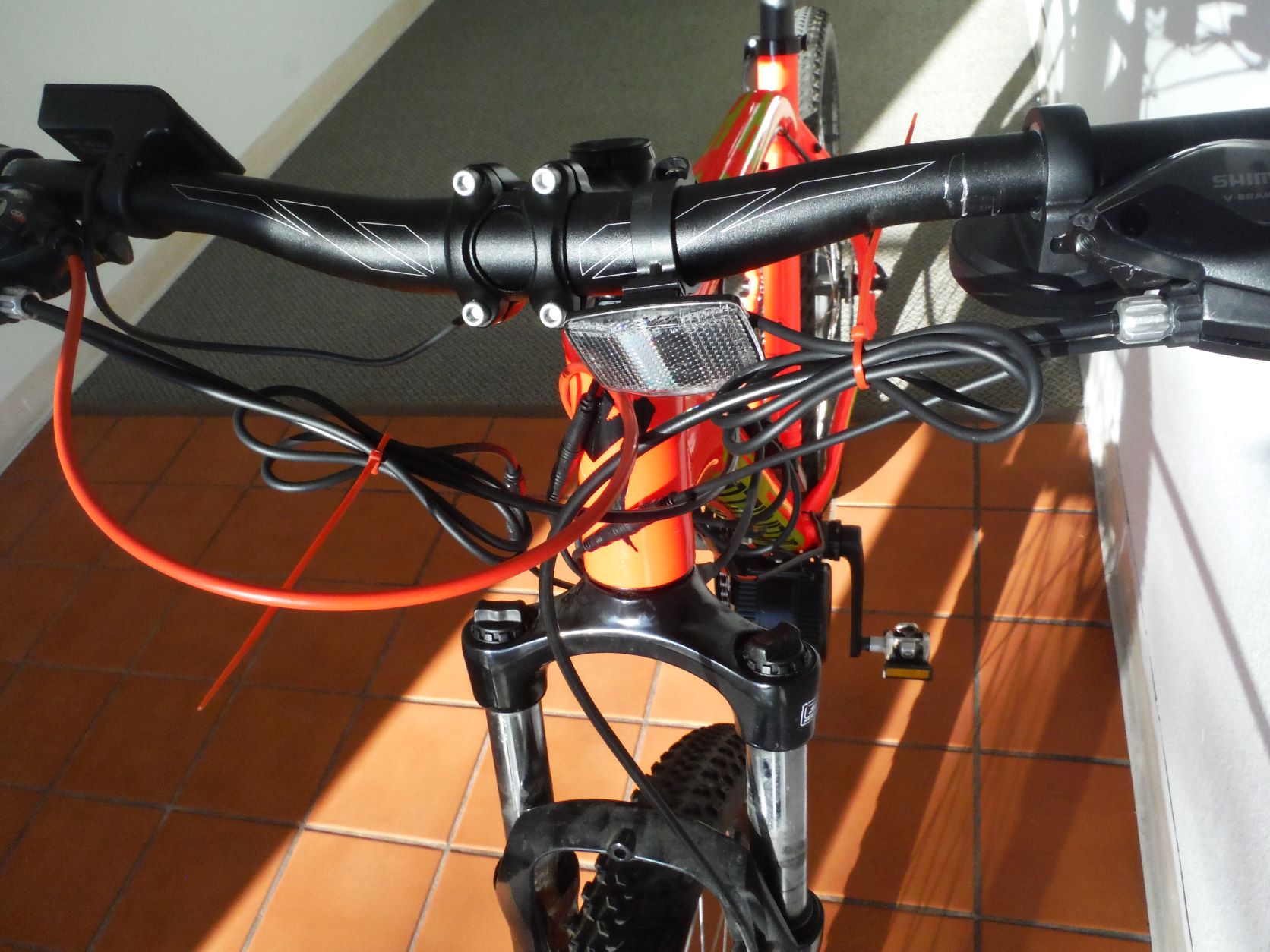

I feel like going the DIY route with a bafang 1000w mid drive would be my best choice but someone had commented about cables hanging and all while trailing and the marlin 6 has a pretty flat frame, i wonder if it would be possible to put all the cables inside or will that be hell with hanging cables lol

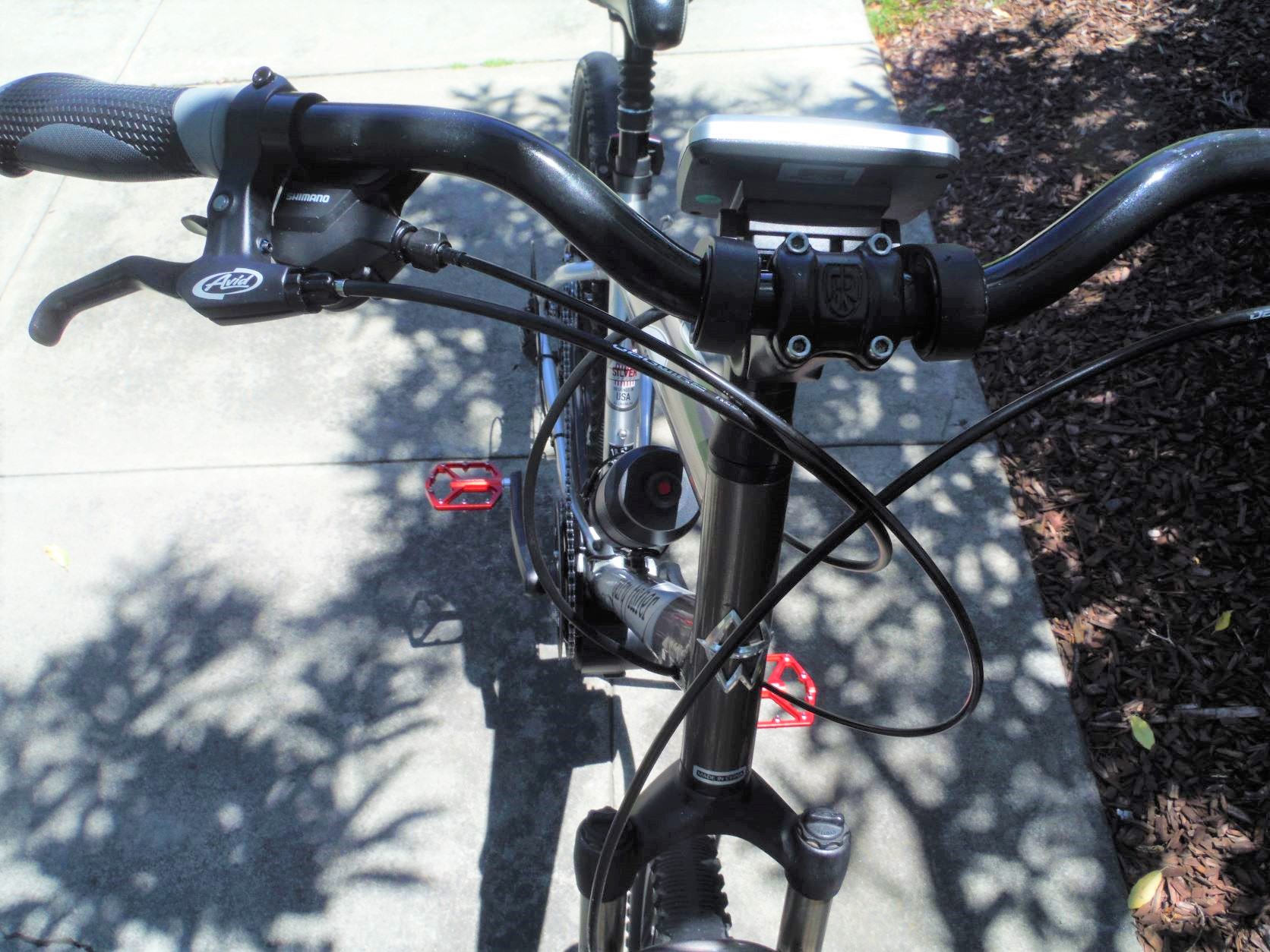

Others have seen this bike. Sorry to bore those gentlemen. This is the Chisel with an air fork. I put a riser drop bar on it. Took it to 9-Sp from 11-Sp to make it more robust and did through frame everything. It climbs like a tiger. I took it from hydro to mechanical for simplicity. It has a cadence sensor but more importantly a torque sensor. I removed all bits that cause any lag. It is super smooth. It is rated at 350 nominal but out climbs a 1000W Ultra on a 12 percent grade. It hits 720W peeks. The Big Ben tires roll fast over gravel and broken pavement. The wire to the right is to the display on the left. Zero zip ties.

Seriously if you're going to install internal cable and wires, for the amount of work you have to do, you might as well buy a pre-made bike.
Unless you like working for something like $25 an hour.
Understand literally everyone has their favorite methods, but you can easily secure the wires 100% better than pedalma did.
Unless looks are that important to you. I wouldn't worry about how it looks.
Personally I could give a rat's turd what my bike looks like, as long as it doesn't cause the bike to malfunction. I build what I want as far as performance goes and damn the ascetics. Unless I'm trying to make money off the end result.
In fact there are a lot of ppl who purposefully make their expensive bikes look like junk, just to deter thieves.
I learned long ago, do what you like and take everyone else's opinion with a grain of salt, even this one !

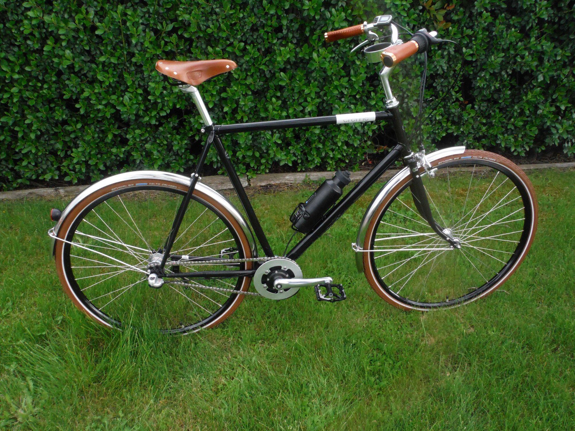

Then you are fine with an air fork and a hardtail with wider, low pressure tires. Check Craigslist for a good used one to convert. I will run a three speed coaster brake bike with a chromoly fork on "mountain" trails. The lumps are just ridden off the saddle. It is fun to sip coffee while passing guys in spandex on a mountain climb.

yeah its not for the looks but just making sure nothing will get caught up while doing XC trails

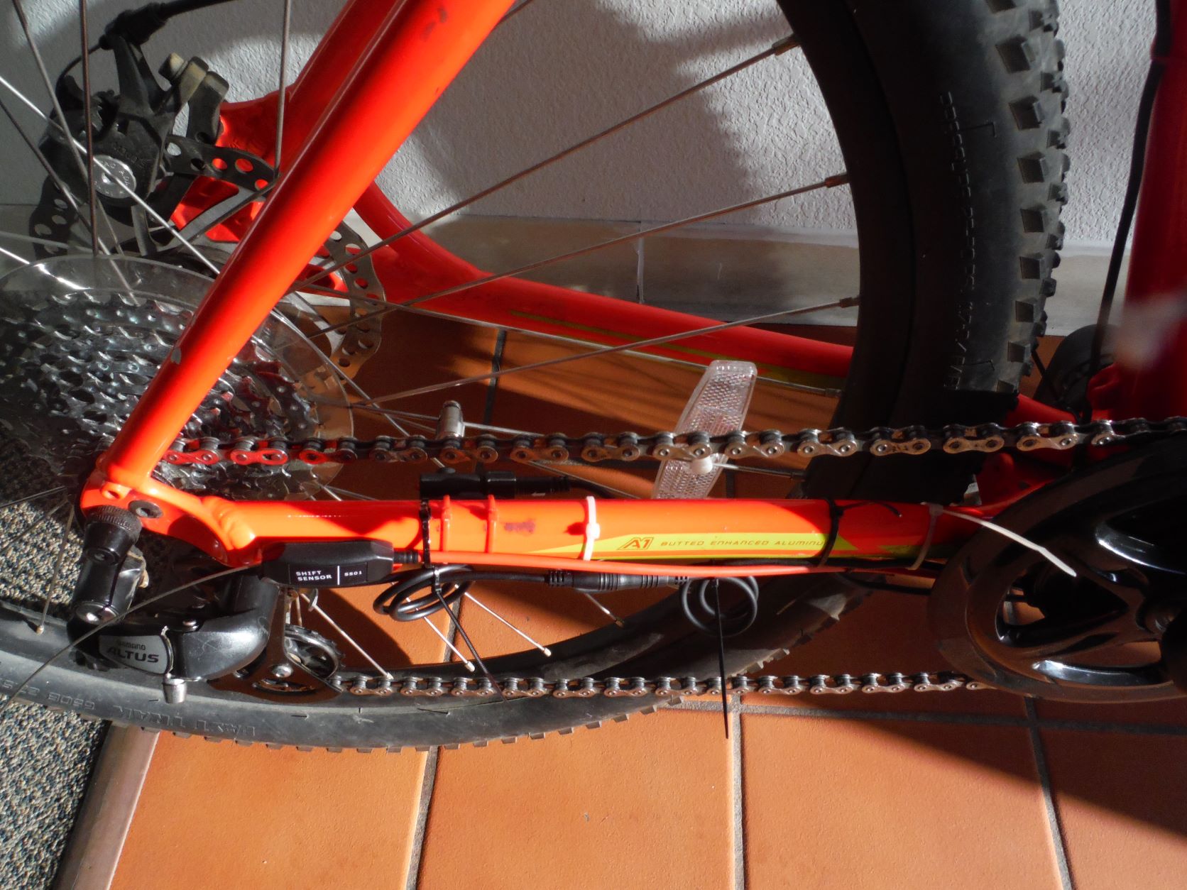

marlin 6 BBSHD
Google for insights. I always suggested our customers do this. If there are builds we can learn if there are any build issues.
marlin 6 BBSHD
oh yeah i've been googling for a month before i started posting here bwhahaa and i shall continue! am slowly getting to the point of making clear decisions -- quick question if you can help, something i cant seem to find an answer to -- when installing a mid drive kit bafang, does the installation give you more space around where the pedals are? like pushing the pedals out a bit more outside? some of these batteries are 6" wide and it seems like it would hit the pedals unless the conversion changes the dimensions there
I’m a bit confused. Battery position shouldn’t interfere. What did other builders run into? Reention Polly cases are 3.74 inches wide. Hailong aka shark cases are about the same.
