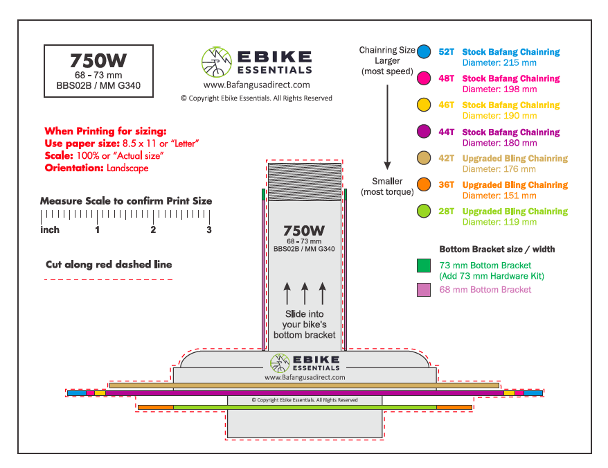

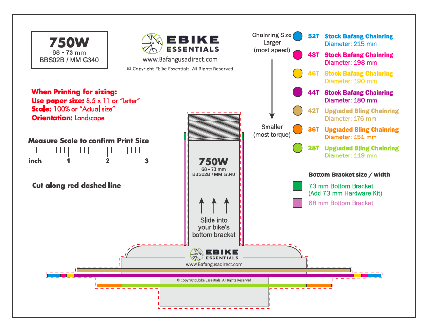

I am assuming the answer is yes installing the mid drive motor gives you more clearance space as i look at picture but I'd like to make sure of this. I inserted a red arrow to show the clearance space i'm talking about - seems like mid drive motor adds a few more inches of clearance from battery to pedals
For some reason, I can't post the PDF. But there's a print scale.
I love the way normal sized chainrings are branded " bling" !
It"s also worth noting the big steps and limited options in the mtb chainring size - just 28 and 36 t ! How do bafang owners find those options for tighter / technical riding?
Just thinking whilst tapping - on my giant ( yamaha pwx) I vary between 32/34/36 chainrings depending on intended use - but that's with an 11 sp wide range cassette - not the 8 sp the op has. I would be reasonably happy living with just the 34 option but if only 36 was available that'd be unpleasant. Does the extra watevers in the bafang compensate for the limited mechanical choices?
