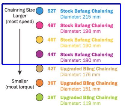

I love the way normal sized chainrings are branded " bling" !
It"s also worth noting the big steps and limited options in the mtb chainring size - just 28 and 36 t ! How do bafang owners find those options for tighter / technical riding?
Just thinking whilst tapping - on my giant ( yamaha pwx) I vary between 32/34/36 chainrings depending on intended use - but that's with an 11 sp wide range cassette - not the 8 sp the op has. I would be reasonably happy living with just the 34 option but if only 36 was available that'd be unpleasant. Does the extra watevers in the bafang compensate for the limited mechanical choices?
My Ultra came with a 44t that I changed to a 49t. Are you saying choices below 44t are limited? There's nothing special about it. Just another 130 BCD 5 bolt.

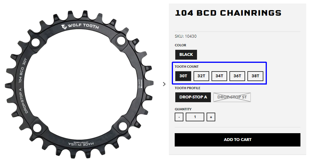

Here are true (a.k.a. "bling") MTB chainrings.
Thanks- I wasn't clear on why they only listed such limited (unusual sized ) chainrings - so any 130 bcd 5 bolt fits??? Nice to learn new stuff- thanks
