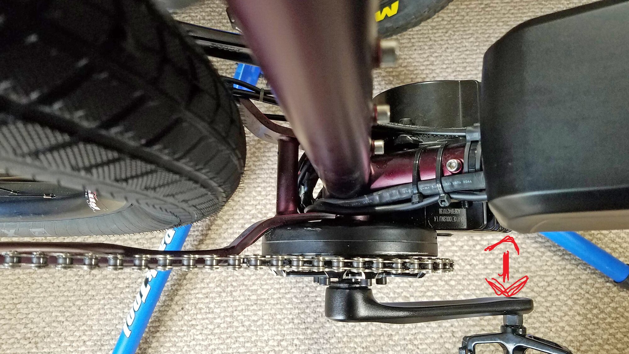

I am assuming the answer is yes installing the mid drive motor gives you more clearance space as i look at picture but I'd like to make sure of this. I inserted a red arrow to show the clearance space i'm talking about - seems like mid drive motor adds a few more inches of clearance from battery to pedals

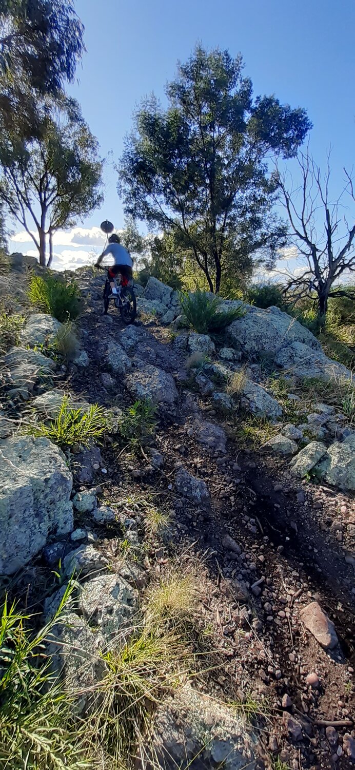

Btw, xc means something different in the mtb world as well, this is a local xc trail
yes i would say this is the kind of trail \ track i would do... here they are rated green\blue (beginner\intermediate) trails and that is what i usually stick to... no jumps or crazy downhill but hills like in that pic are pretty common in beginner trails

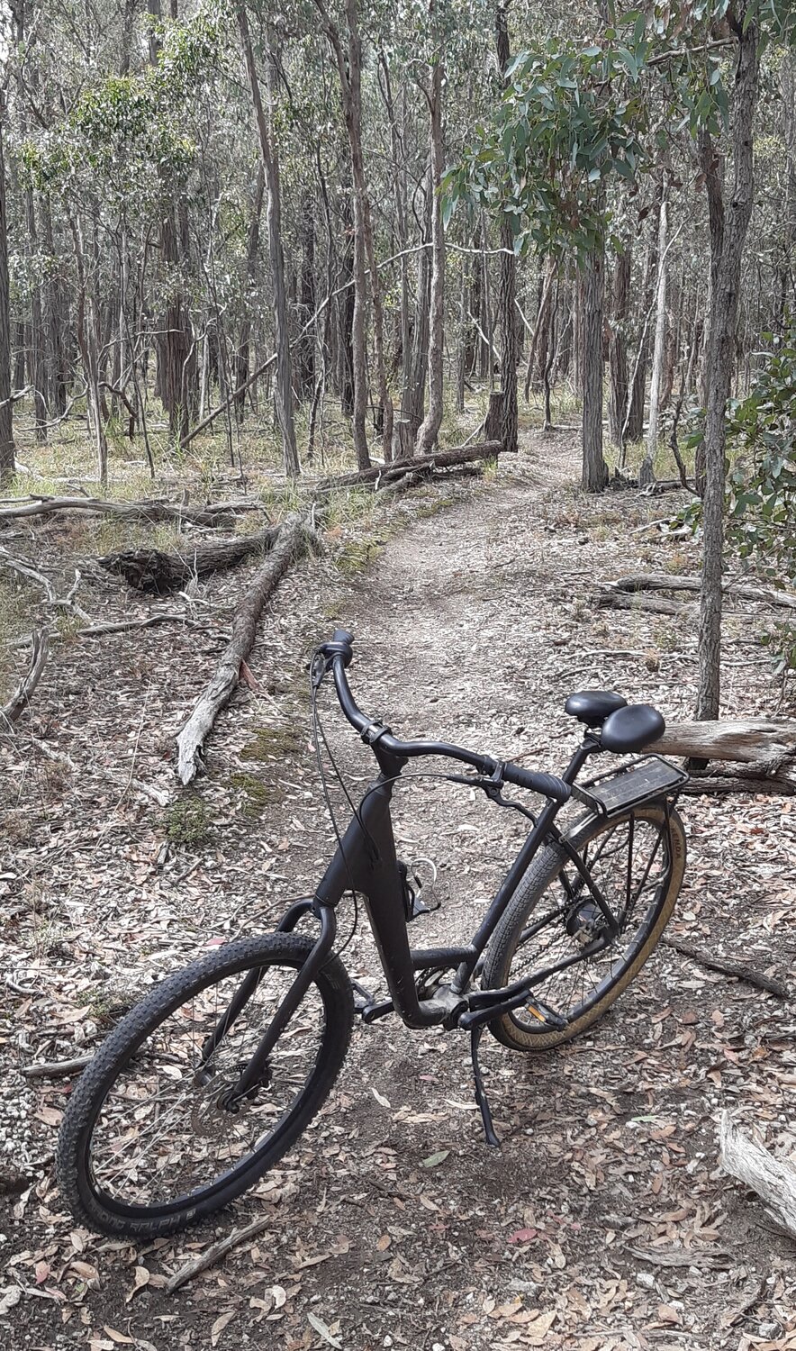

My wife is a gentle cyclist, she wanders along rail trails / easy mtb trails on her step through regular bike. IF she wanted some assistance, I'd be fitting a hub drive to her bike because she doesn't need to think about unsprung weight, balance in the air or extreme climbing ability. It's just not worth sinking several thousand $ worth of electrics and mechanics on a bike that simply wanders through the scenery. She can get off and push up steeper hills ( which she would do anyway because she isn't interested in technical riding)

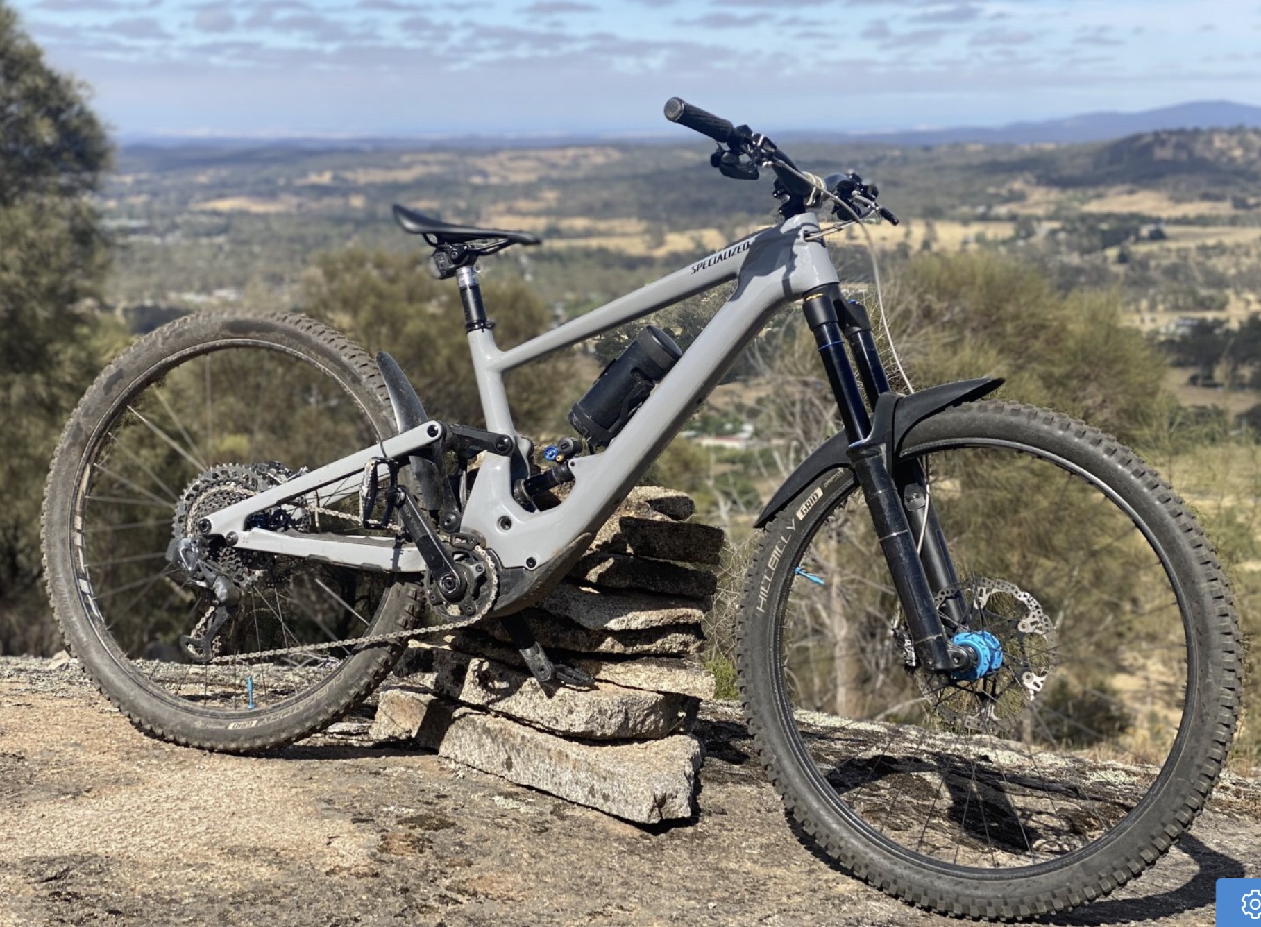

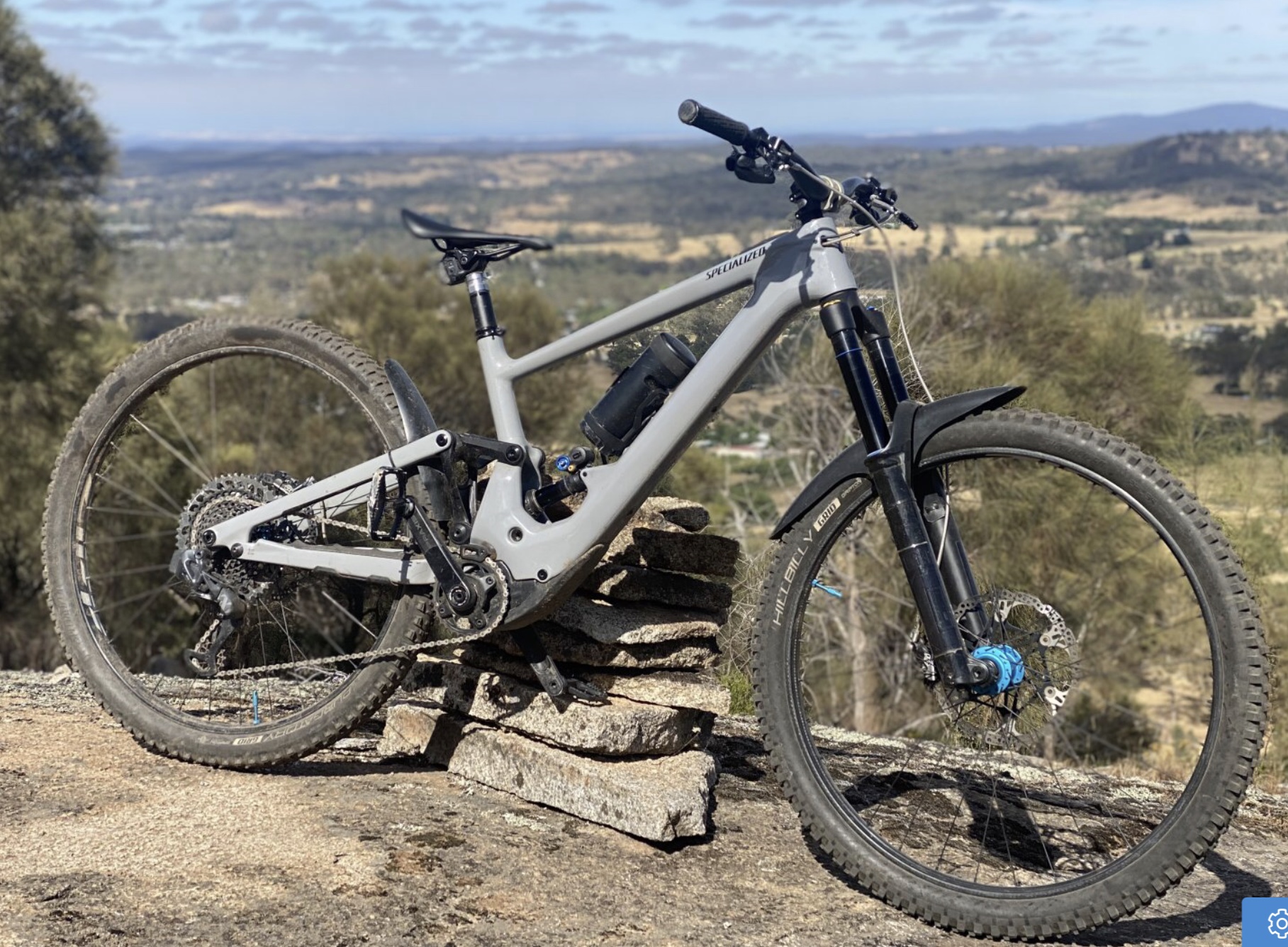

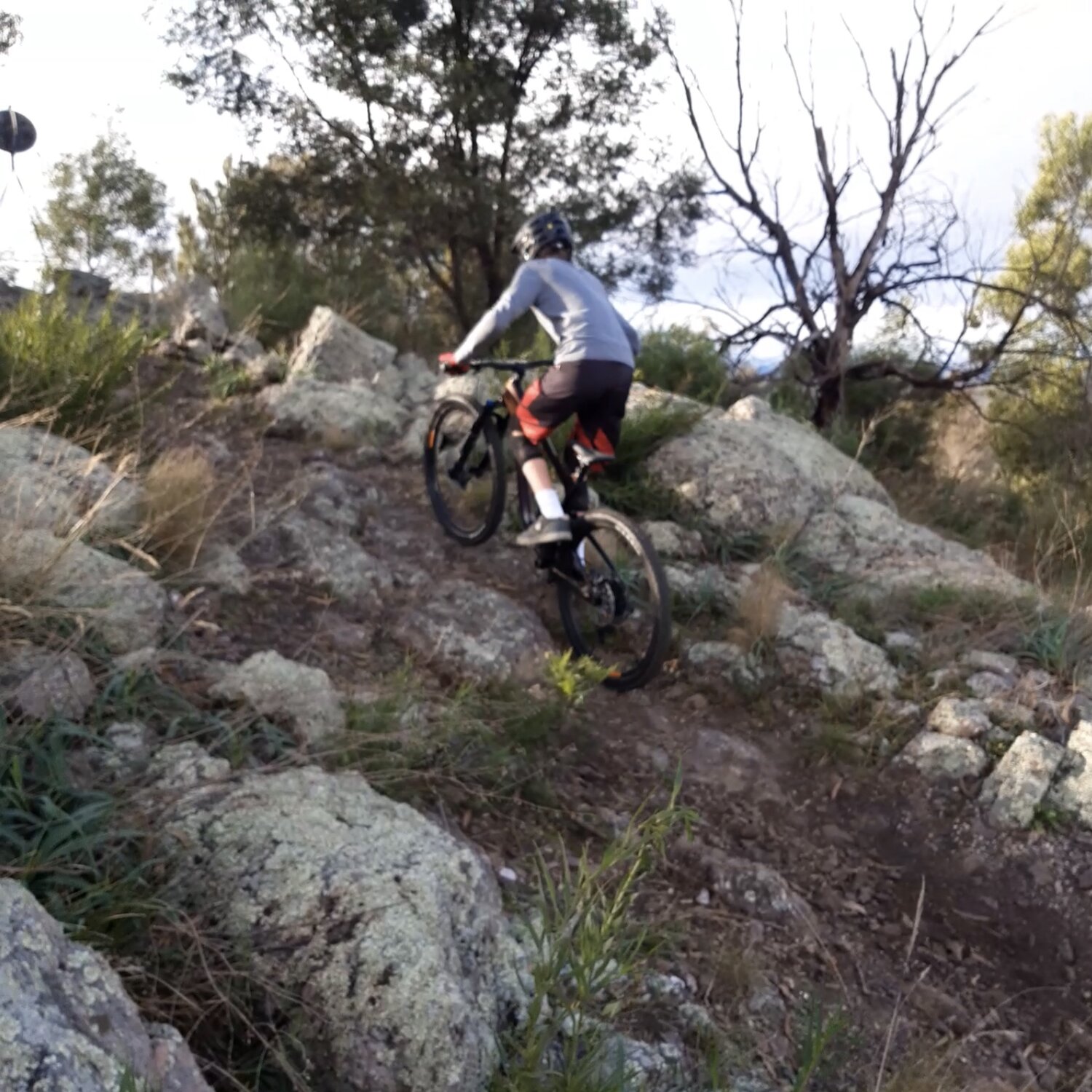

If that's what you call a blue / green, then I change my mind - buy the best top end mid drive you can find!
But for perspective, the bike is an xl giant reign enduro bike ( huge) , the rider is 6'3" tall

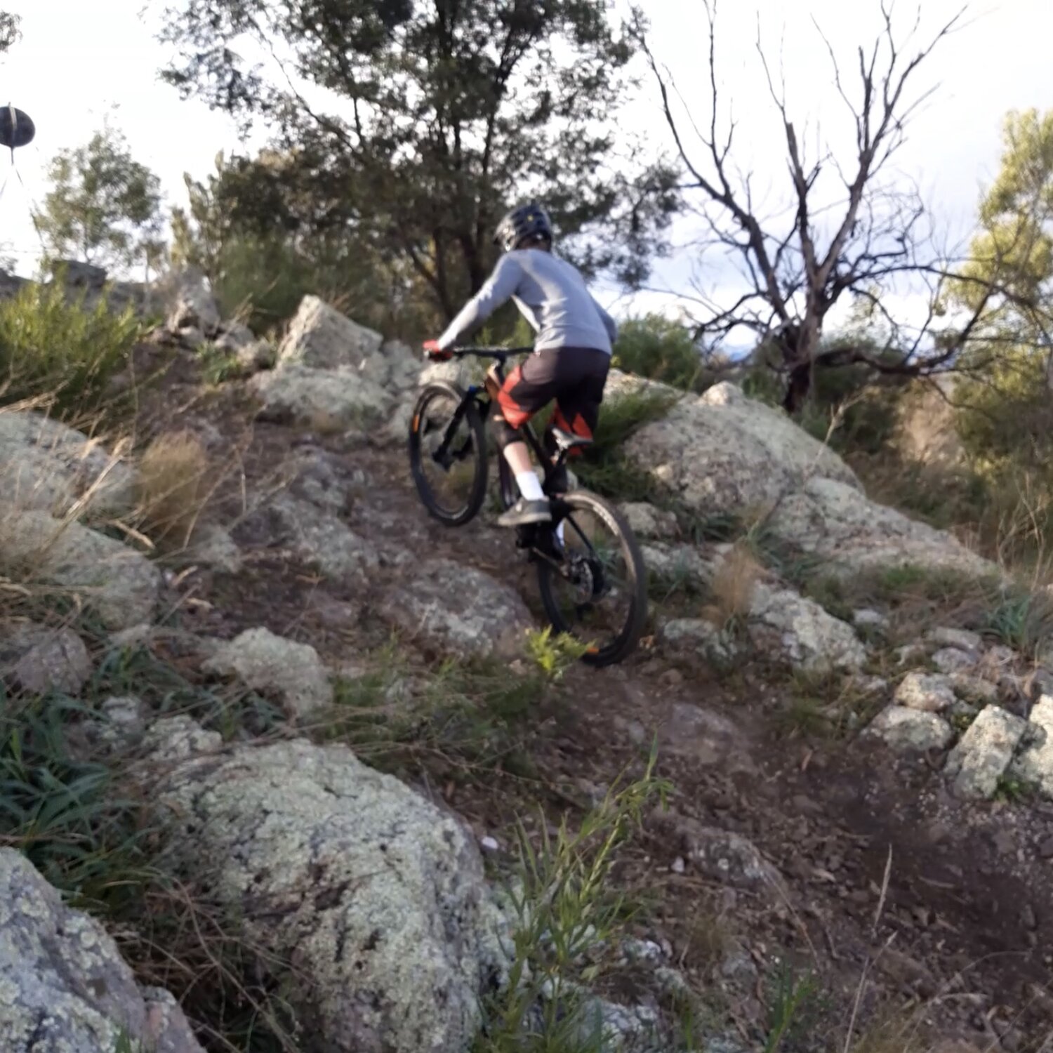

Just to make sure I understand your post and picture.. This trail in picture, with rocks like this everywhere, no problem on my trek marlin 6.. Are you saying that if I convert it to a mid drive bafang kit, it's not a good idea? If so, care to explain? Not sure why stock bike can do it but not when it's modded with bafang? .. I don't go down like a maniac obviously but I've never had issues with small/big rocks, vines and all that.. Going up or down
Honestly, if you can ride tracks like that on a hardtail you are good enough to want a big brand mid drive - you simply can't get the subtlety / normal bike feel from either a mid drive bafang bolt on kit or a hub drive. That's not meant as a criticism of those kits , but if you can ride that on a hardtail you are a better rider than 99% of the population.
The rider is the resident 'expert' stefan pushing his 'ultimate' emtb down a moderate track............
He despises Bafang, fat tires and anything related and also if he hasn't previously bought it during his mid life crisis.
Technically I'd be okay ish doing this now that I see whole picture but my fitness level would leave me huffing and puffing and possibly putting a foot down lol but I wouldn't hesitate to try and do it! Haha but that's where the électric part would help
