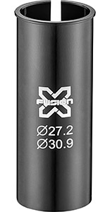

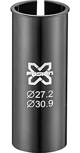

Yes, they do: X_Fusion Manic 27.2–30.9mm shim.
Slip than into your Giant's seat post to convert its internal diameter to 27.2 mm and you'll be spoiled for choice in seat posts.
… David
Thanks for that suggestion, but even with that shim MEC doesn't offer a seat post that'll fit 27.2 with an offset greater than 20mm. (I need a minimum of 25, and hopefully even more than that because 25mm would only give me an inch and I'd like two.) MEC has only two posts with greater than 20mm offset... one 25mm and the other 24, but they are both for 31.6mm diameter.
But I'll call around to bike shops to see if they have something in 27.2 with the offset I need. Thanks for pointing that shim out... it might very well be what I need.
