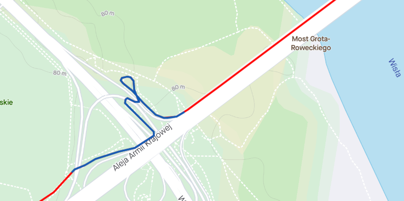

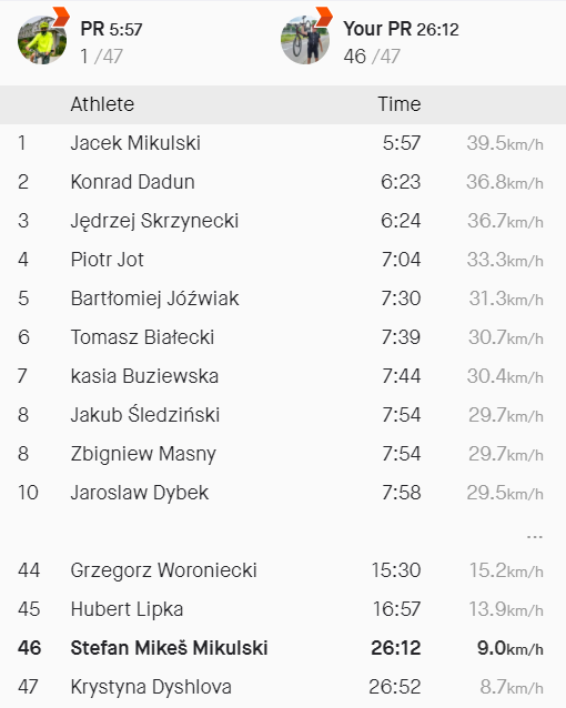

It could be of your interest: My brother Jacek rides the Giant Trance E+ in the "urbanized" version (that is, I or he added all equipment sans the rear rack and the kickstand). Of course, the Trance rides on Johnny Watts until Winter (when Ice Spiker Pro will come into action). Jacek is beating e-bike KOM records in Warsaw on a daily basis now! :D
I must have had some long rest on my ride there... :D
If Jacek wouldn't feel secure on Johnny Watts, he could not beat records on manoeuvres like this one...

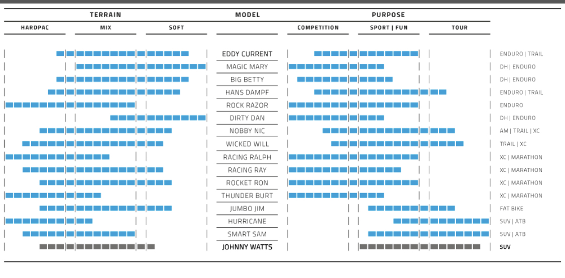

Comparison of Maxxiss Rekon off-road tyres with Smart Sams
Schwalbe Smart Sam is a brother to Johnny Watts (for different wheel size). Maxxis Rekon are less aggressive true off-road tyres.
