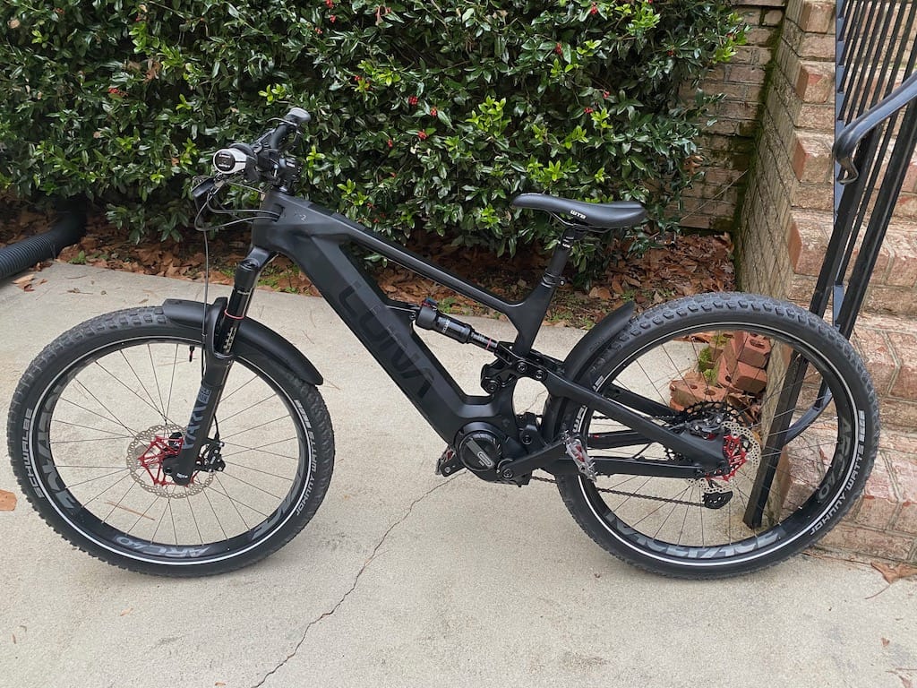

Swapped the Super Moto X's that came pre-installed for the JW's, 2.6 fr/ 2.35 r. So far so good, but only have about 30 miles mostly paved trail. It snowed last night, so it will be a little while before I'm out again! That's due to my comfort, not the tyres!!

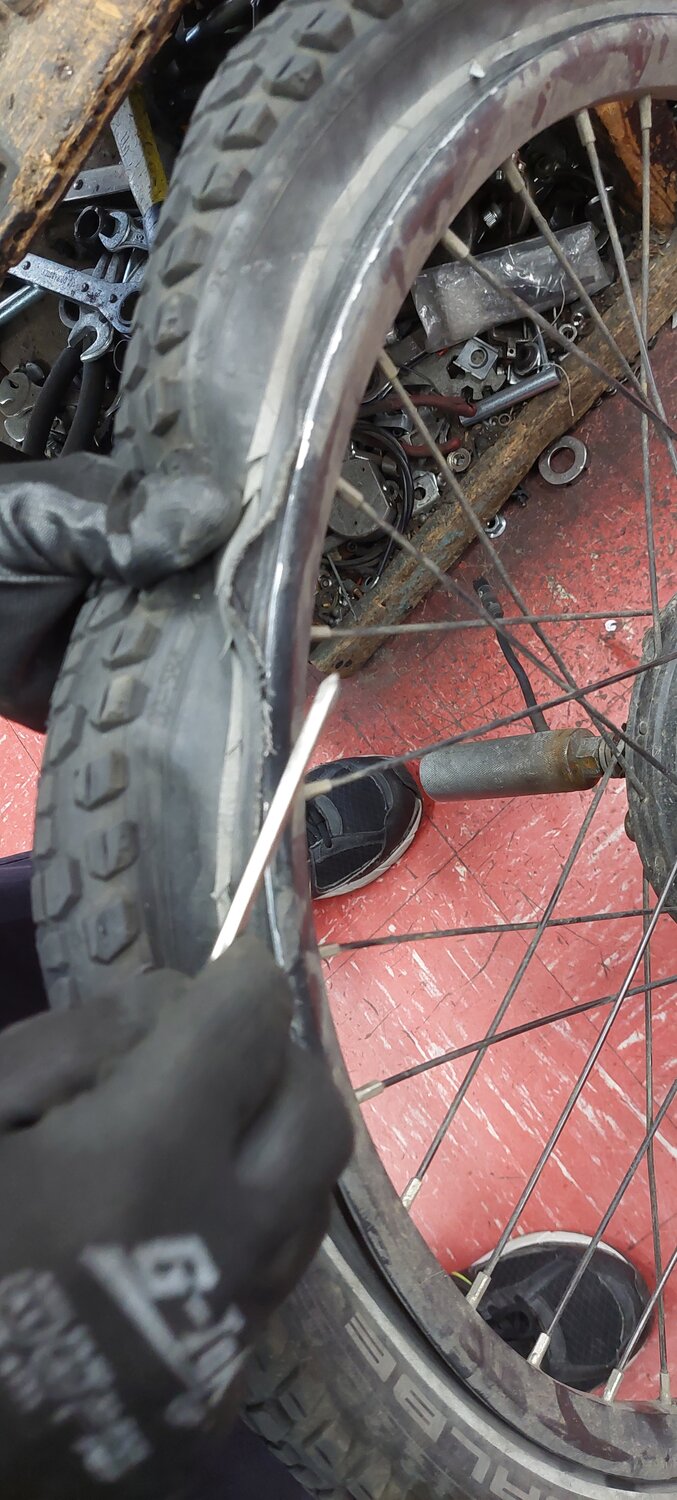

Swapping tyres on the first wheel made me weep (I actually hate installing tyres). With the second wheel, I was so much infuriated I was swearing, used raw hand power and installed the inner tube/tyre in 5 minutes, even no soapy water needed! :D True, I had a good lesson from YT and gained experience.
Stefan, can you comment on the technique you learned for installing these tires that allowed you to install second in 5 minutes? What YT videos did you find helpful?
Not Stefan, but I didn't have too rough of a time. One of the keys is using the center channel of the wheel - it's indented/got a depression in the center of it, which helps on both removal and tire installation. When breaking the existing bead, keep pushing the bead to the center and you get 'extra' room - likewise when installing, focus on getting both sides of the tire's bead onto the rim first - pushing the beads to the center so they can drop down will give a bit more working room. I think I did use a lever on one of the two but only for the last couple of inches.
Once both beads are 'inside' the wheel/rim edges, push an outer bead by hand out of the center channel and towards the wheel/rim edge, then do the best you can on the second. Add a bit of soap, and compressor, charger pump etc. will help with final seating (no valve core).
No video but - https://www.myrandomthoughts.net/ebike-mods-tubeless/
Mike, I can add one helpful piece of advice -- get some Pedro's tire levers :D Again I used tubes, but was able to swap out both tires in about 5 minutes each. It took me almost as long to wrestle the rear wheel back onto the bike LOL!
Every time you do this, you will likely get better at it.
My first tire swaps in 20+ years took forever, and now it's almost trivial at about 5 minutes a tire.
