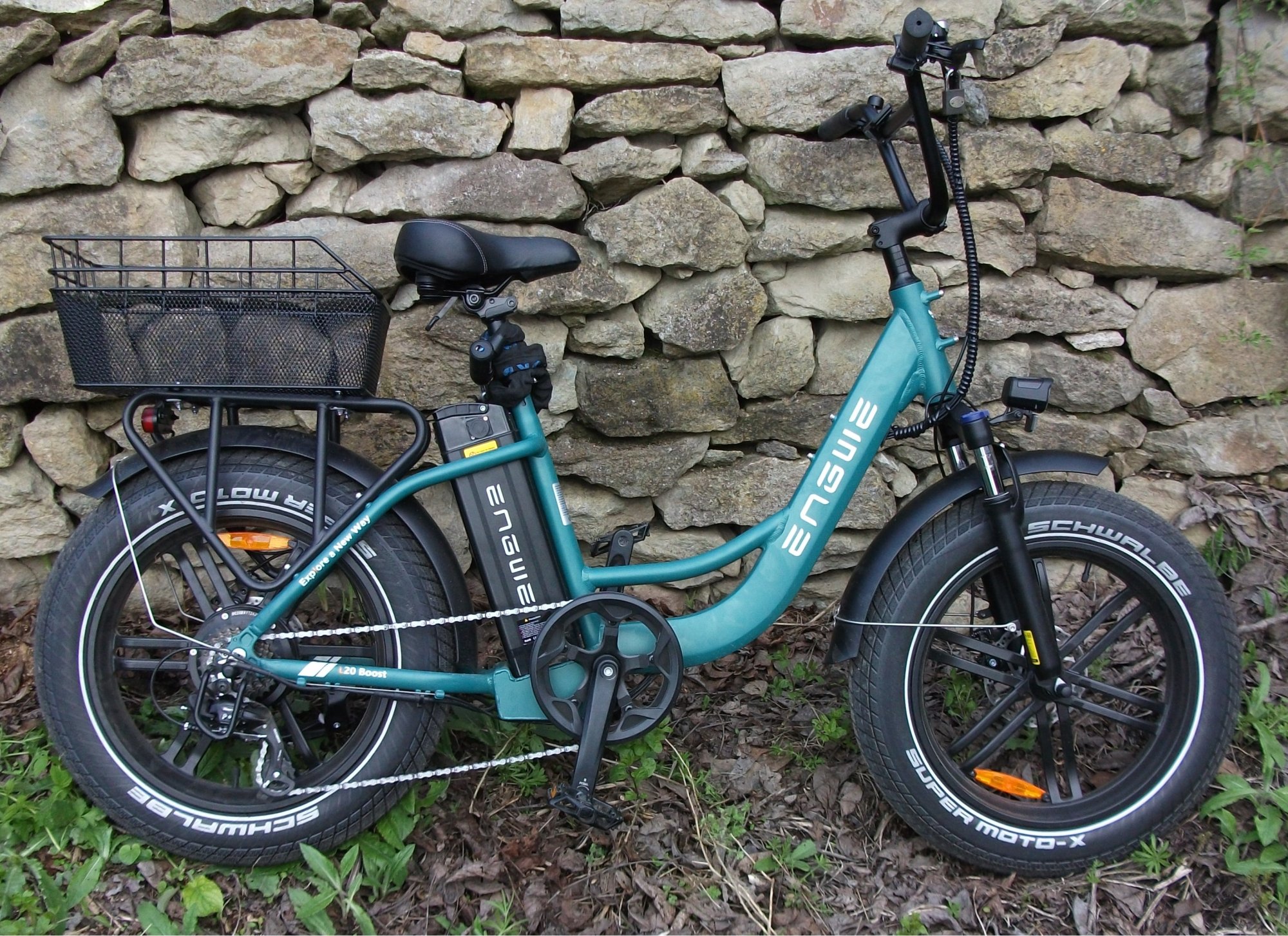

I have just upgraded the tyres on my six week old Engwe L20 Boost to Schwalbe Super Moto-X's (20''x4'') but have noticed a problem.
When I ride on a smooth road surface I feel a regular 'bump' through the saddle, seemingly emanating from the rear tyre and corresponding with each rotation of the wheel. It is most noticeable at low speeds.
I took the tyre off the wheel, inspected it and carefully re-seated it on the rim, but the problem persists.
Does anyone have any thoughts about this? I have contacted Schwalbe but have not yet received a reply. I re-used the stock inner-tubes when I changed the tyres BTW. There is no damage to the wheel rim, and the wheel spins freely.

Spinning the rear tyre doesn't show anything unexpected. The tyres have a white reflective line around the side wall, and this would accentuate any discrepancy.
The bike is almost new, so there is no damage to the rim.
When riding, it feels as if the tyre has a small area where the rubber is thicker, which contacts the road once every revolution and causes a bump, but I'm really just guessing here.
I suppose I could swap the front and rear tyres and see what happens, but I'm not looking forward to having to do that.

I've checked the seating of the beads in the rim, and the wheel is cast aluminium, so doesn't have spokes. There's nothing obviously out of round.
I'm no expert, but it's looking to me like a manufacturing problem.

Today I noticed that if I raise the rear wheel off the ground and activate walk mode so the wheel spins slowly, the tyre is not consistent all away around its circumference. I wouldn't go so far as to call it a 'bulge', but there's definitely a part of the tyre that is not completely smooth. It's easy to see this when the wheel is revolving, but almost impossible to see when the tyre is static. It looks the same as it feels, if that makes sense.
Spinning the front tyre doesn't show any such thing. Seems I bought a turkey.
