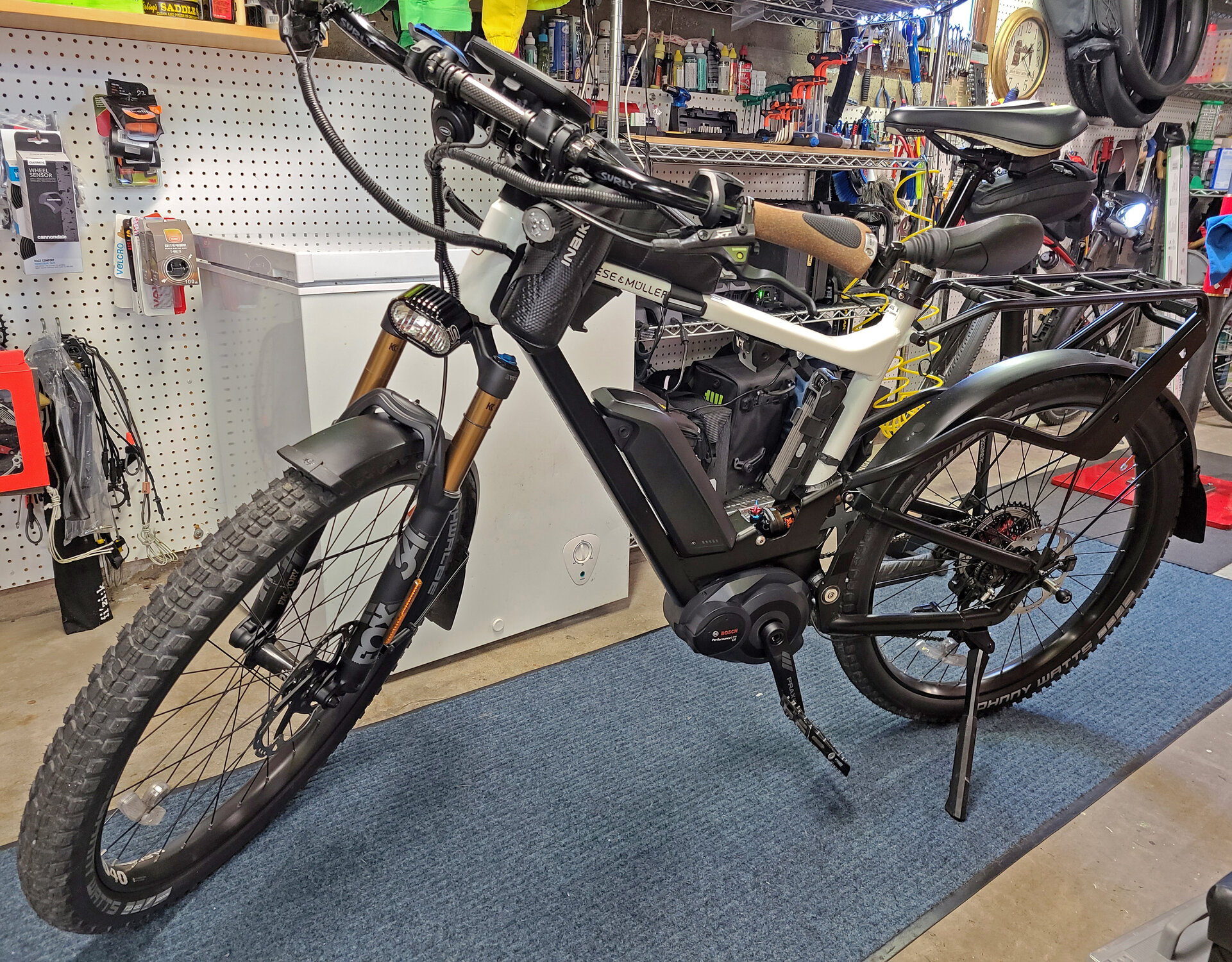

Johnny Watts on my 2018 Riese & Muller Delight Mountain 27.5 x 2.6 with SKS Blumels 75mm fenders.
They followed a pair of 2.4" Hurricanes which were whisper quiet and silky smooth on paved roads and adequate off road. Originally came with 2.8" Nobby Nicks which were noisy and dangerously slippery on wet pavement.

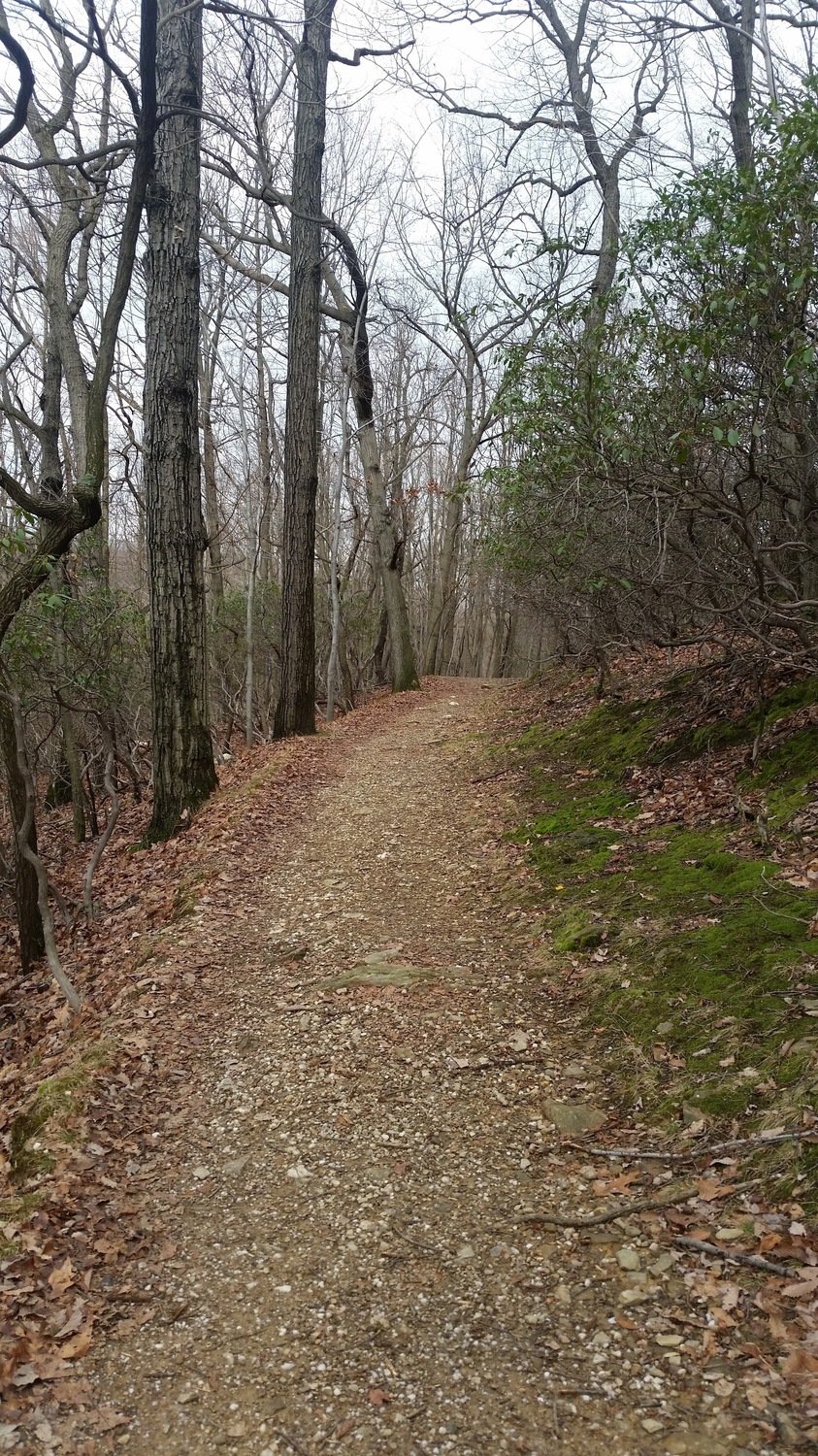

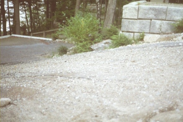

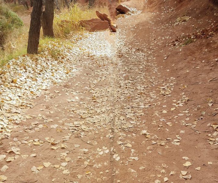

Since I don't know the English words for the specific surfaces I mainly ride on I just add a few pictures to illustrate them.
The first 2 pics is the typical Black Forest forest roads I ride often. The others are small stones mixed with sand or loose stones.
