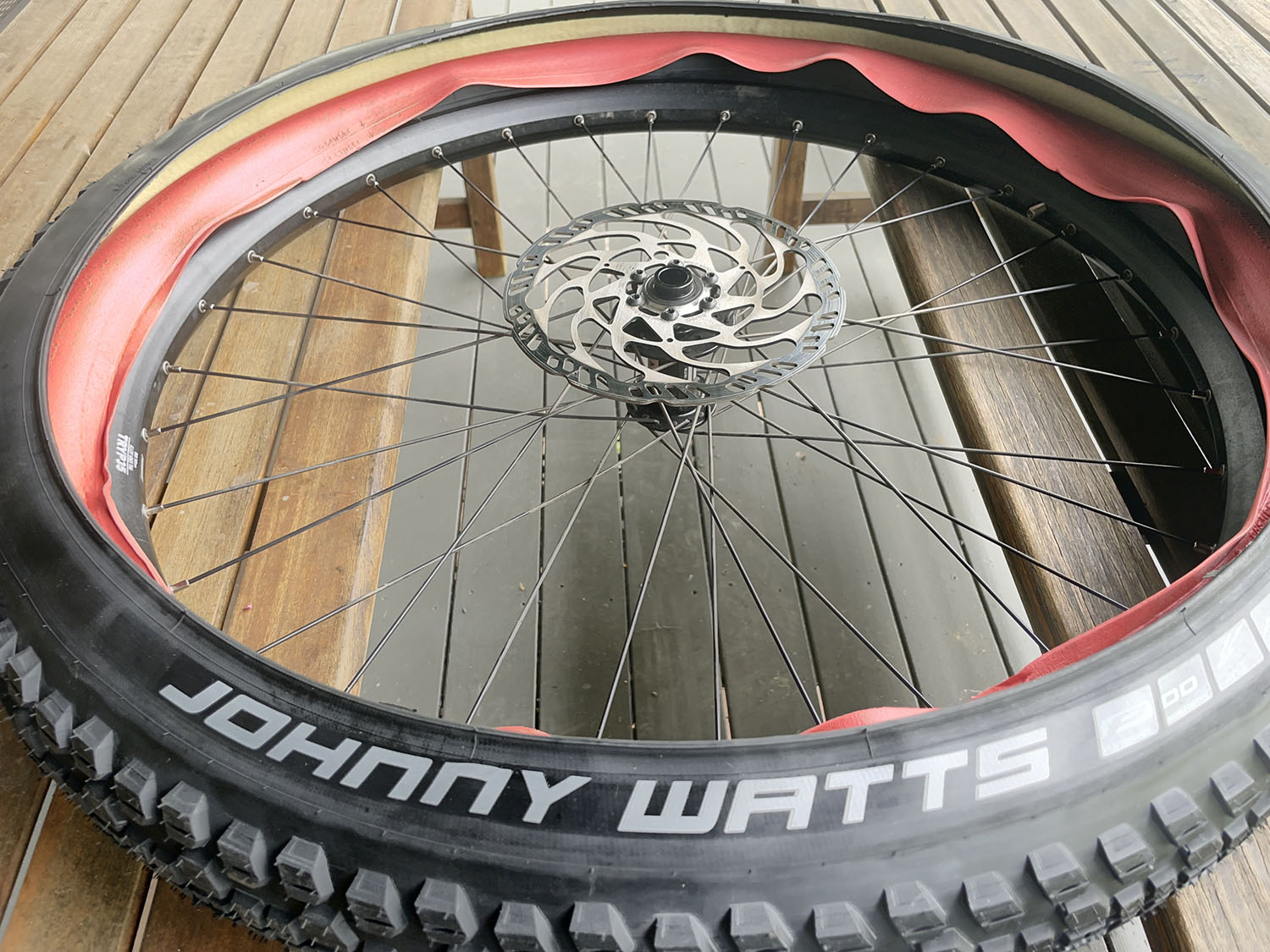

I just took delivery on a pair of Johnny Watt 27.5 x 2.8 reflex tires for my Delite Mountain that originally came with the same size Knobby Nicks. They should work well with lower pressure and Tubolito MTB tubes.
I am going to pass on the installing them with the Tannus Armour in the interest of better rolling resistance and lower rotational weight. We shall see how they hold up. Here is a photo of the bike with 27.5 x 2.6s that I am going to switch over to the Trek Allant 9.9s.
Removing the full fenders as the larger tire will not fit. I am switching back to more easily mounted and dismounted SKS Race Blades.
