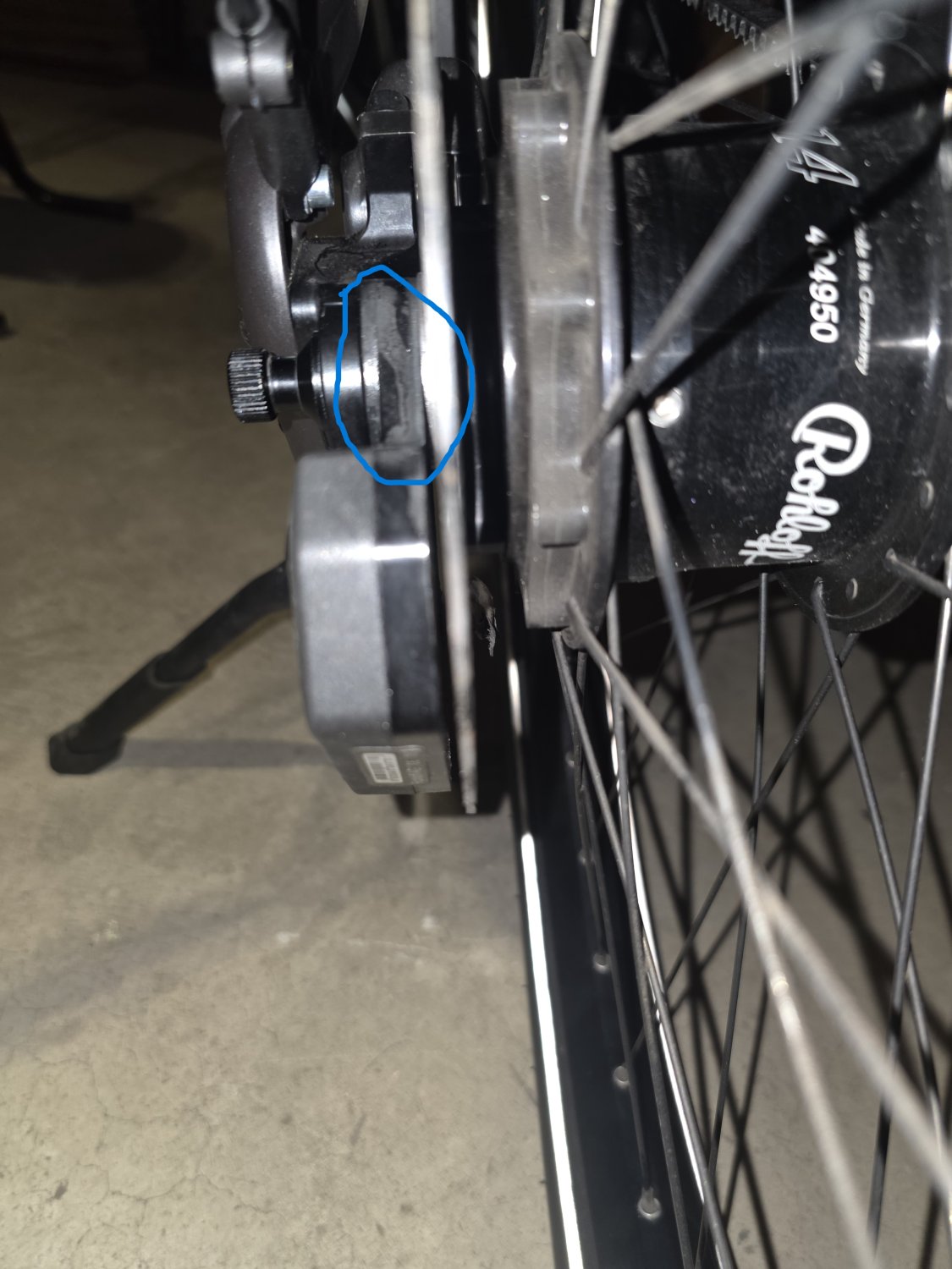

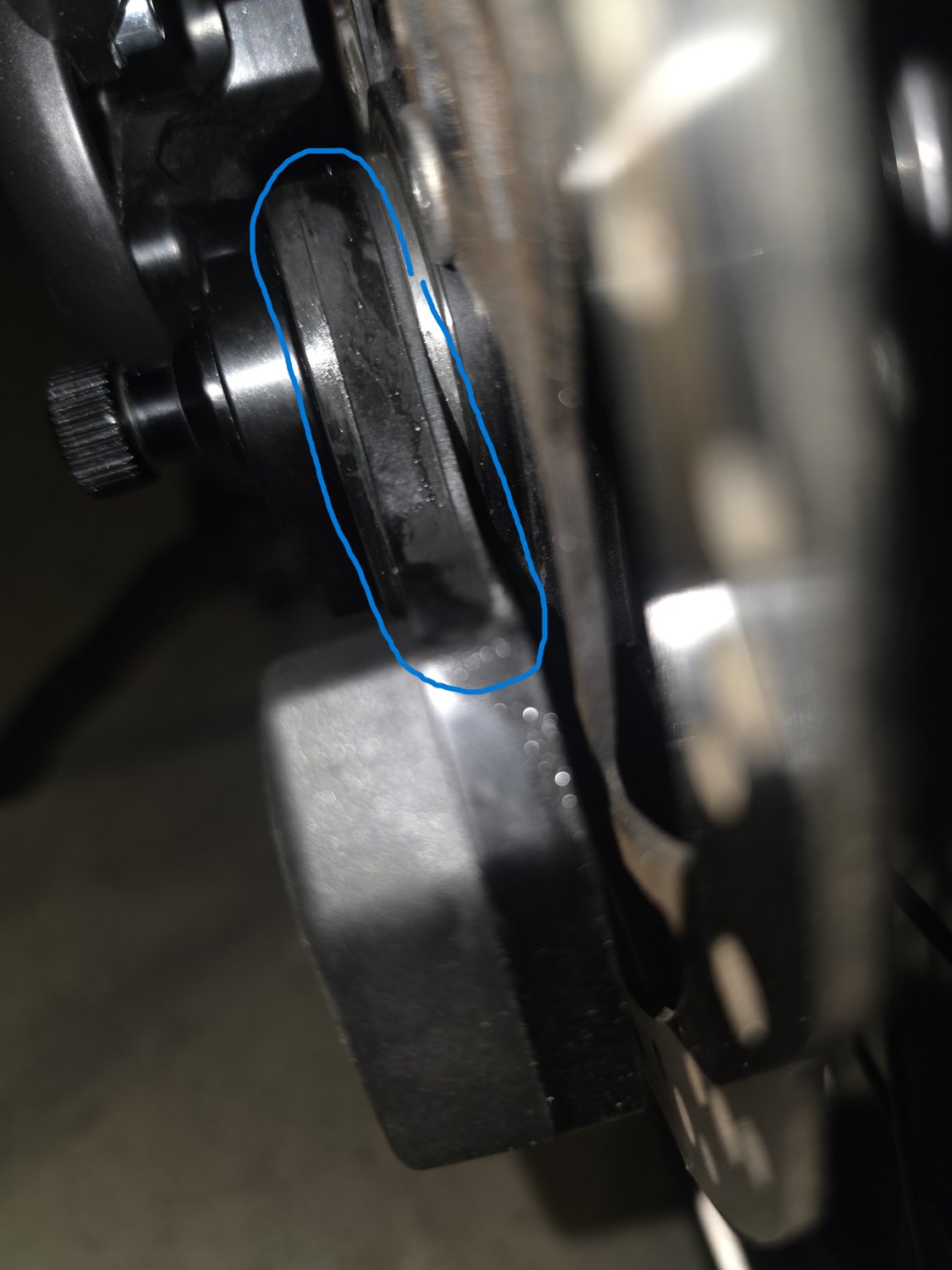

Here is what it looks like. This is what's accumulated after about 2 weeks of use

Are you sure that it's the hub leaking... The stain looks dry in the photo.
Honesty... I'd live with that.
Unless the oil leaking always looks wet, I wouldn't bother with the hassle involved.
Over 4k(purchased the bike in jun of 2024) on the hub. I changed the oil last October, so I'm going to go ahead and change it tomorrow. From the research I've been doing, this seems to be normal; I'll just have to keep an eye on it.
Yeah that's not what many complain about when talking about seal leaks. They're talking puddles on the floor.

Does your E-14 casing build up a layer of caked on grime? That's what mine does - as mentioned above it seems to be because the two E-14 sealing gaskets were never installed by R&M during the bicycle assembly.
Your E-14 looks quite clean. I definitely wouldn't be concerned if that was my bike and that was as bad as it gets.
