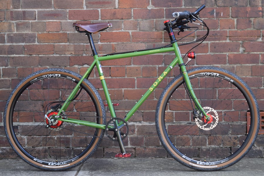

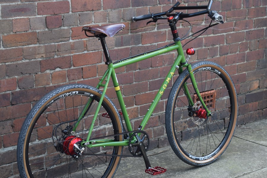

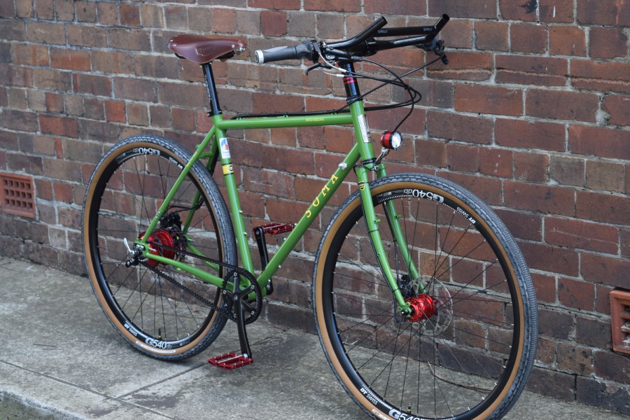

Sharing some photos of my new Rohloff powered custom build.
Fingers crossed no dreaded oil leaks! 😍😍
Nice looking build. Enjoy!

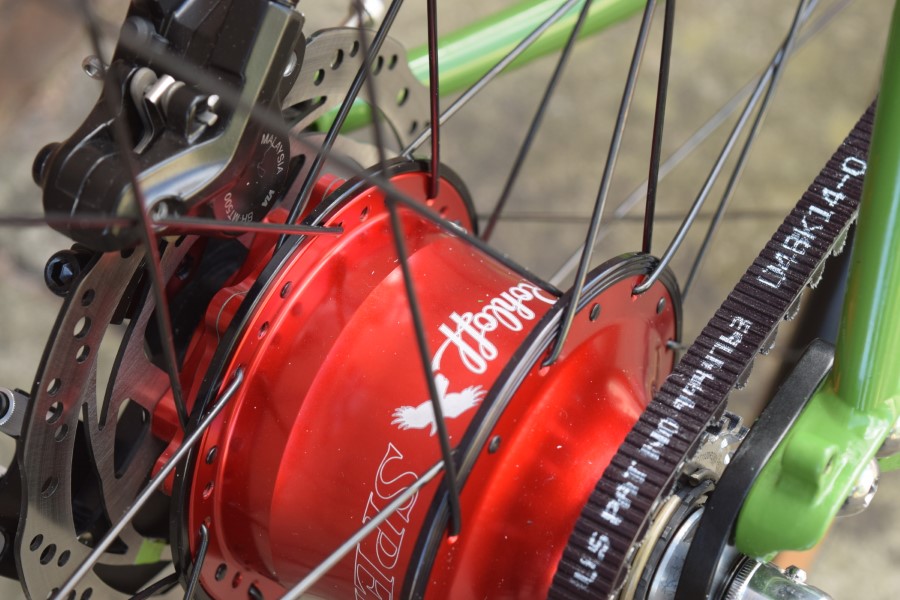

Took my standard Rohloff speed hub powered gravel bike in for servicing today after some big bikepacking adventures - the rear brake was a bit soft.
Feedback - the Rohloff has been leaking more than expected and covered the rear brake rotor, causing the softness in braking :(
Solution - ship the wheel to Wellington for servicing - gah! Hoping it's going to be covered under warranty given it's less than 12months old (I registered the Rohloff hub on the rohloff.de website when I got it thankfully) but it's still $120 shipping I have to foot the bill for at a minimum plus LBS costs.

Well the Rohloff was still working fine in my estimation, but I took it for. service because of the softeness in the rear brake - that was the trigger for the rohloff oil discovery.
Frustrating, but will see if Rohloff do the right thing by me and repair it.
Same as what happened with my E14. The RM LBS covered all associated costs, gave me a loaner bike and the Rohloff was resealed (LHS) in Wellington under warranty.
