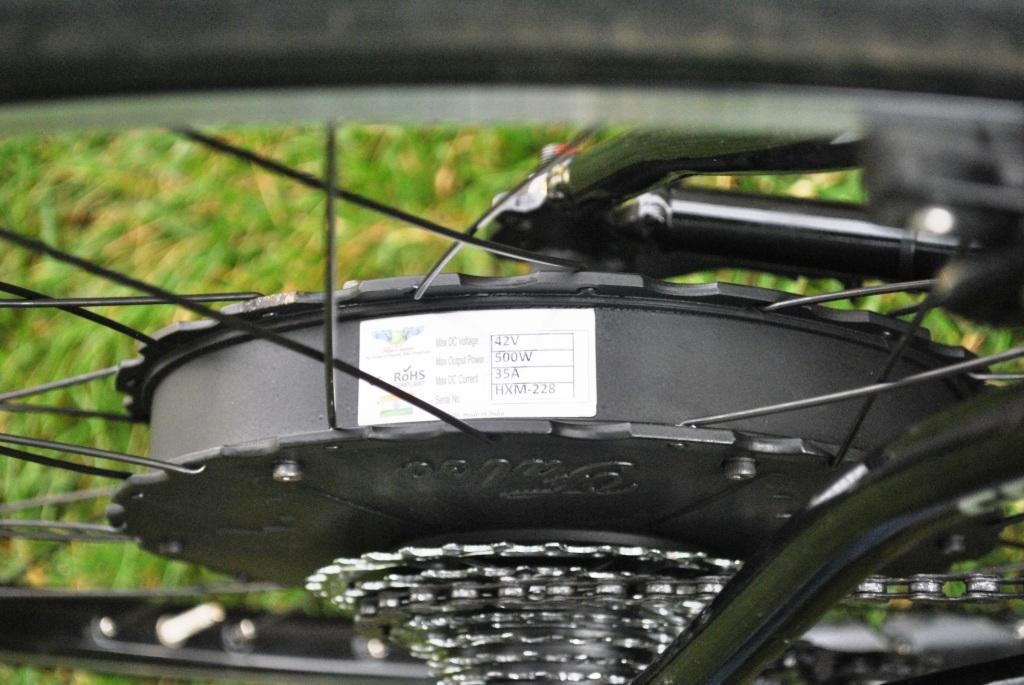

it's a 36v motor! The fully charged BATTERY will read up to 42v when fully charged. As you ride the voltage will drop until the bike stops running somewhere around 26v or so. Voltage (motors) go by factors of 6. 6v 12v 18v 24v 30v 36v = 40v fully charged, 56v is really 48v fully charged. 60v, 72v, 80v (Mowers now) are really 72v systems with a fully charged battery.
As direct drive motors are simply windings on posts, they can take a lot of voltage as long as the controller can take it. The 36v and 48v systems are the same except the battery.
So short answer,yes you can simply change the battery to 48v and you've got more power. Falco is great that way, you can use anyones battery and make the connectors match and you're ready to go.
