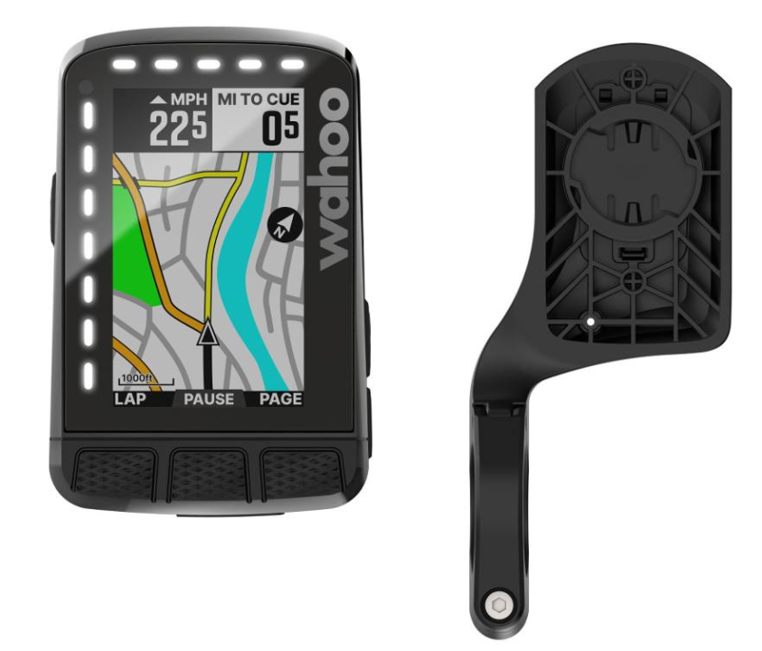

Short Comparison of ELEMNT Roam against Bolt v2
  • Bolt v2 is newer than Roam;
  • Bolt v2 is equipped with USB-C port while Roam is charged via micro-USB;
  • The screen of Bolt v2 is sharper and more colourful than the one of Roam;
  • Screens in both ELEMNT devices are of similar size;
  • Bolt v2 is missing the vertical row of LEDs (explained later);
  • Roam has very large buttons, making it easier to use by people with big hands and/or wearing thick gloves;
  • Bolt v2 allows less data fields per screen than the Roam does.

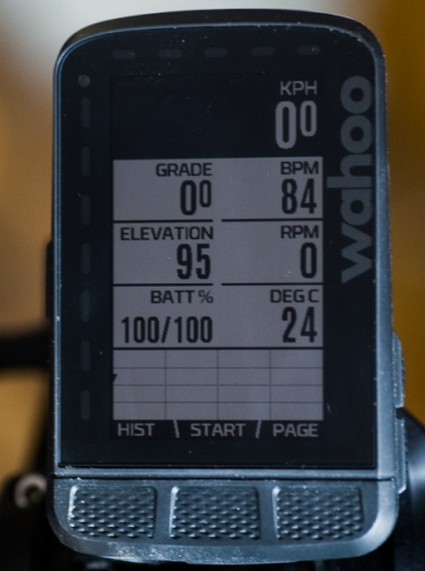

LED Discussed

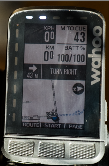

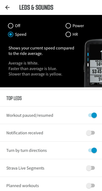

Both devices come with a horizontal top row of LEDs. The most exciting function here is indicating the expected direction turn (on a hard ride, you could be missing turn-by-turn directions; it is hard to miss the turn with the "snake" of white LEDs pointing at the turn direction). Top row LEDs will also indicate approaching a POI, tell you that you lost your way (and gladly inform you the GPS navigation has found an alternative route for you), as well as notify that you got a phone call, a text message, or an e-mail.
Only Roam is equipped with the vertical row of LEDs. That row will instruct you to ride forward through a junction, and also show you your speed or effort or heart rate against the average value (for instance: "you are now riding much faster than your current average"). That LED row is not present in Bolt v2. (For me, the importance of that row is marginal).
A screen from ELEMNT Companion App. The part with the black background is ELEMNT Roam specific. The white part is shared between Roam and Bolt v2.

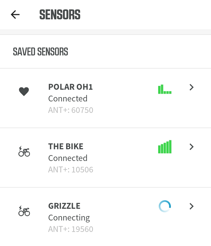

Adding E-Bike(s) and a HR monitor

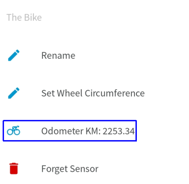

You just use the Companion App to detect Sensors when your e-bike is on and nearby:
It is vital that the connected e-bike is identified as ANT+: xxxxx. Wrongly connected e-bike would display as ANT+: ID. If the latter happens, "Forget" the sensor and connect it again.
The indication that your e-bike got properly connected is the Odometer data when you tap the connected e-bike entry in the app.
You can rename your e-bike if you like. If you own more compatible e-bikes, you can have all of them in the list (ELEMNT will connect to the one with the best signal, that is, to the one that is the nearest to the device). Note: Connecting a Heart Rate monitor is a no-brainer.

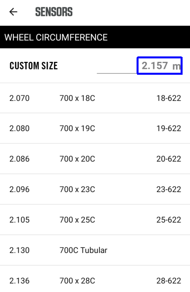

Setting Wheel Circumference
It is a vital parameter, because:
  • In a case you don't connect your e-bike as a Sensor, ELEMNT device will work solely based on its own GPS, but
  • If you connect your e-bike as a Sensor, a lot of vital information will be continuously read from your e-bike, the most important one being the rear wheel RPM. Multiplied by Wheel Circumference, that will give Speed, and multiplied by time it will give Distance. ELEMNT device connected to the e-bike becomes e-bike dependent and GPS independent with the relation to Speed and Distance.
Tapping the Set Wheel Circumference in the Companion App (with the e-bike connected) will produce this screen:
You should initially select your wheel/tyre size to get reasonable Speed/Distance values. Later, you can calibrate actual Wheel Circumference against, e.g. Strava. The screen above shows the calibrated Wheel Circumference for my 37-622 Vado SL wheels: the value of 2,157 mm gives 100% match with Strava over multiple rides.

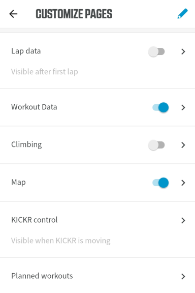

Choice of Data Pages

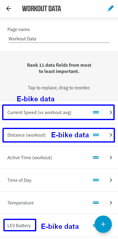

That is the easiest part, as you customize data pages conveniently on your smartphone, with each change instantly reflected on the device:
Customizing Data Pages
You only choose the pages you need. Limiting the number of pages reduces the number of "clicks" you need to do on your ELEMNT, making it very practical. For instance, I only use Workout Data and Map in the flatland, and add Climbing for hilly areas. Here's how you do it (Workout Data page):

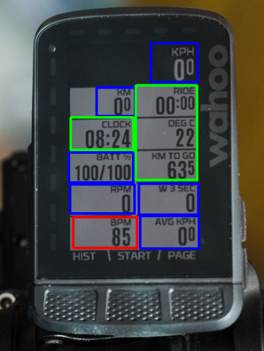

This single screen for Workout Data allows you selecting up to 11 data fields from the huge collection available for the ELEMNT. Here is how it looks on the device:
My selection: Speed, Distance, Ride Time, Time of Day, Ambient Temperature, E-Bike Battery % (main/extender), Distance Remaining (Route), Cadence, Average Rider's Power (last 3 seconds), Heart Rate, Average Speed. The blue fields originate in the e-bike, green fields come from the device, and the red field comes from HR monitor.
It is essential you do not need to see all 11 data fields. Pressing the Up button will reduce the number of data fields visible and the font size will increase for better visibility.

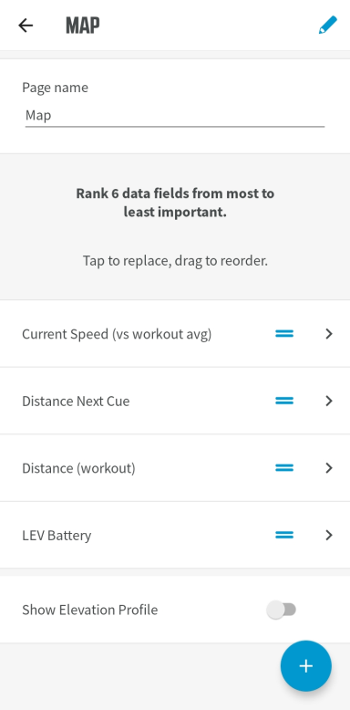

Similarly, you select fields to the Map (GPS Navigation) page.
This screen should be as little crammed as possible to leave the space for the Map and turn-by-turn directions.
It is enough to leave the Speed and Distance to Next Cue fields here. I added Distance Ridden and Batteries % fields as I tend to stay in that page for long hours during my rides.

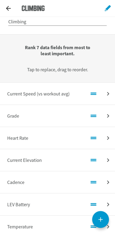

Should you ride in a hilly area, the Climbing data page comes handy:
And that's how it looks like:
It seems to me that this implies that the tire circumference can be set using the Companion App. I thought that tire size could only be set by a Specialized dealer using their special tool connected to the bike computer. Or does this only work for earlier computers, and will not work with my TCD-W?
There are two separate things:
  • The wheel circumference value as internally set in the e-bike. That affects the speedometer, odometer, and daily trip meter on your Tero.
  • The wheel circumference as set through ELEMNT Companion App and stored in a Wahoo bike computer.

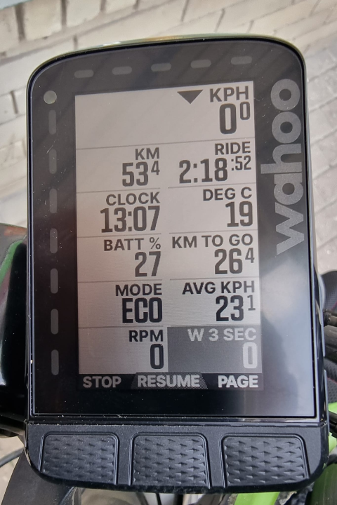

The Workout data page configured for my needs. The Power (W 3s) field is colour-coded for different effort zones according to your FTP.
