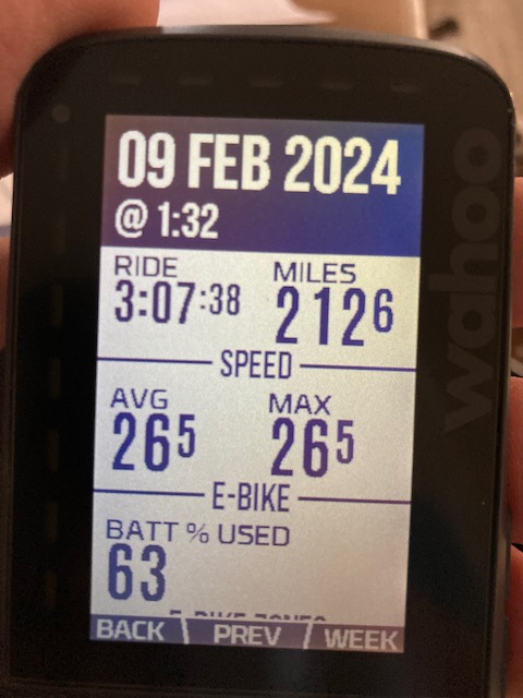

This problem seems to have been around for a while. Here it is Feb 2024.... I just submitted this as a Wahoo ticket.
I have been using my Roam 2 on my new Specialized Tero 5. I paired the Roam to the Ant+ of the Tero to take advantage of the built-in cadence sensor. For several rides, everything worked just fine. I did not expect to see so many fields from the Tero controller shown on the Roam. Not a problem, just a surprise. In preparing for a ride yesterday, I noted the Roam had an update which I installed successfully. During the ride, I followed a 35-mile route on the map page. Distances, remaining, to the next cue, and ridden, were all looking normal. When I finished the ride, I shut everything down as normal without concern. I have the Roam set up to upload automatically to Strava. A couple of hours later, people were commenting on the goofy numbers showing in Strava. My 35-mile ride was showing as 210+ miles and an average speed of 60 mph. I was able to edit distance in Strava and it recalculated everything. However, every other app involved is messed up with the bad distance numbers.
