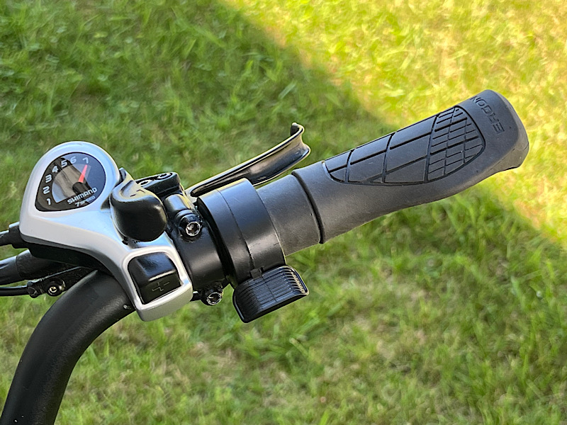

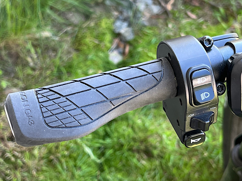

I've travelled over 1000 miles on the original Eahora Juliet. The updated 2024 model is out that changes some things, so I'll not go into too many fine details as they have already changed. They also have the Juliet II and Juliet III bikes as well. So a bit confusing to have 3 different bikes named Juliet.
Overall this bike was a great value. Currently the latest model is $1,199 +$200 shipping which really is a a surprising deal. Overall I've been very happy with this bike for use as a commuter or traveling mostly by road, extremely long distances for an e-bike. I did have to switch up the handlebar stem and added a suspension seat-post to get a comfortable fit for me.
The bike has held up very well for the most part; I've had to adjust the rear derailleur once, but I may need to do it again at some point as I didn't use loctite on the limit screw. It was the easiest adjustment just needed to tweak the high-limit, indexing has remained solid. Another issue is my motor cutoffs connected to the brakes are no reliable, i've not looked into the connection issue there yet. The tires probably need replacement now, although they were never great for traction.
The tires are not very good on wet streets or in the mud, and generally the geometry, dual crown fork, and suspension are just not suited for any serious off-road trail. Clear well traveled trails and pathways are fine.
I only bought it for the battery and range, and while I needed to tweak the fit I've been impressed even though it uses a lot of lower grade components. If you only need a simple long range e-bike for commuting and/or errands it's hard to beat.
Pros
Cons
There are other small things like the funky operation of the cruise control and indicator that only indicates that it is available, not whether it is active or not. The display is workable, but can have issues in bright sun with visibility, in the rain with water damage, and generally physical damage. I could not configure the throttle to not be limited by the assist mode, I didn't waste time trying to update the firmware which may have fixed that.
I do recommend this model for those that don't have a very long inseam or never plan on pedaling. Check the reach, you may need to adjust for a comfortable upright riding position. If you know what you are getting, this is really a great bike due to it's huge battery and utility with the rack. Compared to my other main e-bike, the Juiced RipCurrent S, it just does not ride anywhere near as smooth, or feel as good to ride. The Juliette is great little utility commuter, but not really meant for the bike enthusiast or regular rider. It did exceed my expectations in many ways, but missed the mark a few times as well. I use it a lot when I needed more utility function due to weather or terrain, and I bet the updated model is even better. I'll look at purchasing another Eahore bike in the future if the price is right, and I don't have a similar battery capacity on another bike by then.
